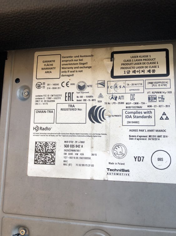

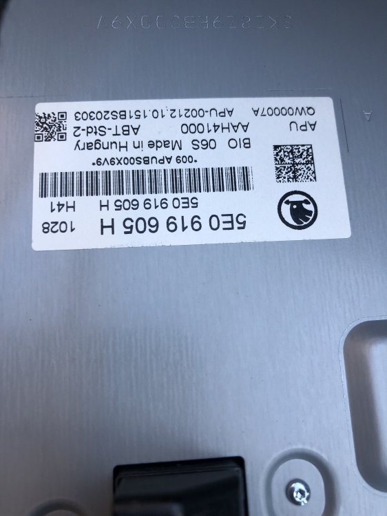

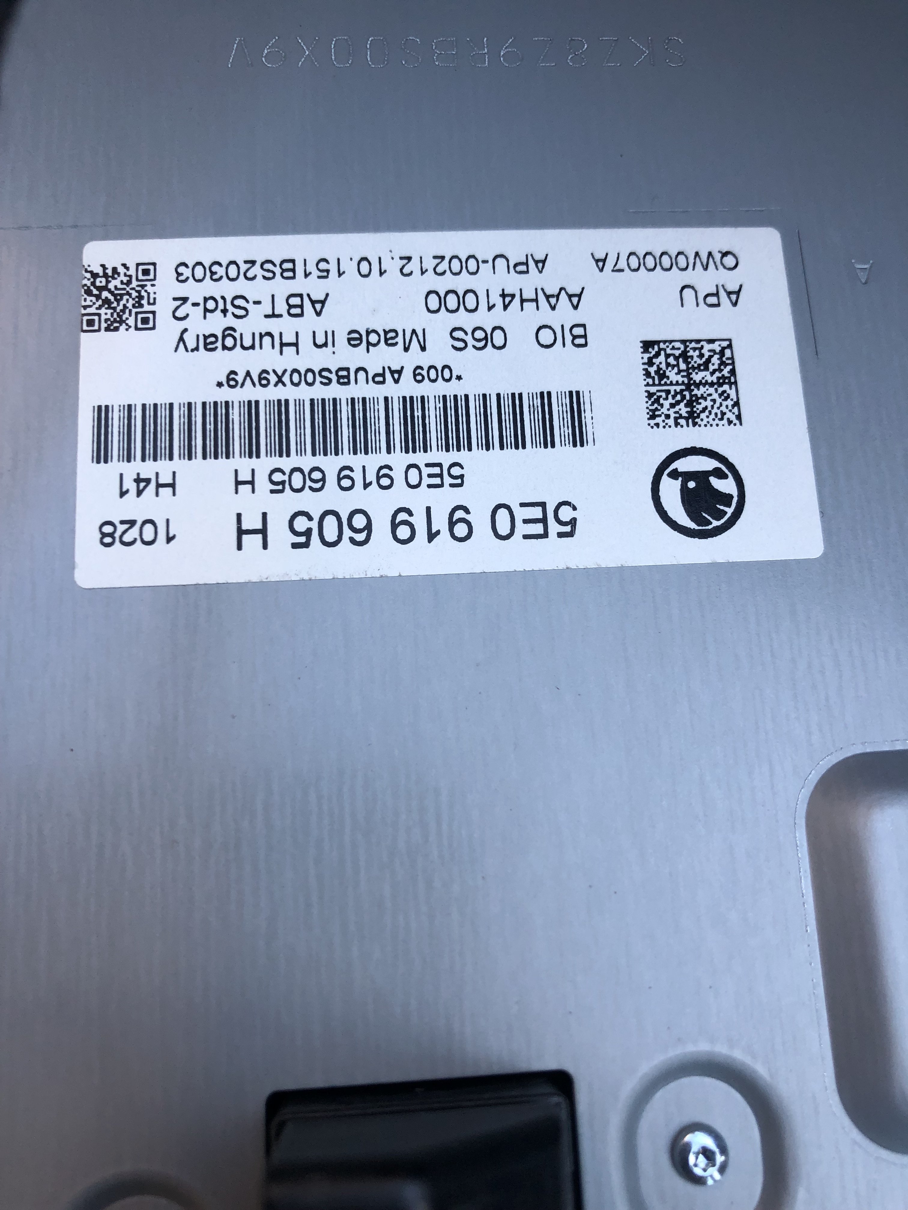

  5. He never said anything about a fuse. Do you know if there is a fuse there ?
  6. Hi Thanks for your reply Yes the screen is completely blank no noise or anything. It was working fine at the end of the day and the next morning nothing. Electrician says that there is power to the screen. They quoted me £1000 to £1200 for pioneer aftermarket system, but I can get 2nd hand head unit and screen for under £100. Not sure if I should just try replacing the screen first then if needed the head unit.
  7. Good afternoon all I have 2015 Octavia VRS 2.0l diesel hatchback. When I parked up one night, everything was working fine. Went to it the next morning and the touchscreen would not turn on. I have checked the fuses and they are fine. Took it to an electrician who says that there is power going to it and that it could be the unit in the glovebox. Tbh I’m a bit stumped. Mine does not have sat nav but does anyone know if I can replace with one with sat nav and will I need to change both the unit and touchscreen? Or is there a way of checking both the unit and touchscreen before I look into replacing them both? Below are pictures of the labels from both units. I can source the identical touchscreen but struggling to find a unit with the same model number, mine starts with 5Q0 I can source one that starts with 5E0 Not sure if I’m looking at the correct numbers on both units Any advice would be much appreciated Many thanks
