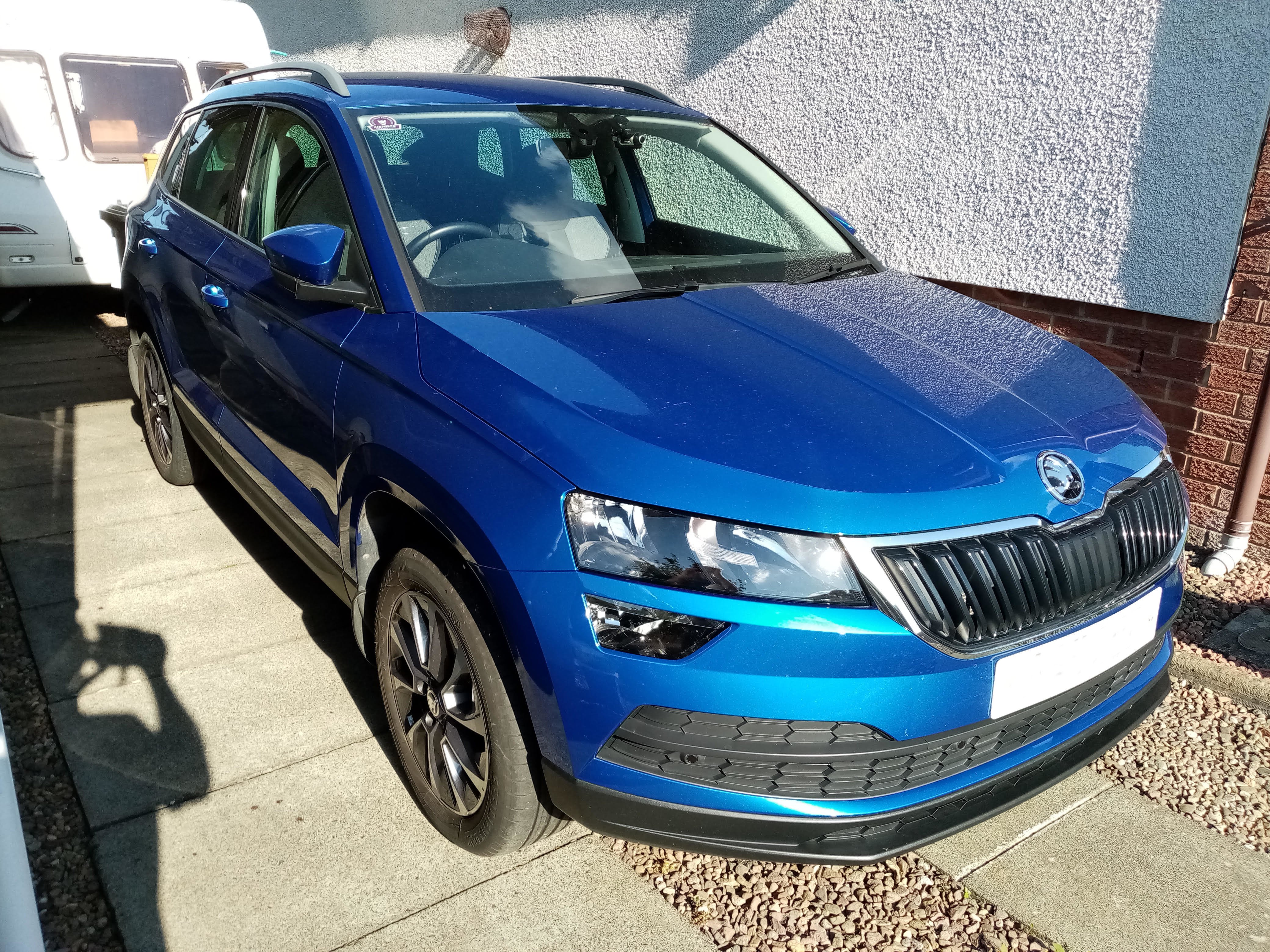

    Hello, just a quick introduction. My name is Dacob and my car is a 2020 Skoda Karoq 2 litre diesel. I have had the car since new, use it daily and also tow my 1200kg Swift caravan with it. I have been very happy with the car and its performance and find sufficient power and stability when towing.
