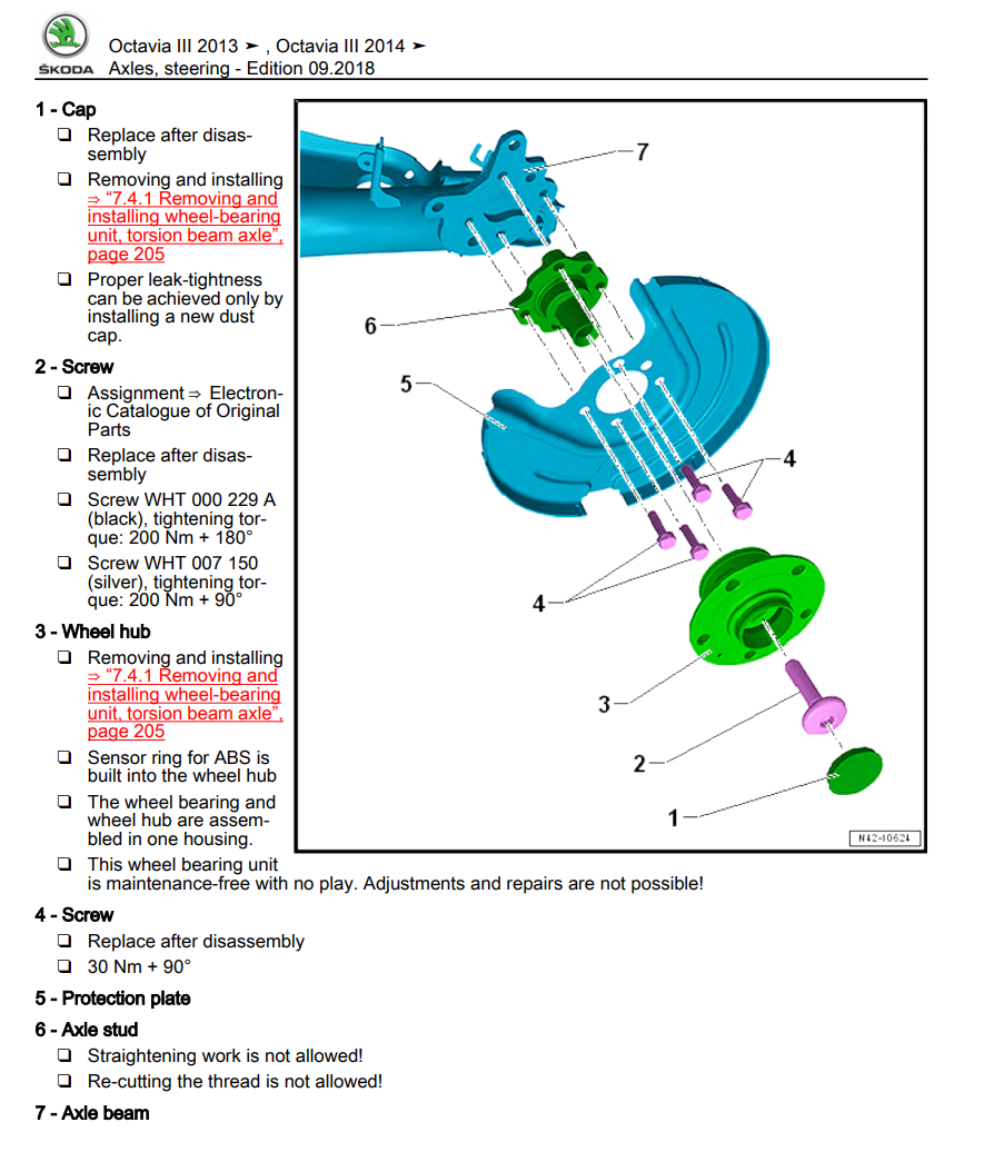

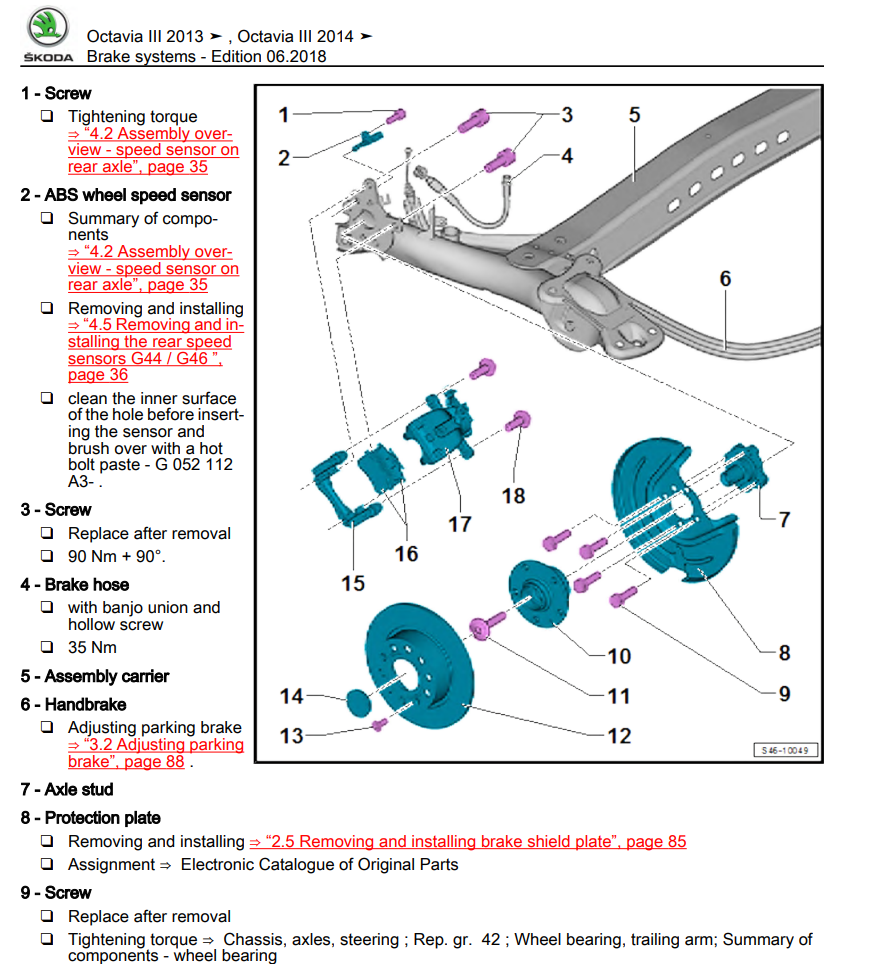

  3. Hello, I was hoping someone in here might know which kind of screws (no. 4 on the first picture, no. 9 on the second picture) for the dust shield i need? Considering it says replace after removal i would like to buy new screws. And i think this is the right configuration, the PR code for my brakes are 1KD. Which should be C38 - 15" brakes, so i believe this is the correct setup (second picture). Thank you in advance for any help! 🙏
