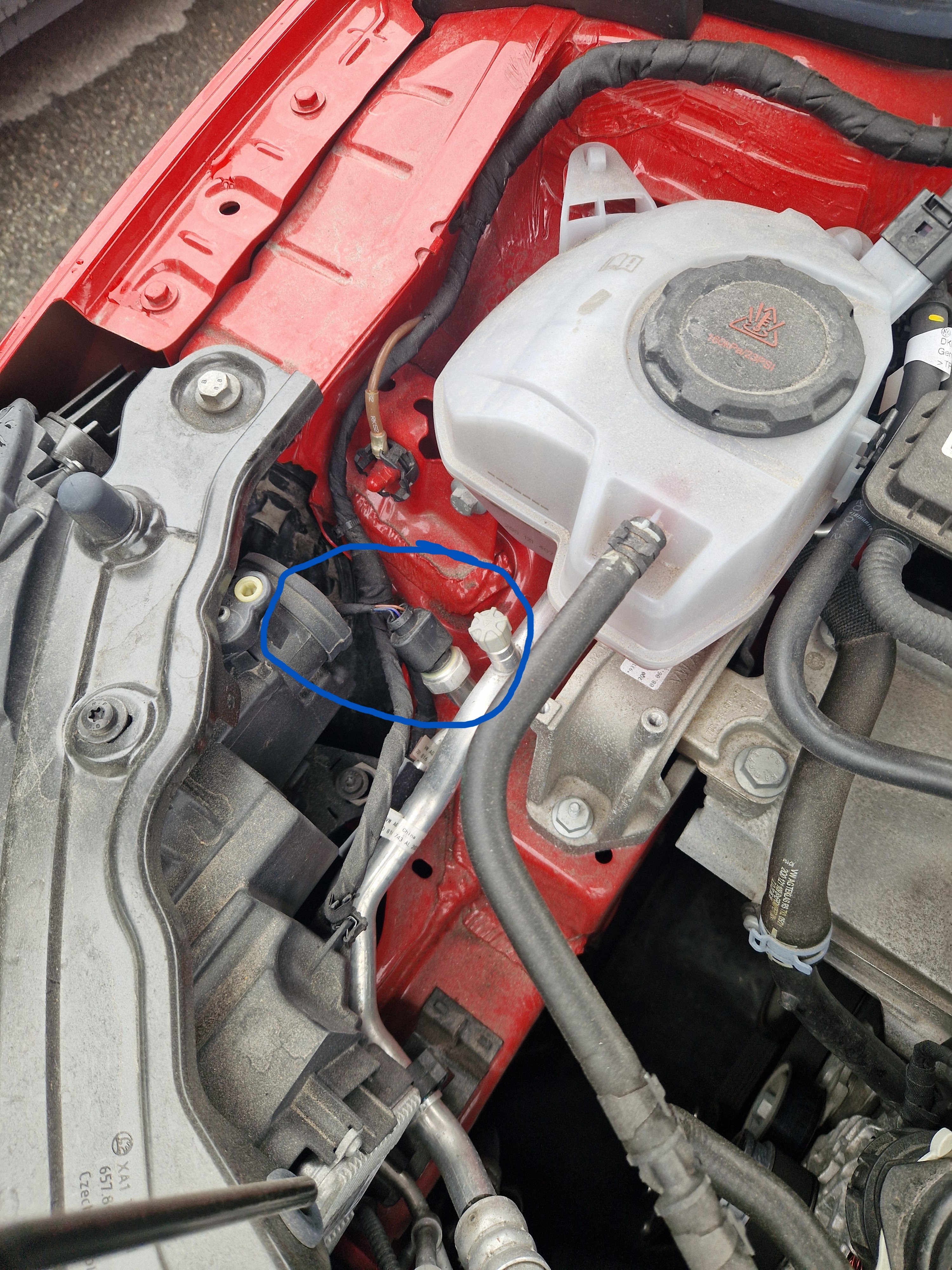

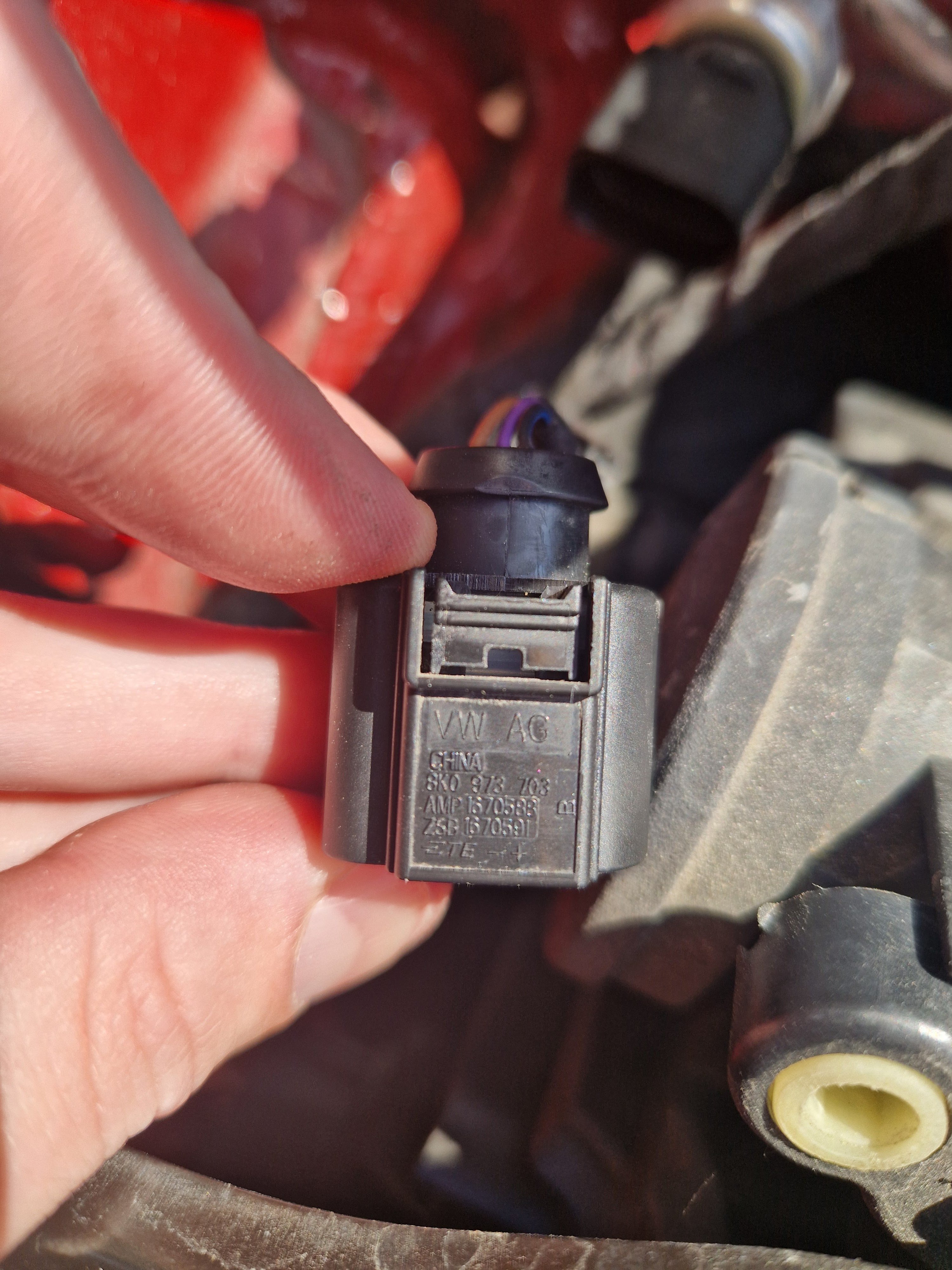

  1. Some closure for anyone who read this thread and wonder what the problem was. I took the car to a mechanic and it turns out the LIN wire had been damaged somehow and ultimately broke off (see pic). No other cable was damaged and neither was the harness sleeve, so I guess the wire was damaged from the factory (but not enough to completely loose the connection) and then after a couple of years of vibrations and temperature cycles it came off. So most likely bad QC at Skoda unfortunately. Not sure how I could measure activity on the LIN bus leading up to this, maybe the wire got a connection when I was holding it up and didnt tear off completely until the mechanic opened up the harness. Anyhow, the AC is back up and running and my wallet is a tad thinner.

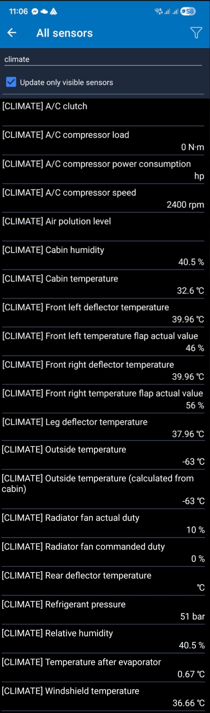

  4. Here's a thread bump with more recent info. Does anyone recognize this behaviour? Short recap: AC was every now and then not blowing any cold air. The next day however, it would be just fine. Now, 9-ish months later, the AC never blows cold air at all anymore. First, I had a look under bonnet and saw that the fan wasnt spinning and the compressor clutch didnt seem to be engaged. Then I connected an OBD2 device, and Interestingly enough, I now get an error code: 262658 B10AE31 High Pressure Sender, No Signal. Turns out the pressure sender is very accessible, so I began troubleshooting: I disconnected the sensor connector and looked for damage or oxidation, but it looked fine to me. I then measured the voltage to be 14.5V, with continuity between GND and chassis. Sensor should be 12V but I guess 14.5V is expected with the car running. Also, the LIN bus fluctuated between 6-10V ish, which I guess means traffic is going on as it should. A next step could be connecting a logic analyzer to see if the traffic is correct, but Im not sure that I could find out what the traffic on this LIN bus should actually be like. OBD reading constantly says 51 bar, which is of course not reasonable at all and is probably a value shown when no real value is available. Interestingly, the "outside temperature" value seems to behave in a similar way and shows -61C, however the dashboard reading of the outside temperature is fine. Anyway, I figured that the sensor had simply given up and ordered a new one (NRF 38949) from autodoc. After installing it (and hearing a short and distinct "pfff" when unscrewing the old one) and clearing the error code however, nothing changed. Same error code, same behaviour. I will now bite the bullet and take the car to the shop, but I fear that they will also not find the problem and instead start replacing expensive stuff that might not need replacing, so Im just throwing this post out there to see if someone recognize this and have some idea. Cheers!
