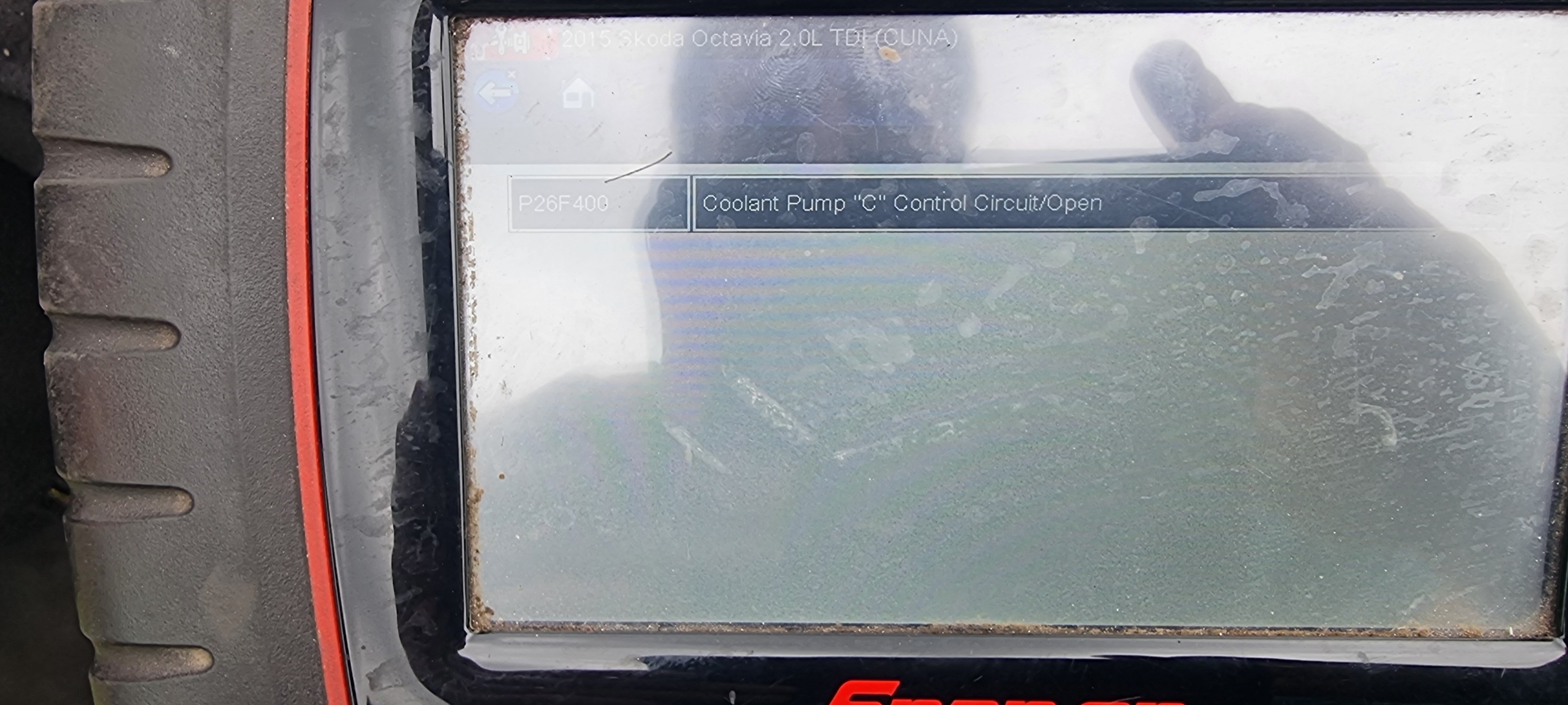

  4. Hi so as I mentioned above I wasnt worried, with good reason firstly amber light isn't an "nct" failure. It was an intermittent cooler pump failure. 1 of 3 pumps on the coolant loop. Alot of scare mongering ive noticed . Anyway I just wanted to update the Skoda group on my intermittent failure fault.
  5. Hi folks 149km Vrs diesel 2015 engine management lightjust came on. This is my second vrs. Just sold first with 200 miles going like a storm. Its a constant amber light that's on. I'm not too worried but what are the groups thoughts. Also what oil is everyone using at the minute?
