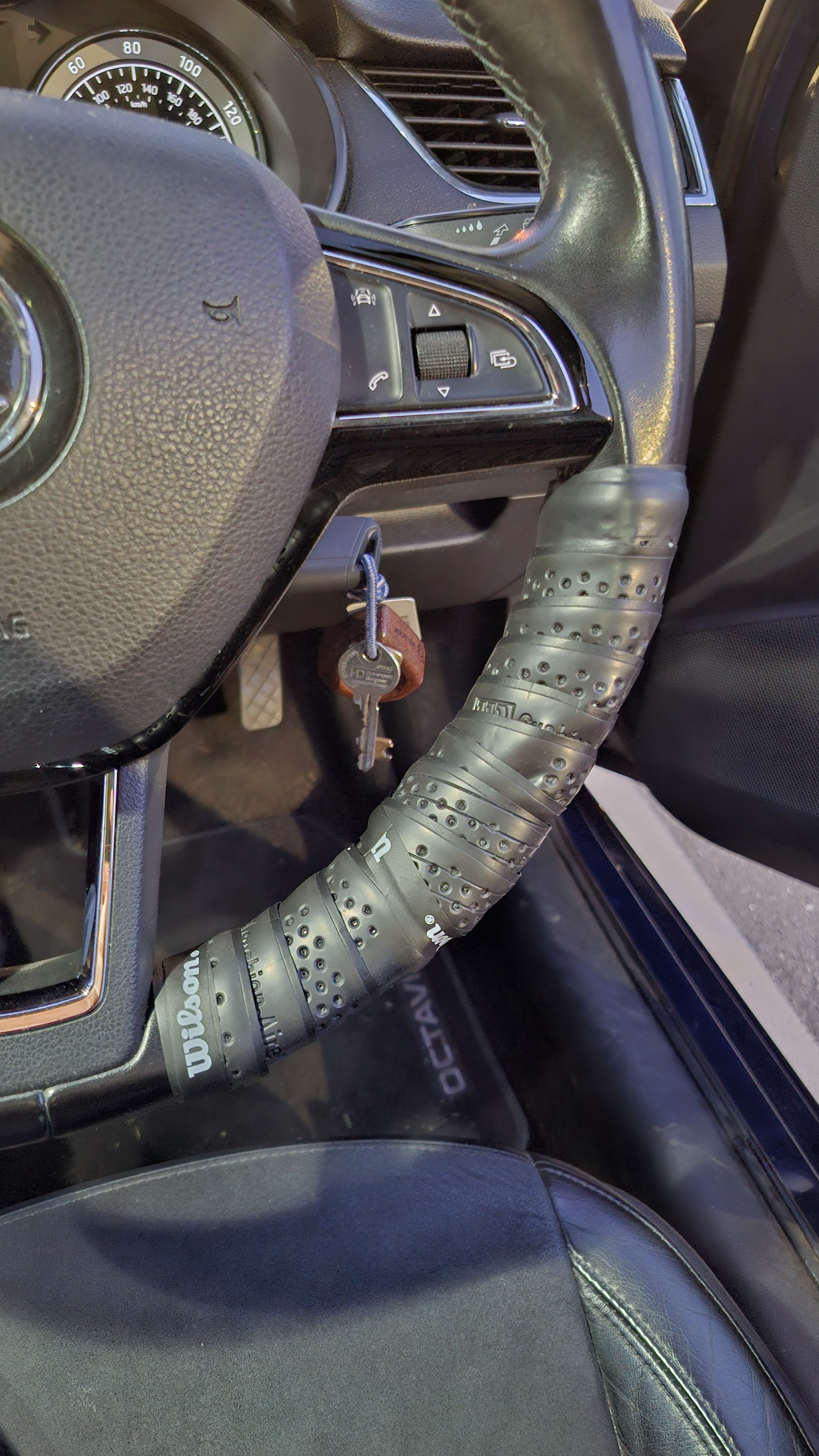

  1. I know you're all dying to hear how this is progressing... Garage looked at the drive shaft, nothing visibly wrong as expected . I test drove 2 1.4 TSI octavias today and they also have the same sort of vibration. I think it's just engines... I'm not going to replace the drive shafts as its almost certainly not that. I've mostly fixed the problem with some £5 Wilson vibration absorption tennis handle tape, placed on the "driving for 5 hours down the M6" position of the steering wheel. I realised my last car may have felt smoother as the whole wheel was wrapped in the stuff as the plastic in the wheel had perished. Does the mk3 octavia have a steering wheel vibration dampner? If it does i might swap it out as it just might be worn, or maybe fit an aftermarket one?
