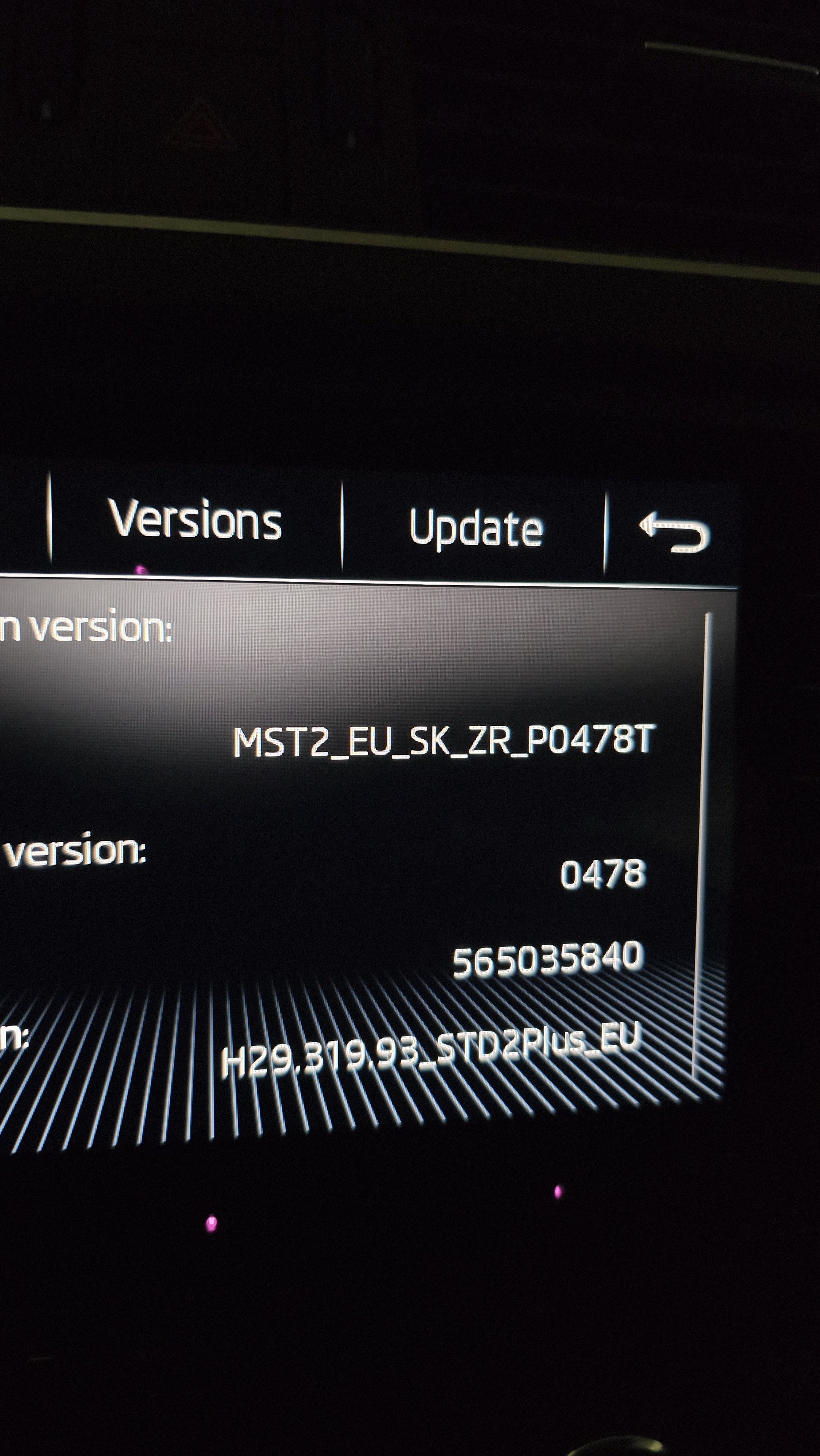

  2. Hello , I updated from 0478T. Does it make any difference?
