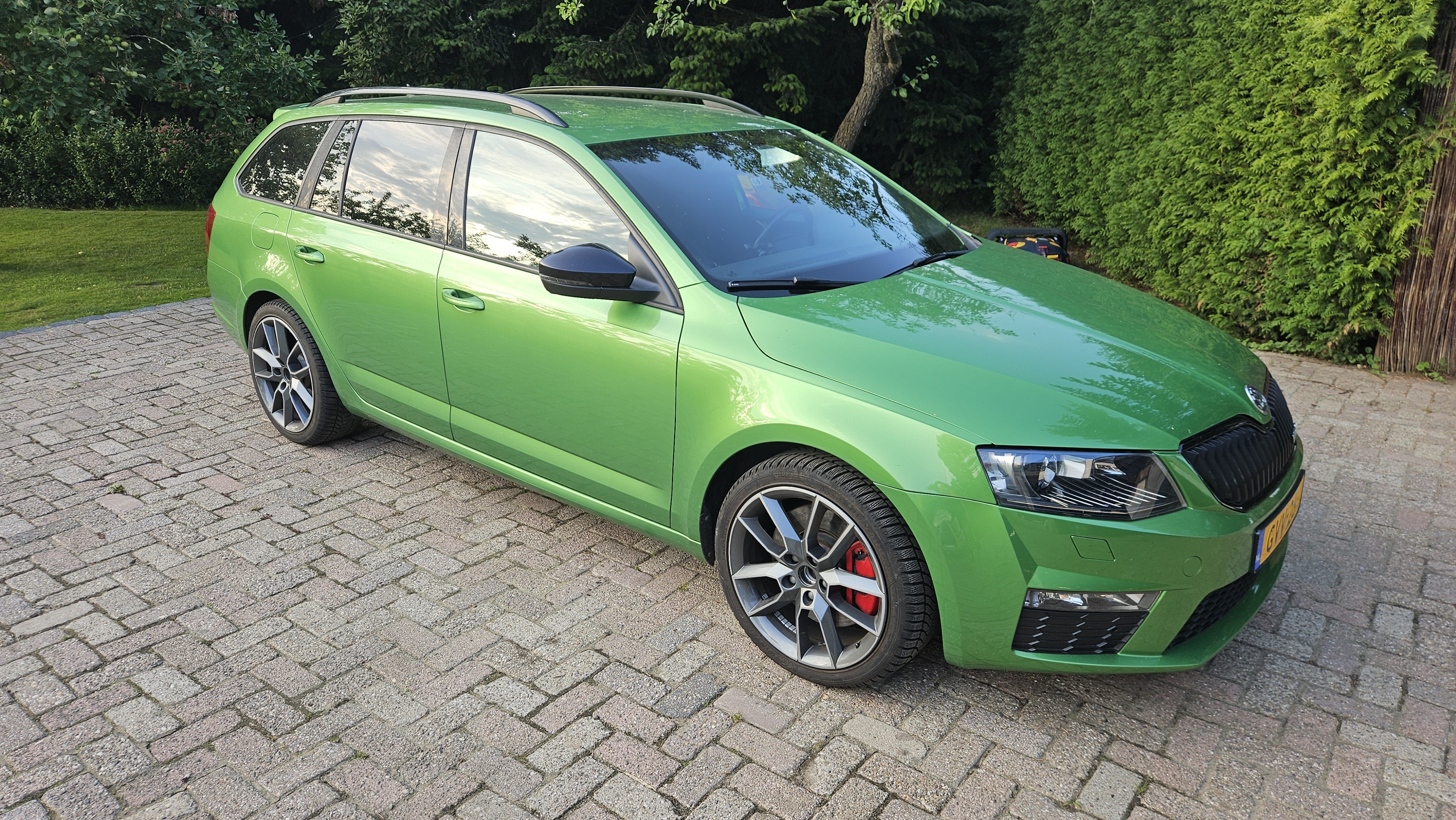

  6. My engine regularly stalls after starting. The local garage and the Skoda garage have already investigated this, but they haven't found the cause. When I press the gas pedal I can keep it running, but it is not the solution. Also when I keep trying eventually the engine will stay on. Here's what I know has already been done: The software has been updated. Start-stop has been disabled. The spark plugs have been checked. No errors in the logs. The attached video shows what happens when the engine stalls when I put it in D. You can see the status flashing between D and D1. I hope someone has a good idea what the problem might be. Tips are welcome, my car is still in warrenty πŸ™‚ VID-20250425-WA0004.mp4

  8. Hi All, Since the beginning of this year I'm a happy owner of a Octavia VRS. In May I did a tour of Scotland with it, was great fun to drive there. I was getting good info and tips from this forum, so had to sign-up. Already busy with some mods: Already put spacers on them 2,5cm back and 1,5cm in the front. No waiting on the MIB2.5 upgrade (removal of the CP of the amp is on-hold πŸ˜’) next will be lowering (kw adjustable springs)☺️
