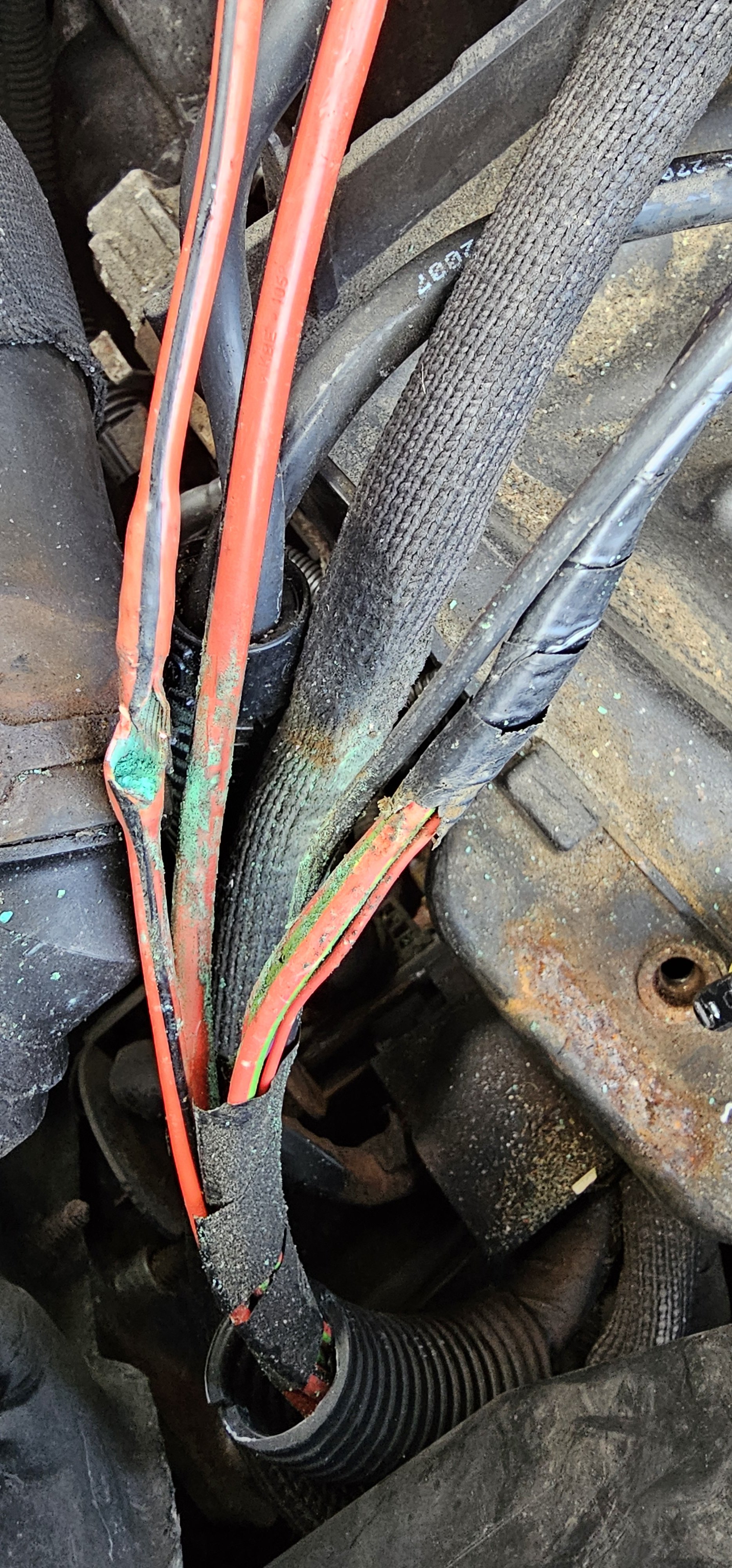

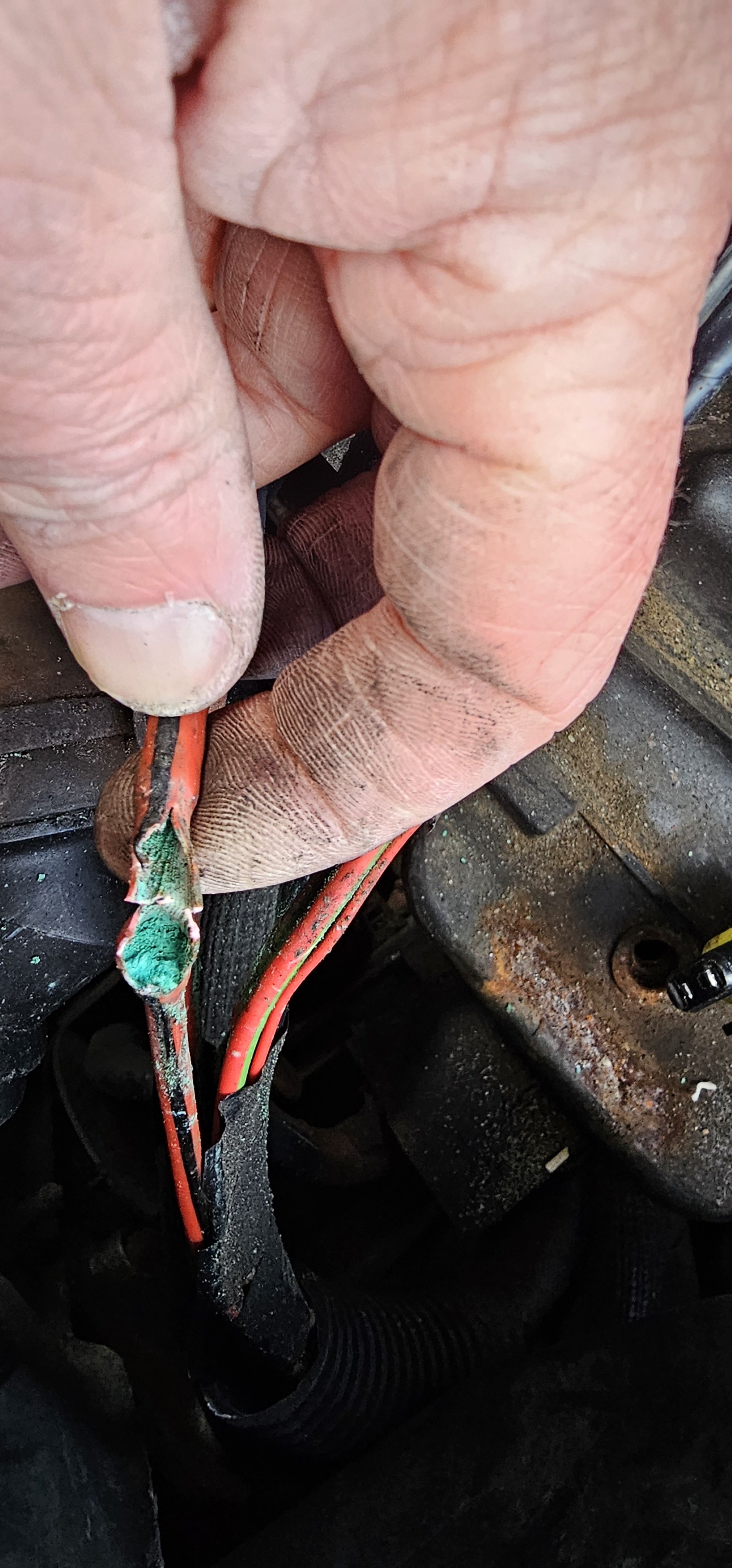

  1. Update on this window/central locking snag..... I was replacing the clutch before Christmas and upon removing the battery box I spotted a cable from the fuse box on the positive terminal with a corroded 1 inch air gap. (Photo below) Since repairing the cable there has been no faults windows and locks are back to normal. I even had the dash tell me things I never had previously.
