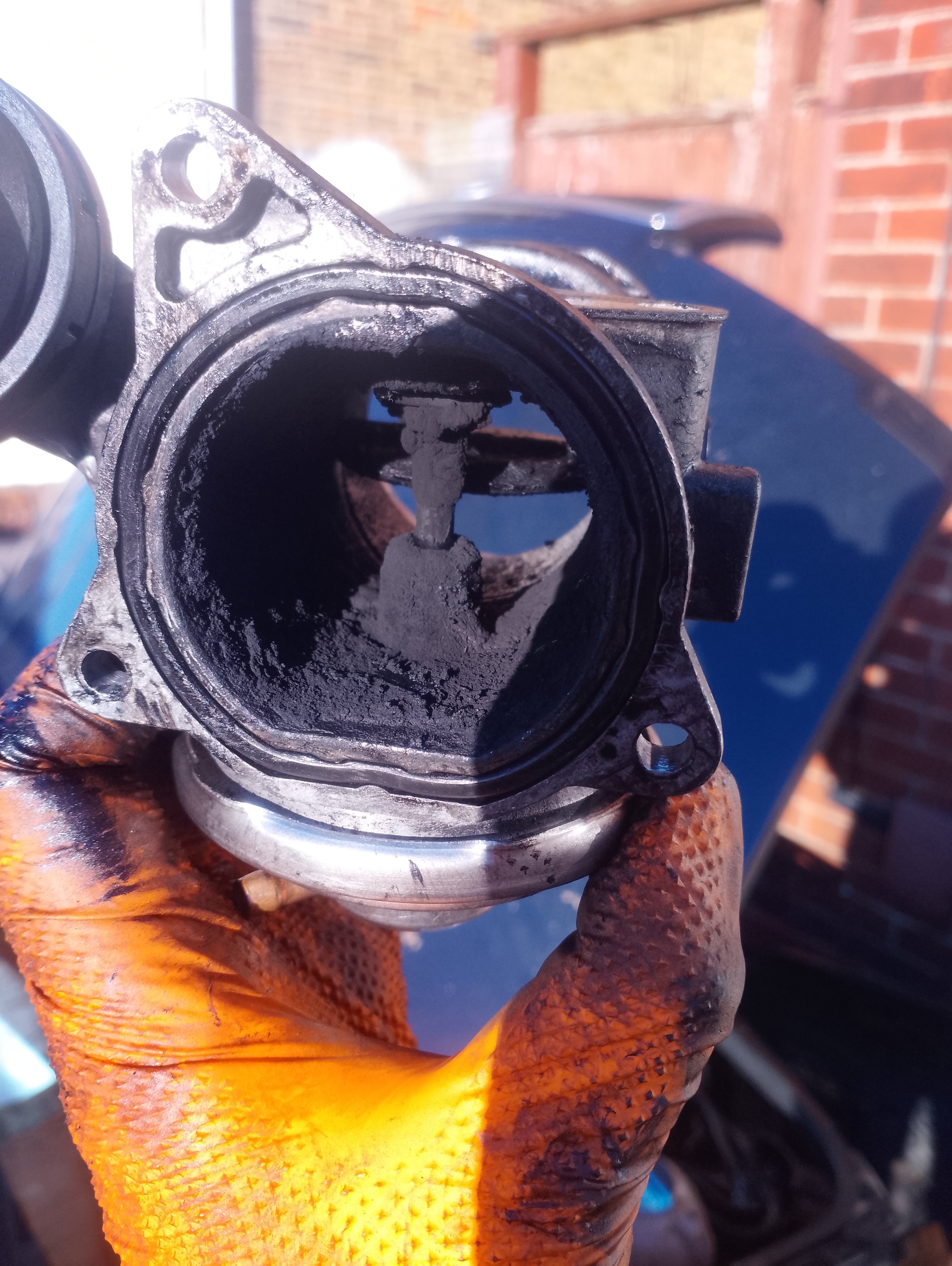

  1. I've literally just finished giving it a tickle with some oven cleaner, came up lovely!!
  2. Evening all 👋 Looking for recommendations for a decent cleaner to use on my EGR. As you can see in the picture, there is some serious build up! I imagine the valves are likely the same! What products and methods have people used with positive results for both EGR, and then with their valves?

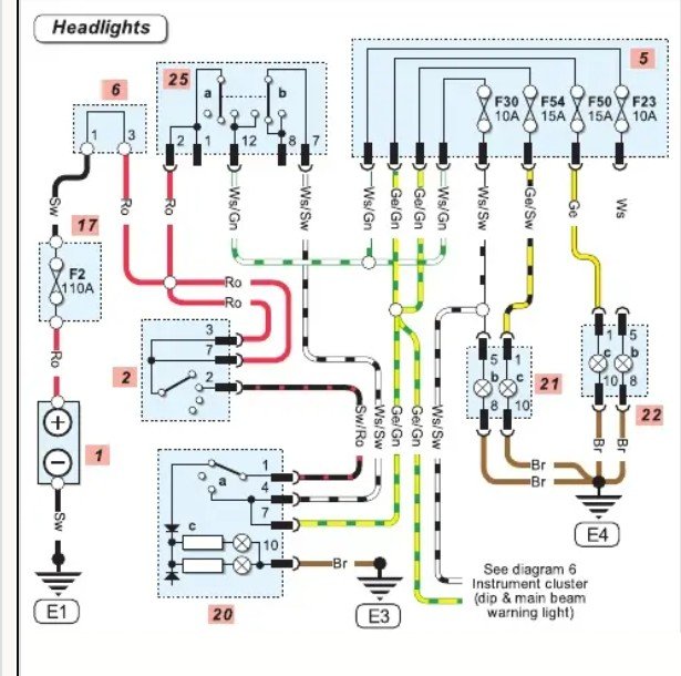

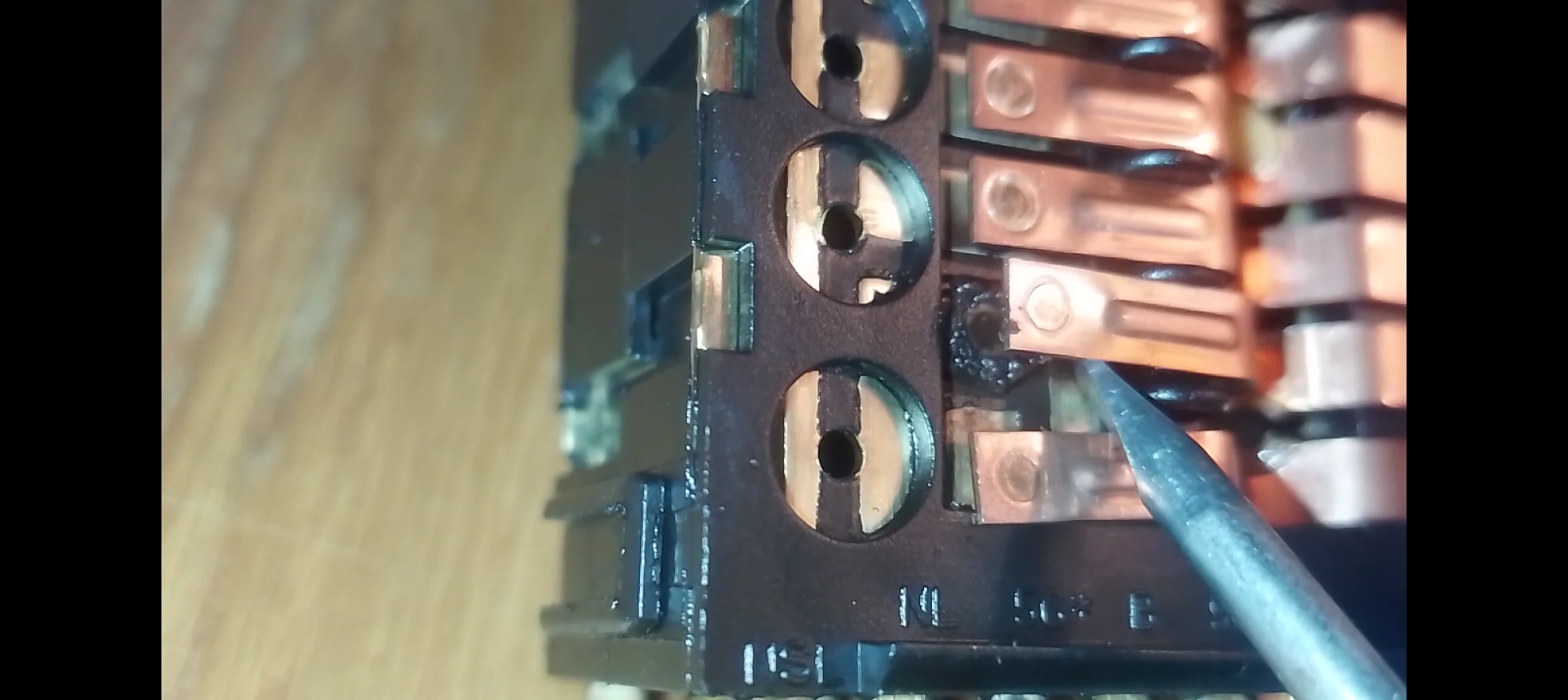

  3. Thought I would update this for those who might be struggling with dipped beam issues. As the diagram shows, the power for dipped beam is separate, it is fed from the headlight switch to the fuse board. Before the fuse board it splits into two, and feeds fuses 50+54. From there the yellow for nearside, and black and yellow for offside run straight to the headlight connector, then to the H7 bulb connectors. My issue i believe (don't take my word for it) stemmed from an oil covered earth point behind the headlight beneath the fuel filter holder. This likely caused high resistance, melting the h7 first, then taking out the other dipped beam by finally heating up the switch terminal to the point it melted inside the switch.
