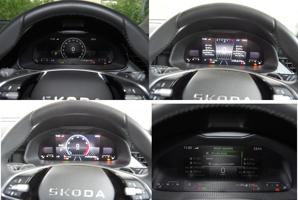

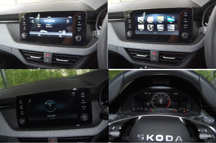

  6. Hi Aldfort During all the attempts I have had the ignition on without the car running. The left and right arrow button (lower switch) only changes between the 4 instrument dial options. You can, once on a particular dial, press the silver button which then gives you a list of the type of information you display and you can scroll through options here to choose what to display which doesn't include total range and nothing seems to happen when you press and hold the silver button for 15 seconds, as a matter of fact it just either turns your data selection on or off. In the 8.25"infotainment there is a service menu which allows you to see at how many kilometres and the date your service will trigger, my guess is a service reminder may trigger on the screen and there is a hidden screen which appears to allow for notifications to be deleted. As I mentioned in prior emails I haven't reached the service point so I am unsure whether the service reminder will be one of the items which can be deleted. Anyway, I will keep pursuing the matter until I get an answer or can provide other owners with an answer. so thank you for the time and courtesy you have extended to me. I just hope some other user has an answer! Kind Regards Quetz

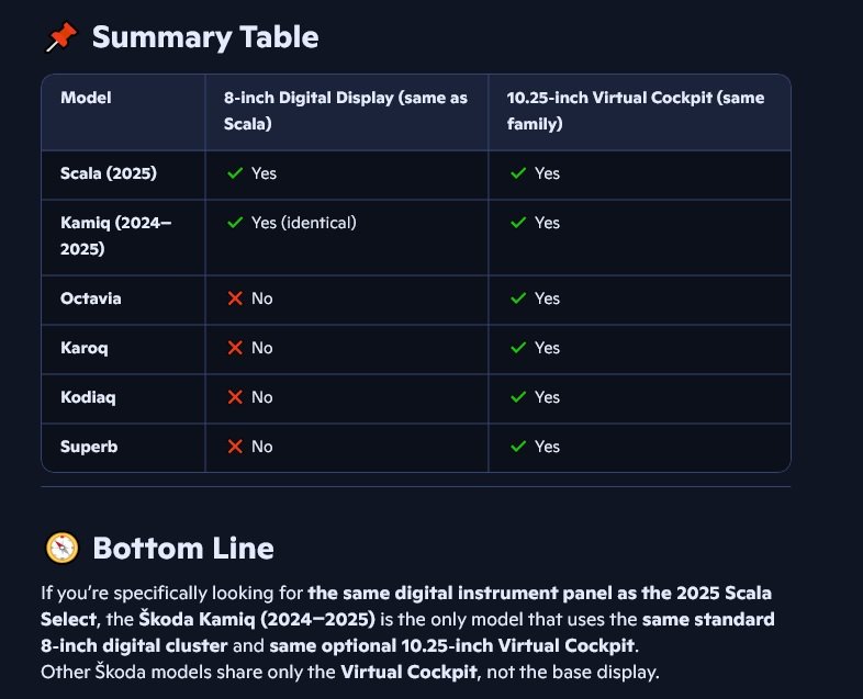

  7. Hi Aldfort I tried the Octavia video a couple of times and it isn't the same as what I get on my Panel, I consulted with AI which shows that only the Kamiq (2024 and 2025) and the 2025 Scala have the 8" (actually 8.25") and none of the other models have one (see the attached picture). I also explored your suggestion that "Launch" would probably cover the Scala 2025 and one of the main providers replied as follows" Dear customer, thank you for contacting us. I am your service specialist, Vivi. Please rest assured that I will do my best to assist you. Sorry this scanner doesn’t support your car do this function . Alternatively,you can refer to the link in the attached image to check compatibility. Should you have any further questions, please do not hesitate to contact us. We wish you a pleasant day!‌‍‍‌‍‍‌‌‌‌‌‌‌‌‍‌‌‌‌‌‍‌‍‌‍‍‌‍‌‍‌‍‍‍‌‍‌‌‌‍‍‍‍‍‍‍‍‍‍‍‍‍‍‍‍‍‍‍‍‍‍‌"I did check the link but it only covered up to 2024 Scala Models. I appreciate your help if you have any further info it would be greatly appreciated!! Thanks Quetz
  8. Hi Aldort I note from your pictures in your last post that they are from the better model Scala, my Scala is a Select which means it is the basic model which doesn't have Satnav and has an 8.25" infotainment. The Select doesn't have dual digital instrument clusters and you will note from my pictures the 4 options for the single dial instrument display. The only real subsystems accessed by the buttons on the RHS of the steering wheel are the various assist systems and all the YouTubes I have accessed (probably about 15 so far) have different functionality than my car's system. I had hoped it would be similar to other Skodas but even my sons 2024 Skoda Octavia has completely different system. I just hope there is someone who has knowledge of my car's sytems. Thanks Quetz
  9. Hi Aldfort I extensively looked into YouTube prior to posting and unfortunately none work on my Scala, I have of course tried each YouTube referred to including your offering of the Skoda Superb. The main difference between the YouTubes suggested so far (and also all the others I have tried) is that I have only one position for a dial on the digital instrument cluster and the YouTubes suggested have two dials or they have a trip meter button reset and mine does not. I will take a picture of what my dash looks like for further information and post it later. To your suggestion of a Launch OBD2 this looks hopeful but I still need confirmation that it includes functionality for a Skoda Scala 2025 as I have tried say 5 other suppliers and they say they haven't got an update for the 2025 Scala. Pleas note I haven't got the service reminder yet on my car and maybe it can be reset using the infotainment but I have no confirmation from the manual or Skoda. Even in the manual it gives no description on service reset except to say it prefers the dealer to undertake services, I have been successfully carrying out services on my cars over the last 50 years including 3 other Skodas and also worked for a year or two as a gearbox re-conditioner. Even so car electricals are far more difficult these days so help from the Skoda community is helpful and wanted. Thanks Quetz
