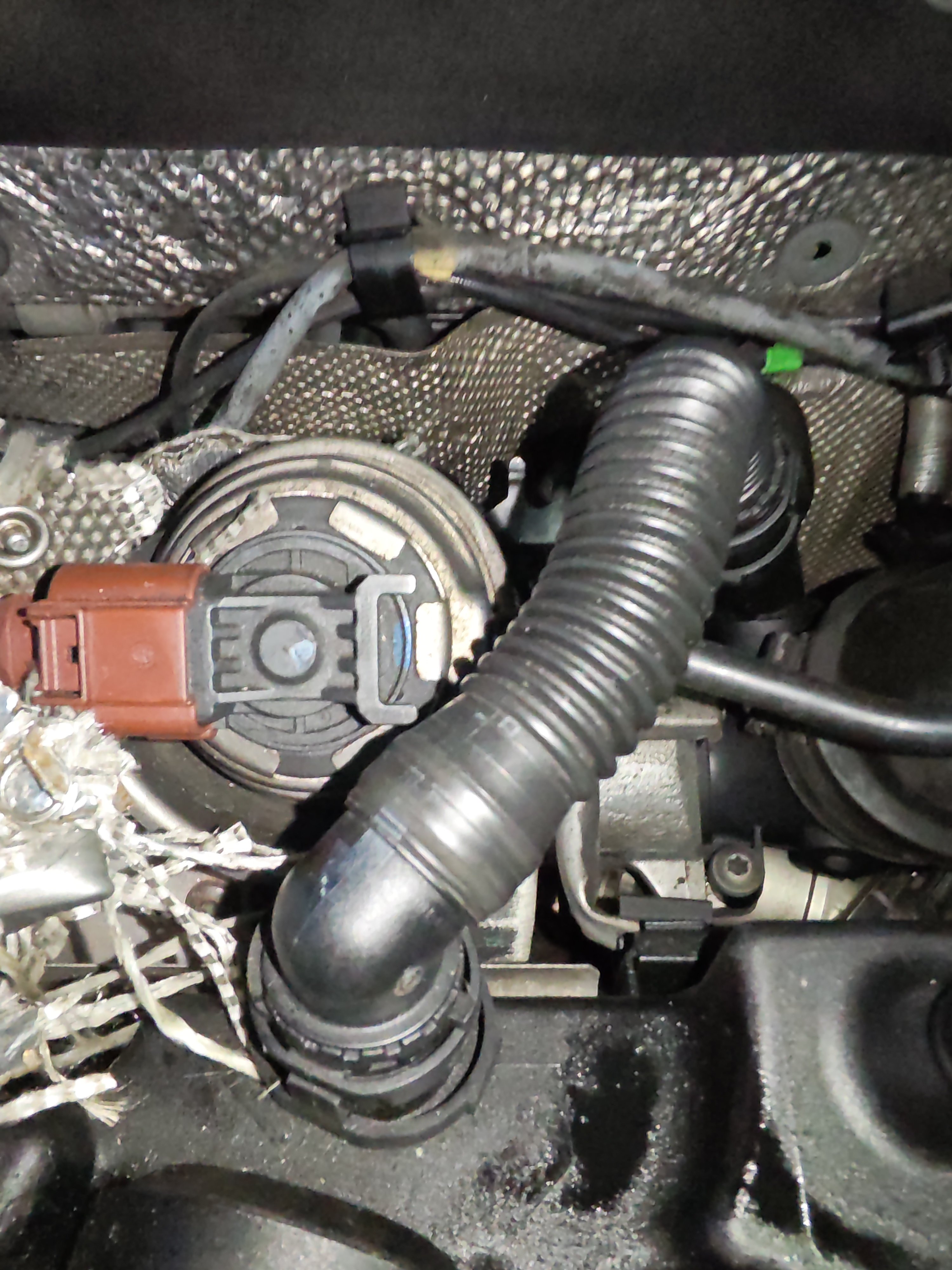

  4. Hi Just an update, I still haven't figured out what's causing the issue I'm going to get some more logs. Here's some screenshots of some logs earlier. I noticed someone had repaired the PCV Hose from the Turbo Housing to the Crank Case Cover
