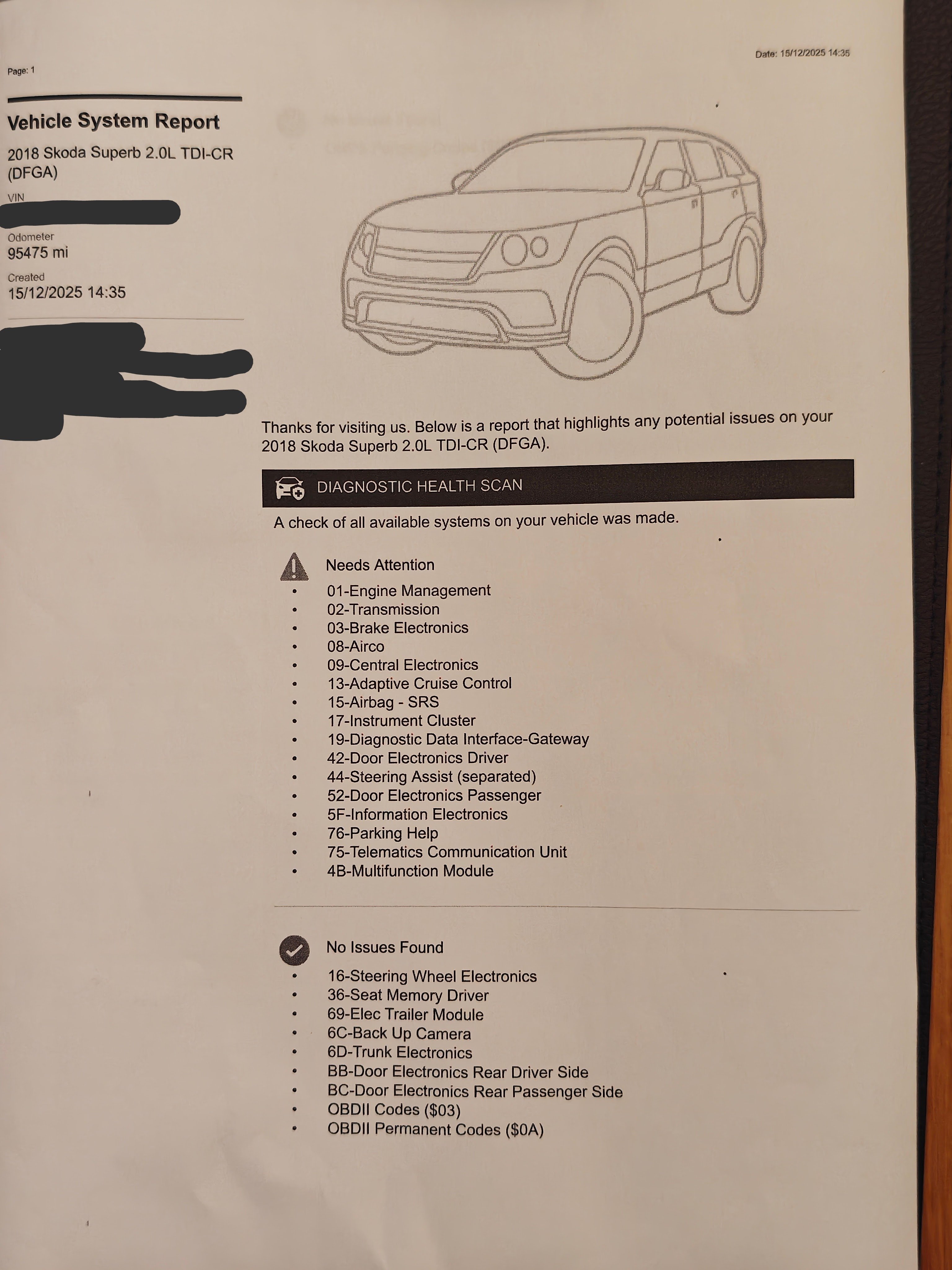

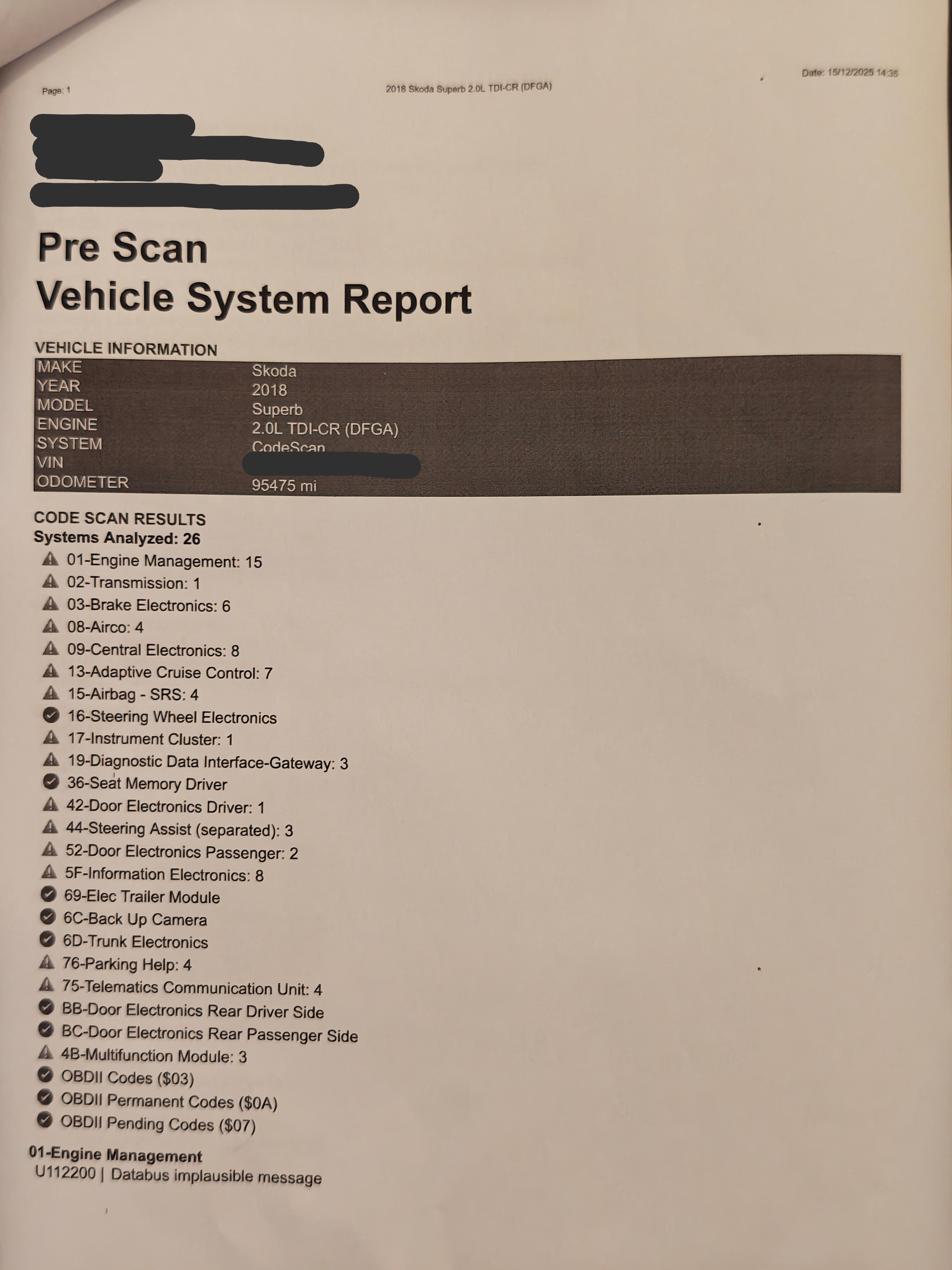

  5. Ended up at 12.6 after a 5mi journey so I guess I can probably strike that out. Initial chat today with the seller went down the line of "oh well a battery costs us £60 so that's what we'd contribute", never mind that the Skoda quote for an OEM spec one is £400, a few independents have said ~ £180.
