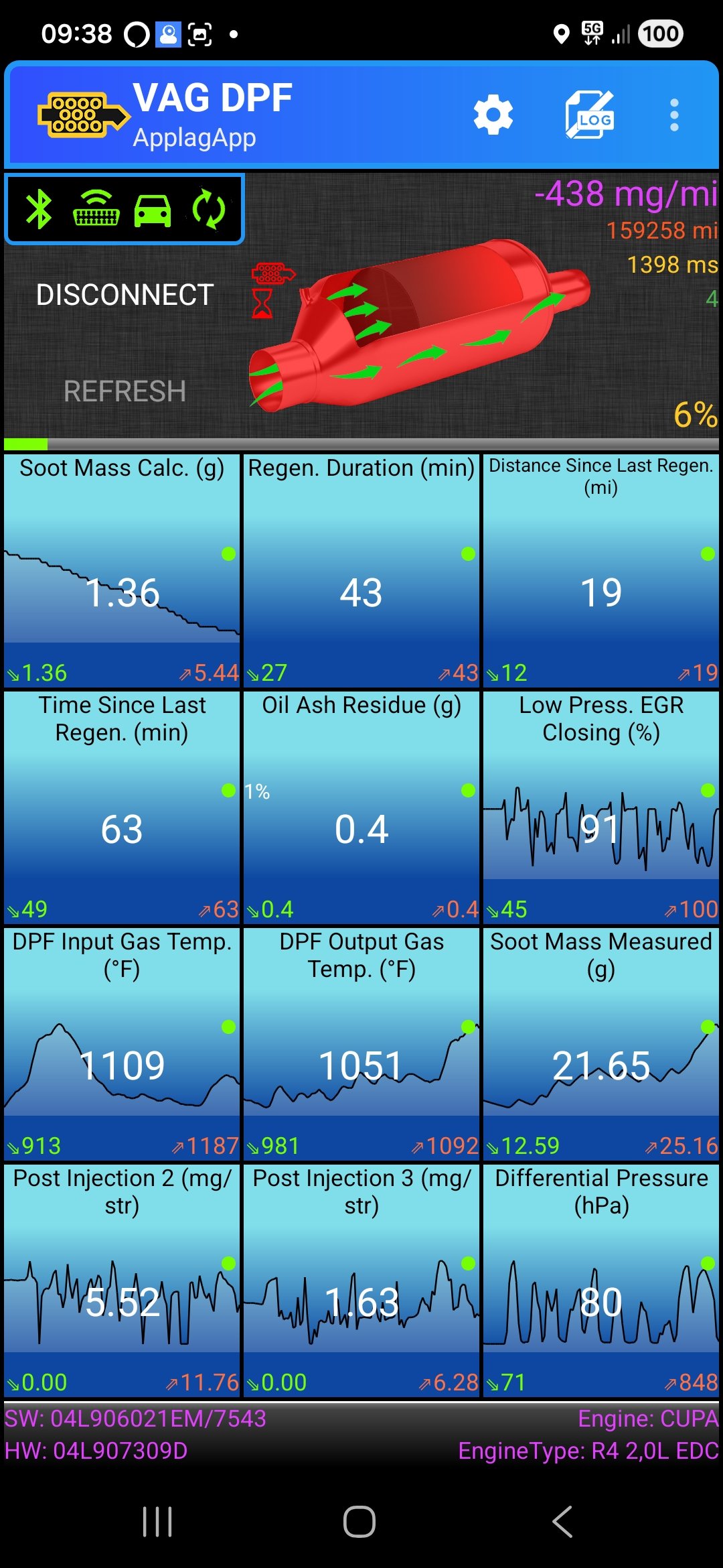

  1. Had it done already,made no difference,think it may need to be removed to be cleaned🤔
  2. I drove all the way round the M60 motorway and more,a full 62 miles in 4th gear at near 3000rpm and still the same,so cant be the "italian tune"😪
  3. Hi,i have downloaded the vagdpf app,this is my car with 160k on it,anything over a 10 min drive and tickover is at 1000 and fan always on when i park up,is my dof knackered with such high pressure? Thanks
