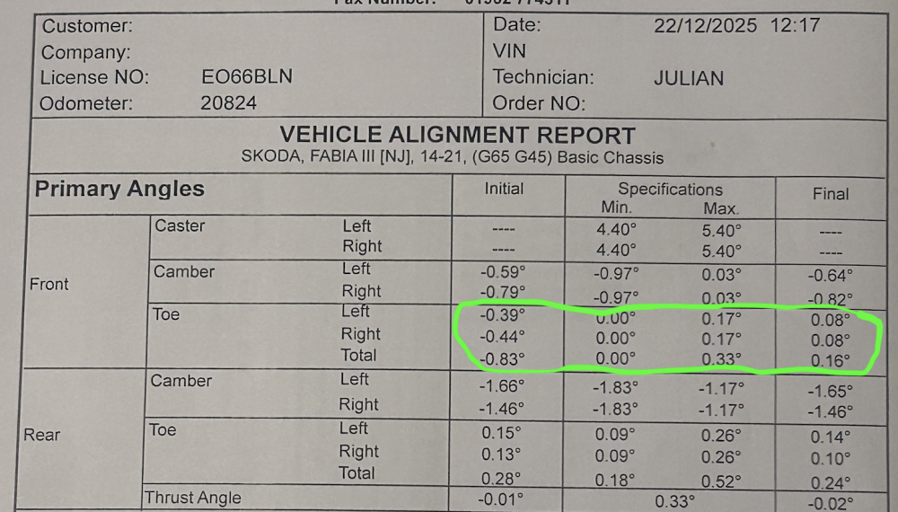

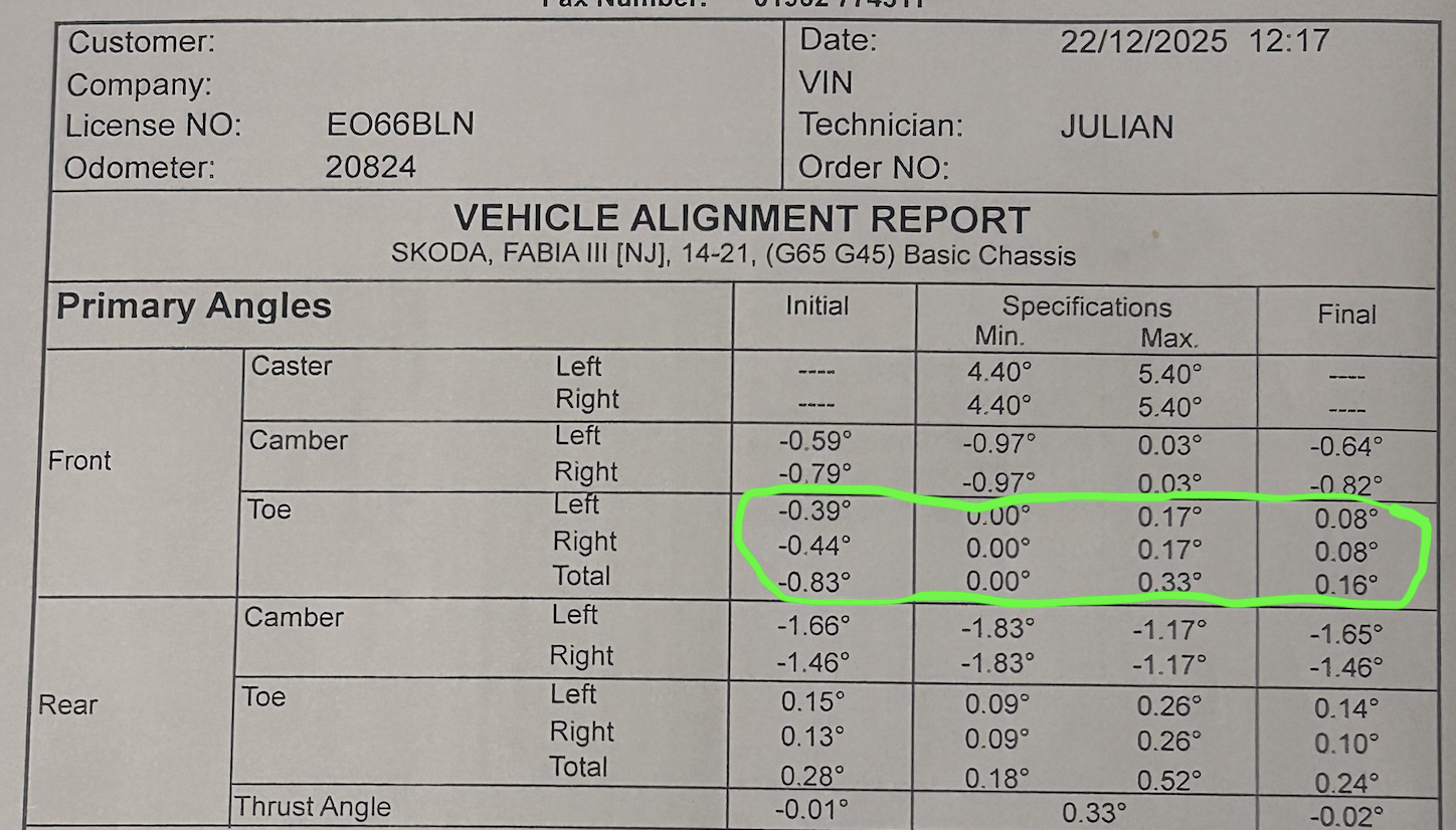

  5. Thanks again for all your input. On the way to the tyre place I did fill up with Shell V-power which I have used for many years with good results on other cars, and particularly like this fuel as it will not go off in my hibernated car over winter, unlike most of the E10 fuels. I gave the car a good run and pushed the limits of the existing tyres a bit (with full consideration that the fronts were 9+ years old!) and found something amiss with the handling, it was not keen to turn in as well as our previous Polo, and just to add some background I have decades of road and track driving performance cars, so do have a feel for what a car should be doing. After looking at many MOT histories of Fabias around this age I noticed a pattern of uneven front tyres wear at low mileages and I suspect that many were not set up correctly from the factory. Intiially I suspected they had just been bumped into a curb etc, but it has been just too common to put it down to that. Indeed, after the new tyres (rotated to the rear) and then the wheel alignment done the car was transformed - no longer does it wash out wide but has a pleasant willingness to turn it but still keep the safe FWD handling that suits these cars. My tyre place is Micheldever Tyres in Hampshire, been using it for many decades now and they've always done a good job, one of the few places I would trust to work on my cars. The alignment service is on a special offer currently, if you have two or more tyres replaced then you get it for half-price. Good value considering they took around 40 mins to check and adjust the alignment. Yes, Costco would work out cheaper for the tyres, but with respect to their employees I wouldn't trust them to change my socks. Next job is brakes next week and I've ordered plugs, oil, pollen and air filters so I have something to keep me busy over the holidays. Will update you with my progress and thanks again!
  6. I was a little surprised to see the guy using a proper torque wrench to tighten the wheel nuts up. I think one of the reasons a lot of places don't, is that almost nobody checks them after 100 miles so they cover themselves by over-tightening. I noticed early on in the car's life it had MOT advisories for uneven tyre wear. For some reason the former owner just replaced the tyres but without doing any alignment check, and so I thought I'd get it done since I'm spending ££ on tyres. The toe-in was way out, and on the drive home it felt much more willing to turn into corners, can't believe it had not been checked for the sake of 25 quid.
