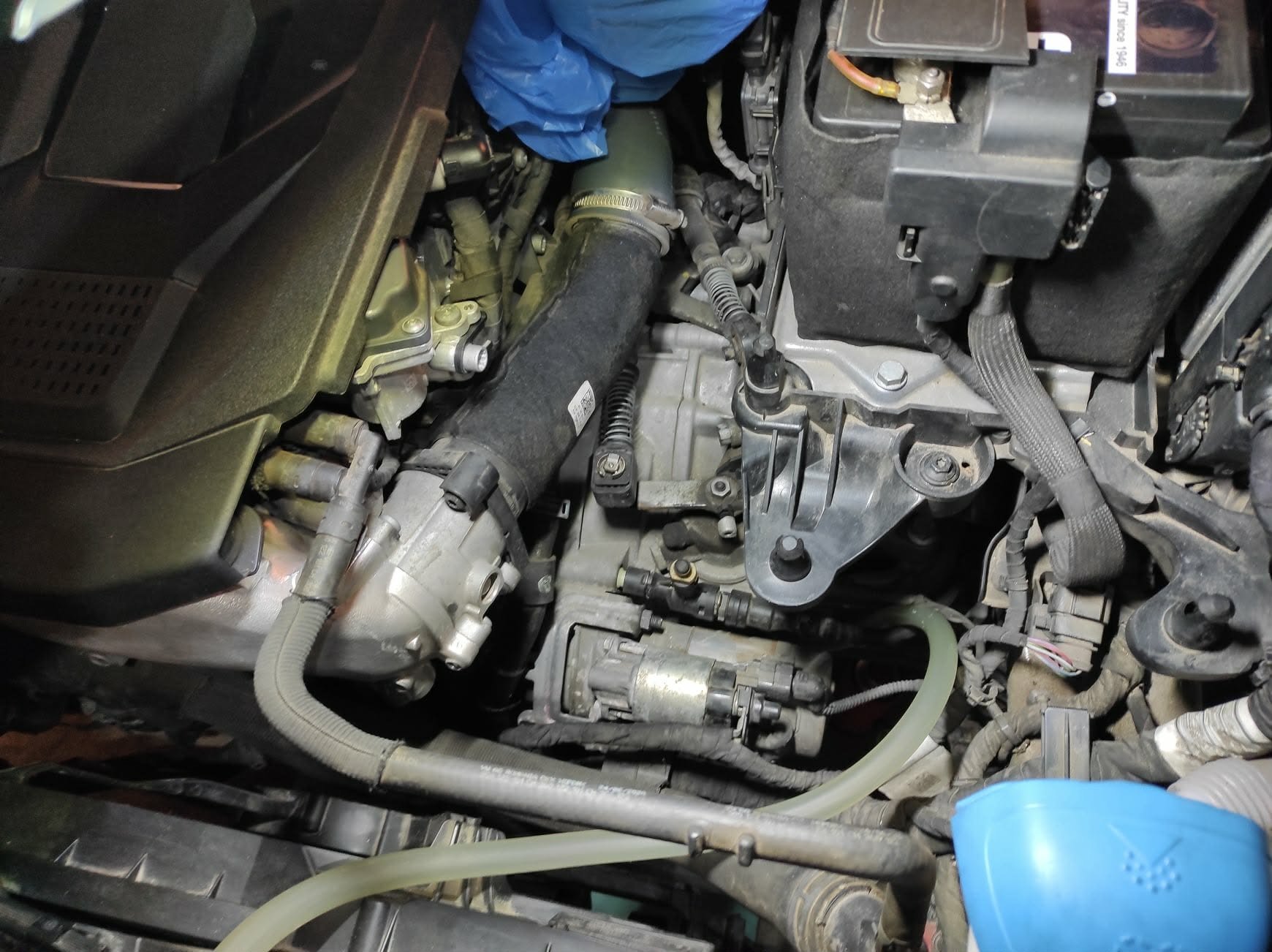

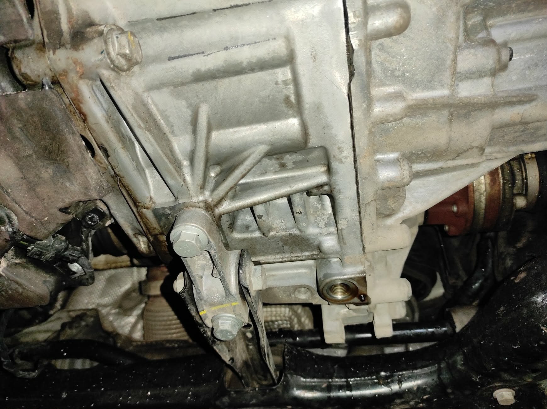

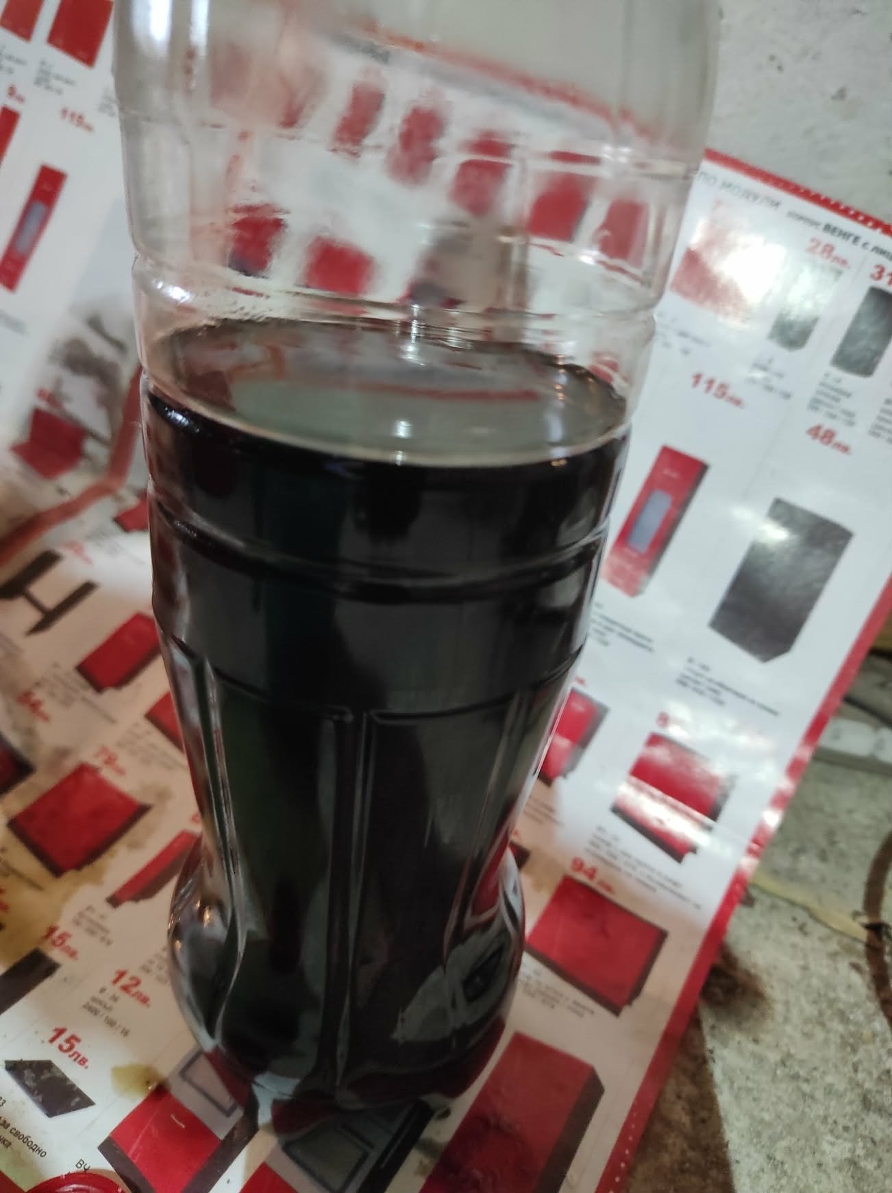

  1. Hello Warmed up the car with 20 km of mixed driving and I drained 1.4 liters of tar oil. The plug is the most common with a 10 star torx wrench (tighten with 45Nm) According to the specification, they give it 1.5 liters, but some put 1.6 liters! G O52 527 A2 full synthetic gearbox oil Here from here (shaft speed sensor), I'll pour it in with a hose and funnel, since I removed the air filter box.

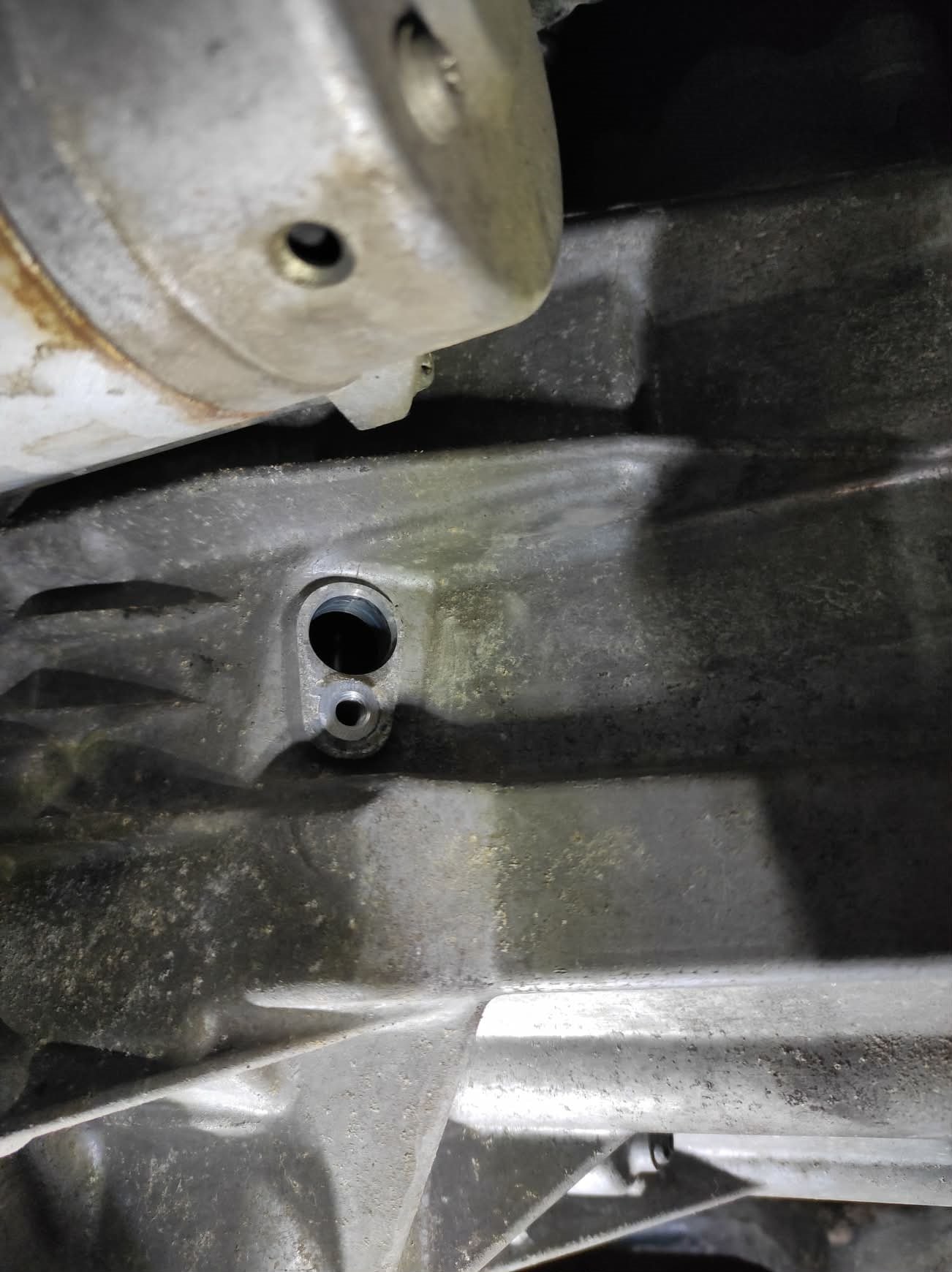

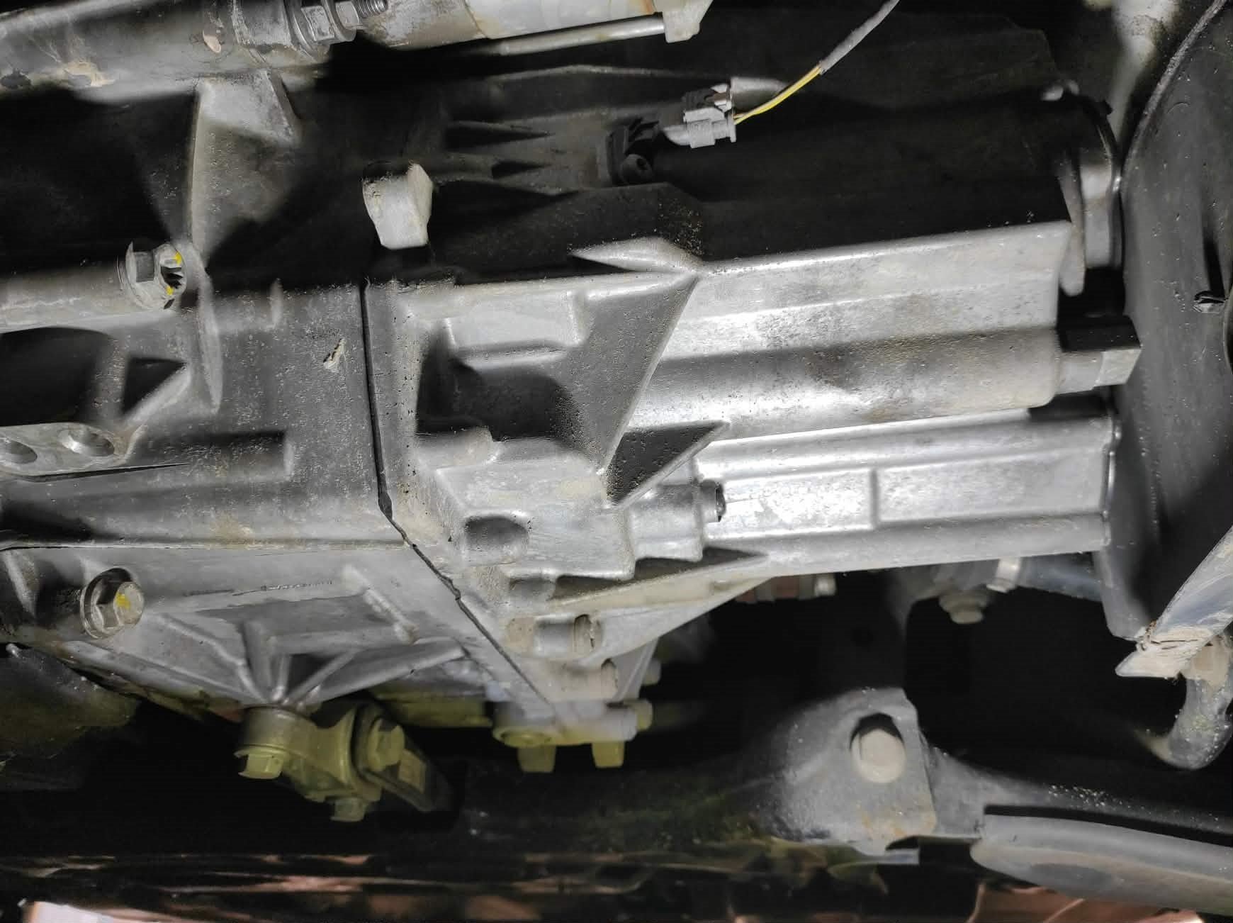

  2. Hello Today I looked through the entire gearbox and didn't find an oil filler plug, except for the hole in the neutral speed sensor.

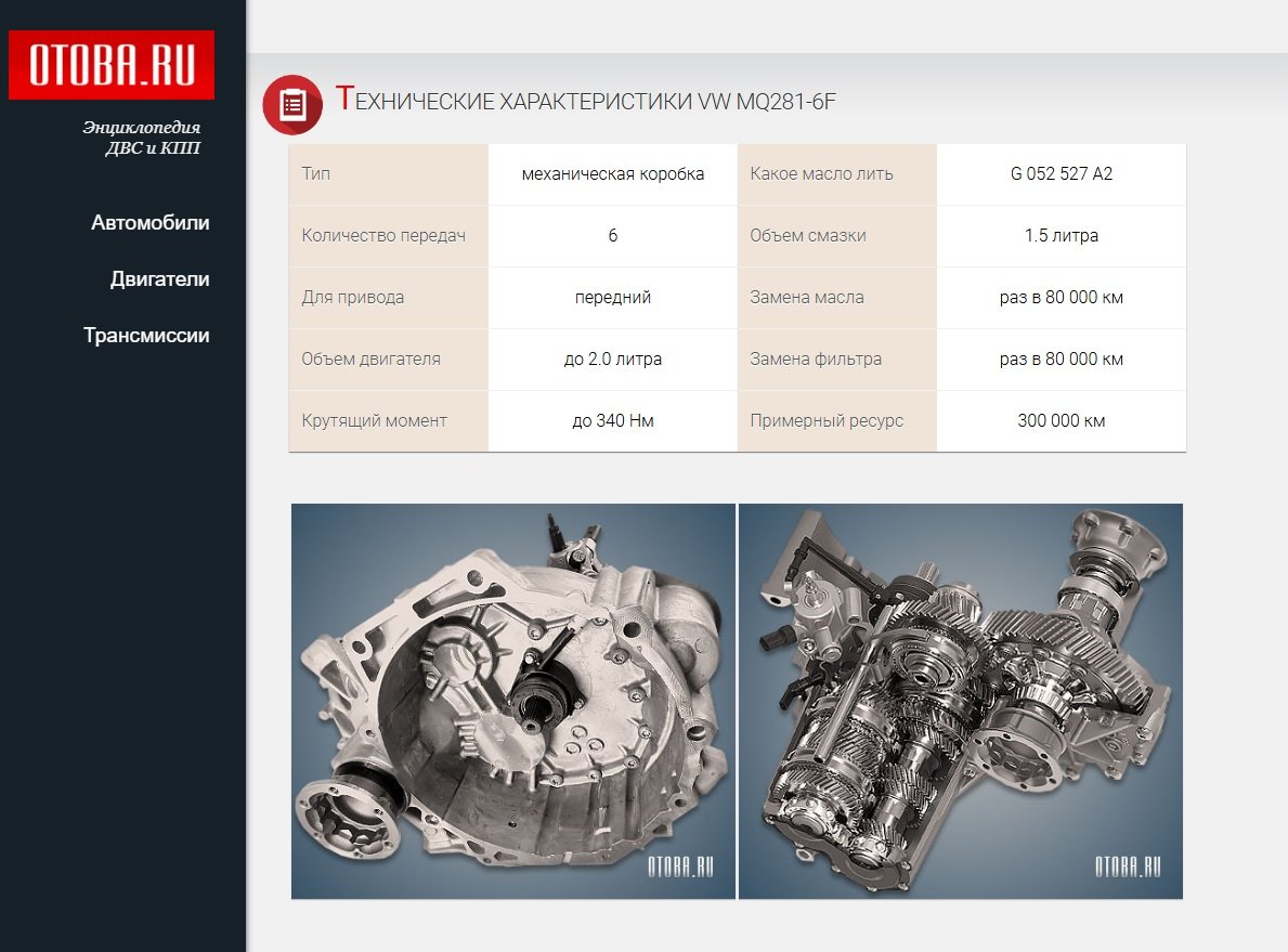

  3. Мaybe this should be the place to fill with new oil.

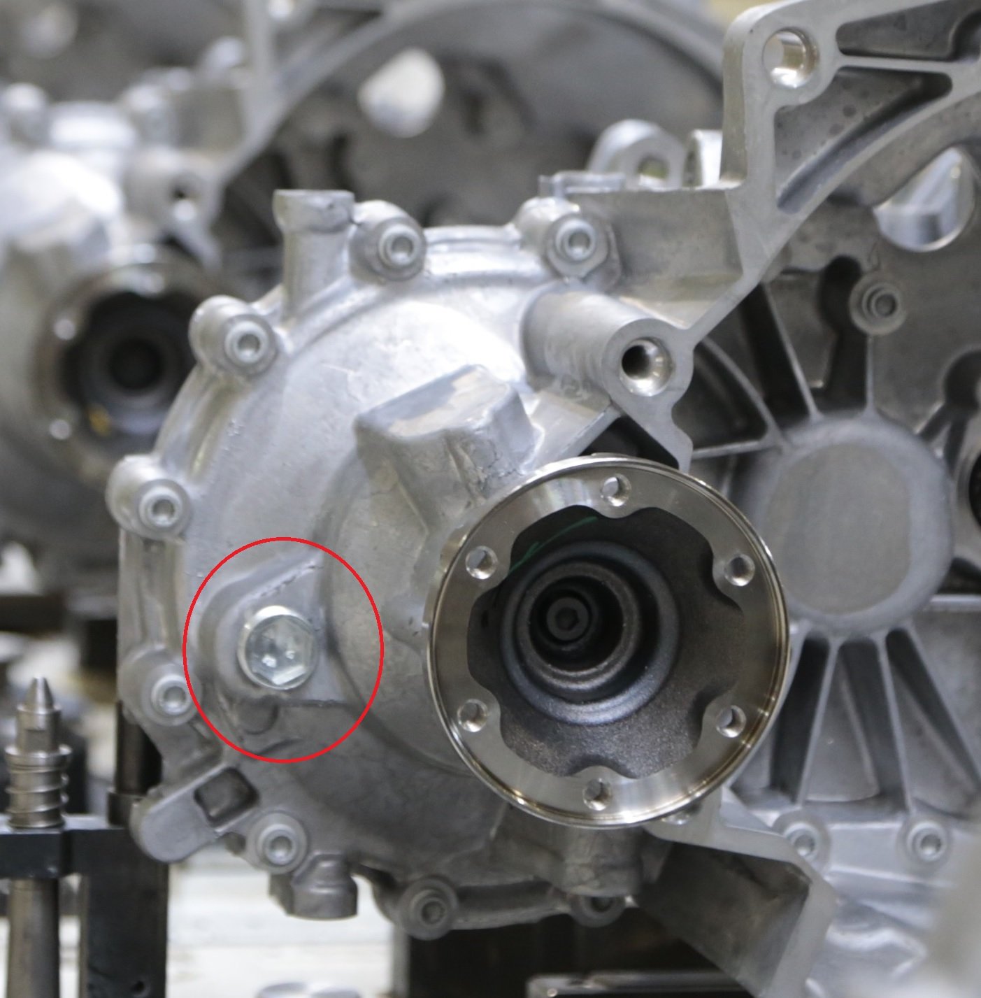

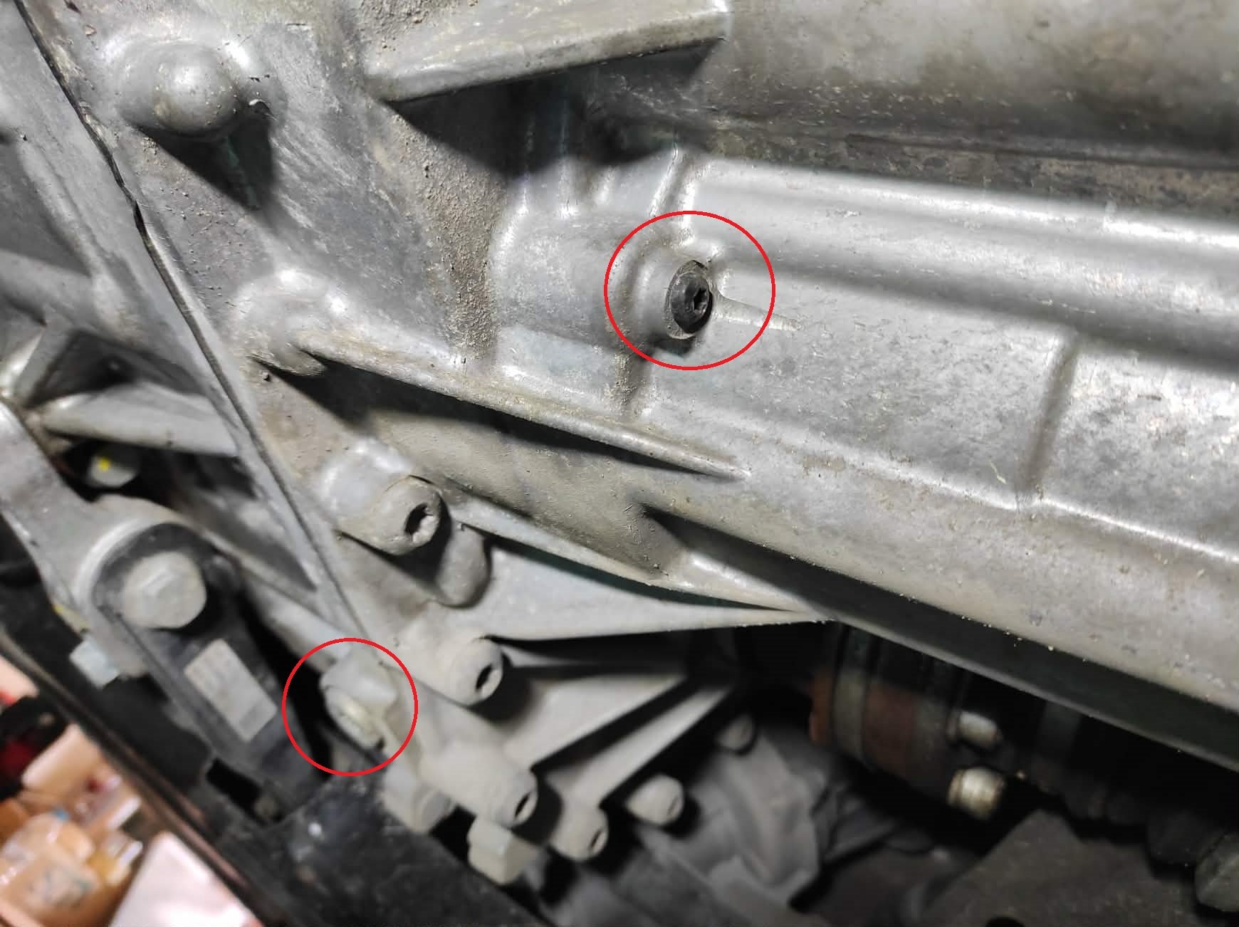

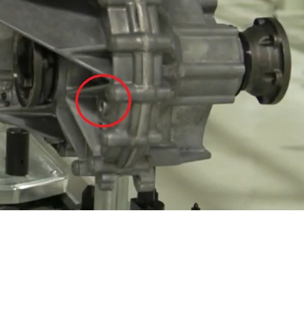

  4. The gearbox is Code UEV (0C9 MQ281-6F). In the picture, the oil is poured through the black bolt, and drained from the plug below.

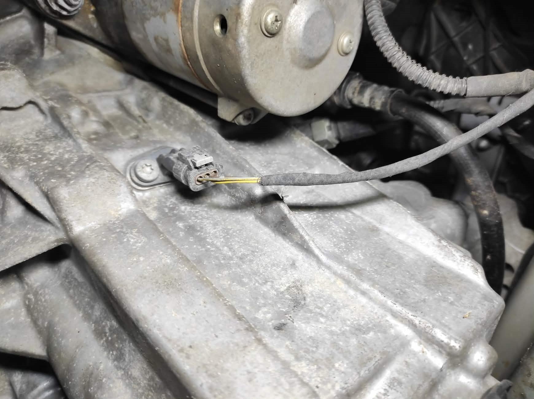

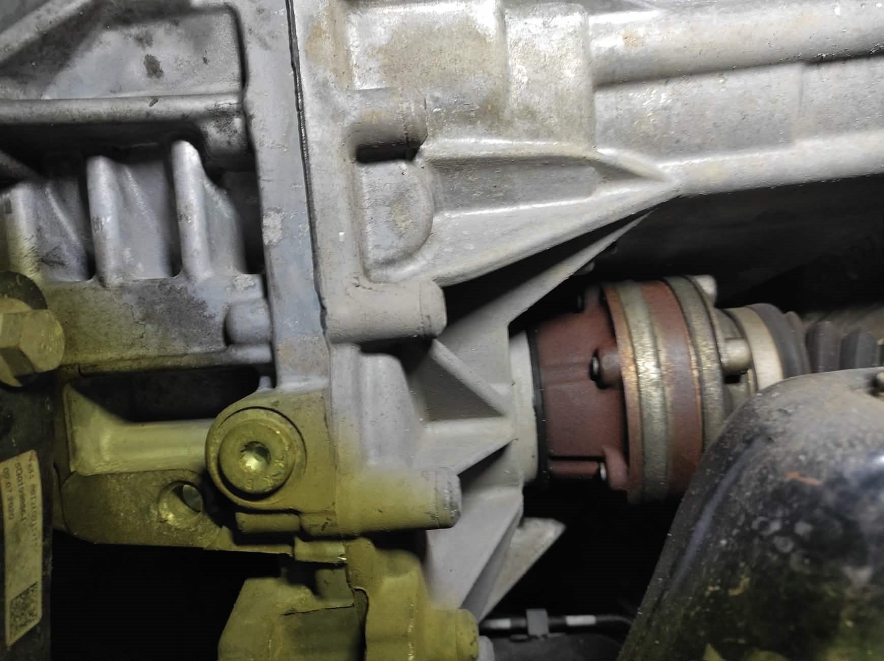

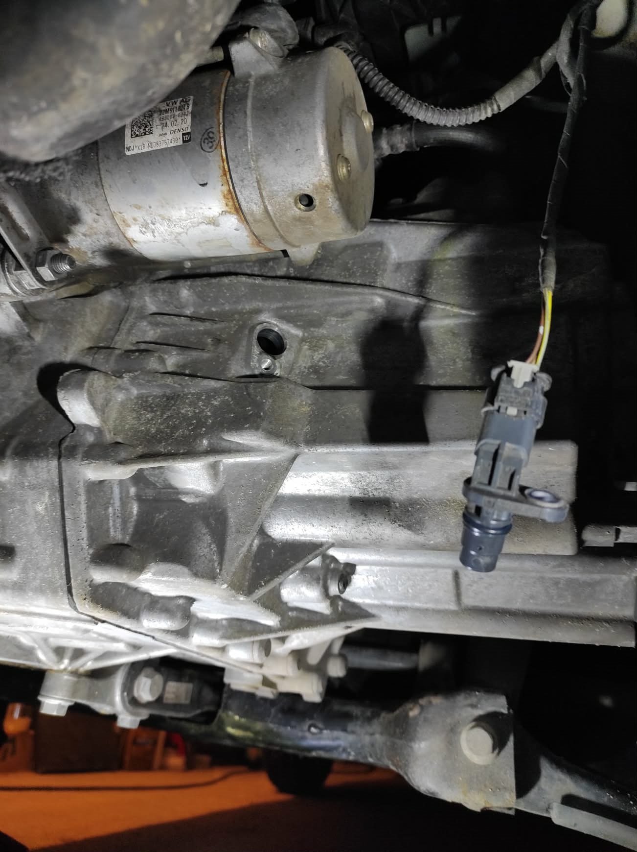

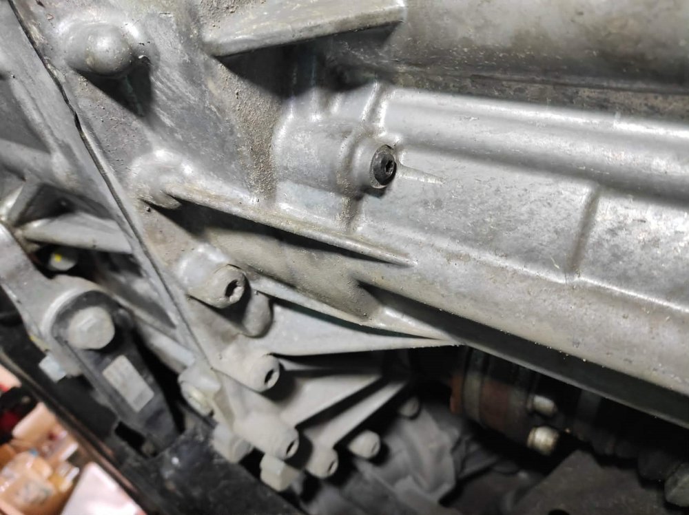

  5. Hello! I've been searching the net all day today and I can't find anywhere how to change the oil in a 6-speed gearbox of this model, here are some pictures of what it looks like https://photos.app.goo.gl/TusAtkmhwGfmS3rN6. The pictures show a small black bolt, the speed sensor and above the starter, the rear speed sensor. I don't know how to find out exactly what model my gearbox is. I found info about the engine, the entire suspension and everything else, but nothing about a manual gearbox. There are a bunch of videos and information about an automatic. So far I've changed to a 5-speed gearbox, but it has two plugs and it's easy there. Skoda Octavia 2021 - 2.0TDI - DSU-85KW
