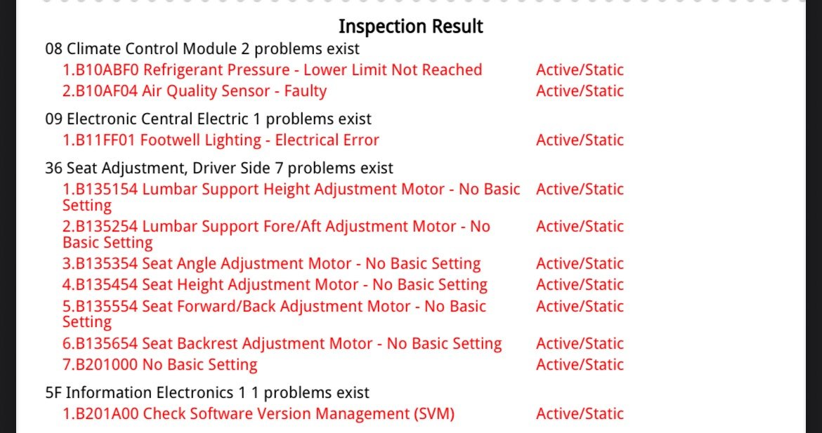

  1. Thanks for the responses! So there are no lights on the dash when it happens. The P171900 code comes in under the air con codes. I am going to get the gas done next week. I did read the crank sensor is a possibility also. Will look to get that changed. I put a new clutch kit into it when I bought it as the bearing was gone. I also changed the oil temp sensor as it came up on a bulletin with the symptoms i'm having. For full clarity my friend is a mechanic and is helping me with this also.
