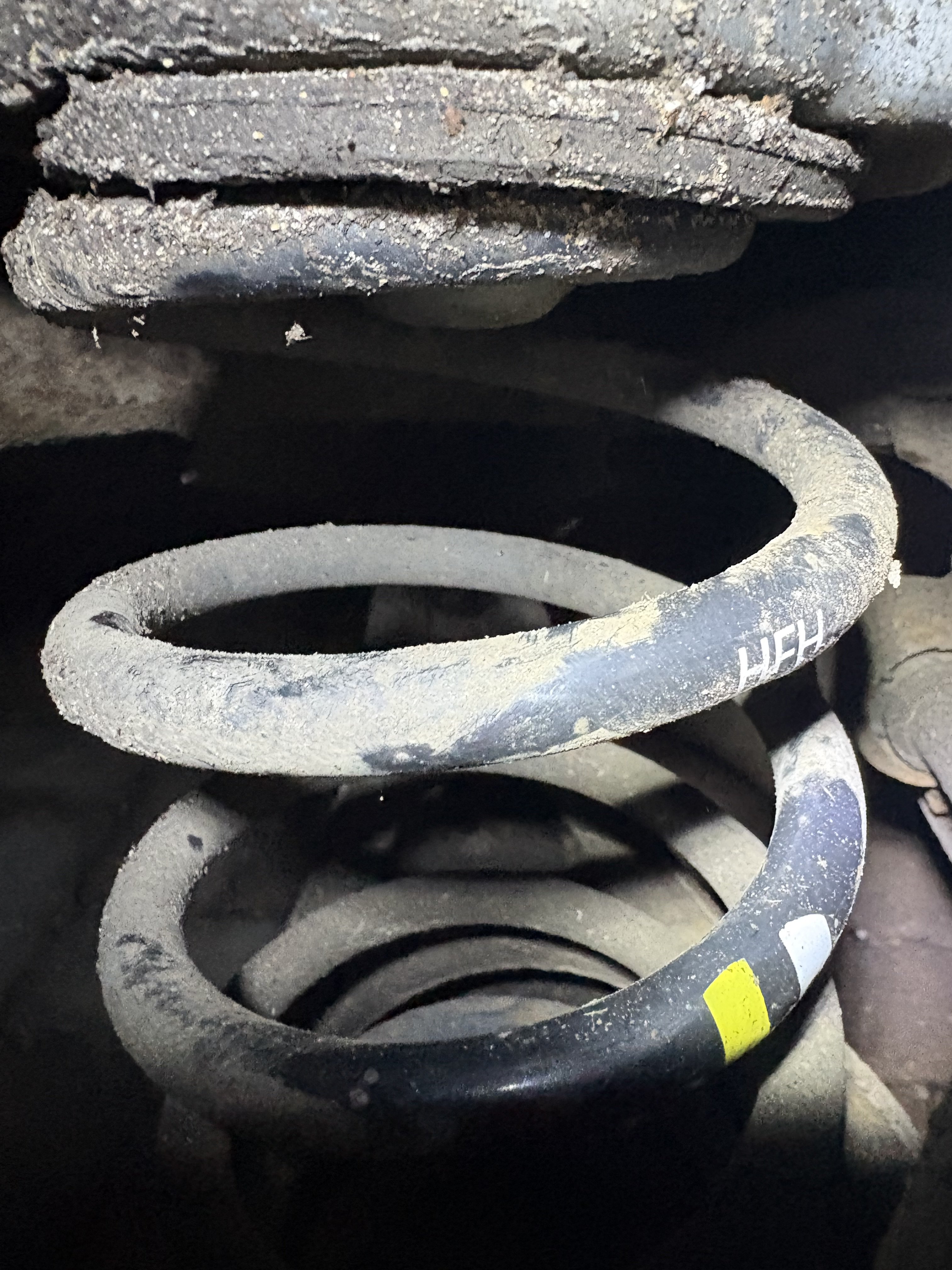

  1. Took the wheel off to have a look and the spring has white and yellow marks - which I think confirms it is 1K0511115BD.

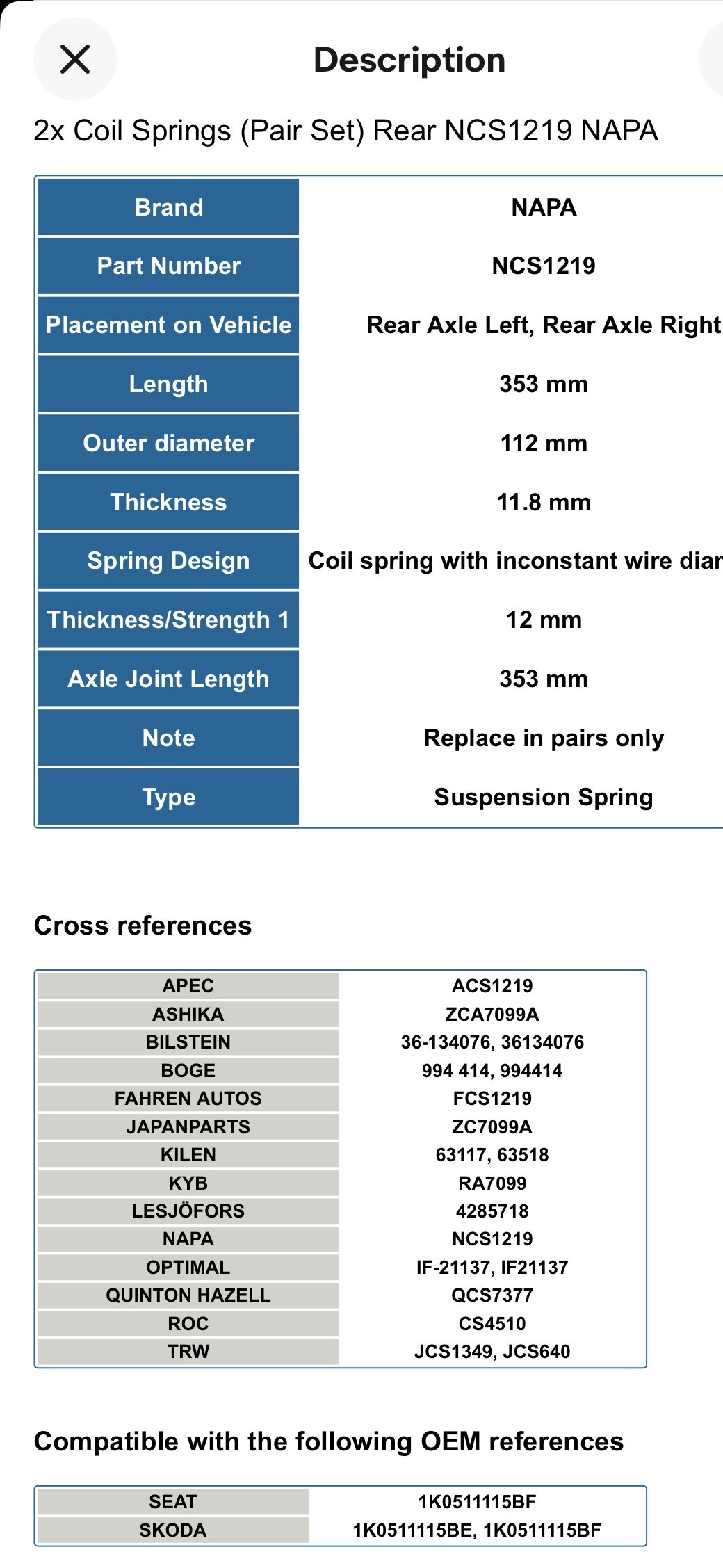

  2. Thanks , really helpful. Is matching wire diameter / length a safe way to work out how close to the OEM part it is? I was looking at these on eBay, not too far off the 1K0511115BF spec you listed above. You think this would be ok?

  4. Cheers, had a quick look and the ones that come up when I put my reg in on that site (including the ones you mentioned NCS1140 £18.75) seem to be part number 1K0511115BG. It’s confusing because other sites have recommended 1K0511115BD - which if I’m understanding the last letter codes correctly is 3 levels softer than BG. I suppose I should take the wheel off and see if I can see the colour code of the current springs…
  5. Thanks for your help, is your car an estate? I basically just want to be able to carry passengers without scraping on speed bumps. I’m not often carrying really heavy loads and I’m not towing . Having read this thread https://www.briskoda.net/forums/topic/500864-mk-ii-octy-estate-variable-rate-springs-other-than-bilstein/page/2/#findComment-5656174 it seems like I might want to ignore the 1K0 511 115 BD and get something stiffer? But I’m also reading in this thread https://www.briskoda.net/forums/topic/500864-mk-ii-octy-estate-variable-rate-springs-other-than-bilstein/#findComment-5655975 that the 1K0 511 115 BG is too hard! I found this on eBay which is listed as replacement for 1K0 511 115 BE and 1K0 511 115 BF https://ebay.us/m/CNfvMN . Maybe would be a good middle ground ?
