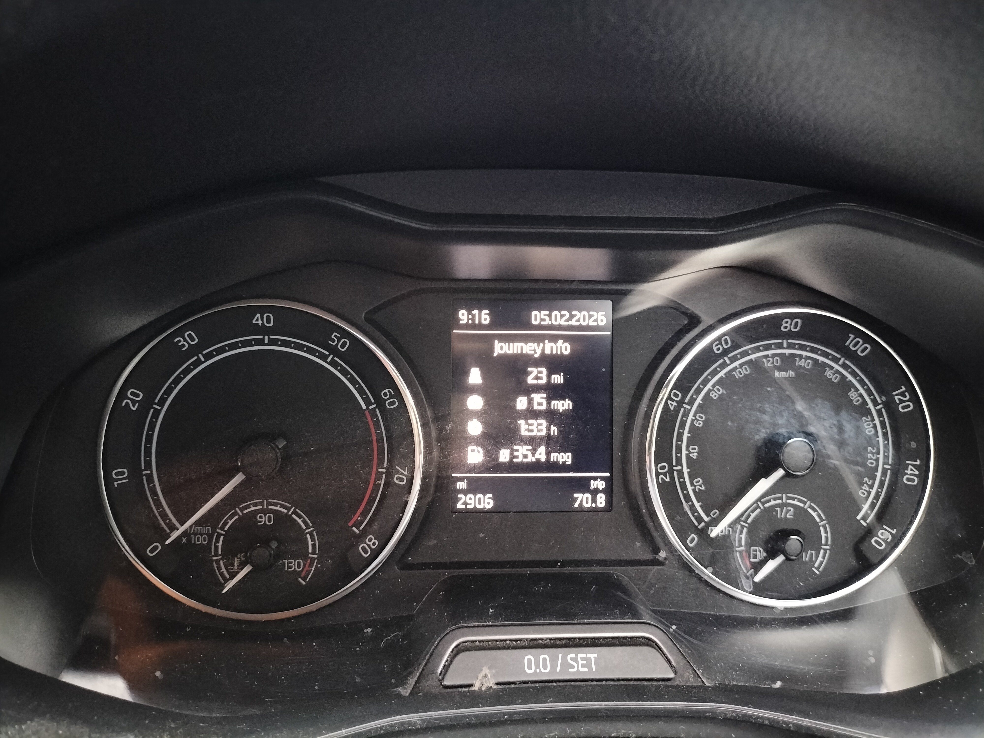

  6. Here is the display, for clarity! The car is on a '20' plate.

  8. Hi, thanks for replying JB25. The mileage display is bottom left on my cluster and never actually disappeared, it just went to zero and is now climbing again as I drive around. It's now on about 2500 which is about 86k less than it should be! It's a puzzle to be sure 😜
