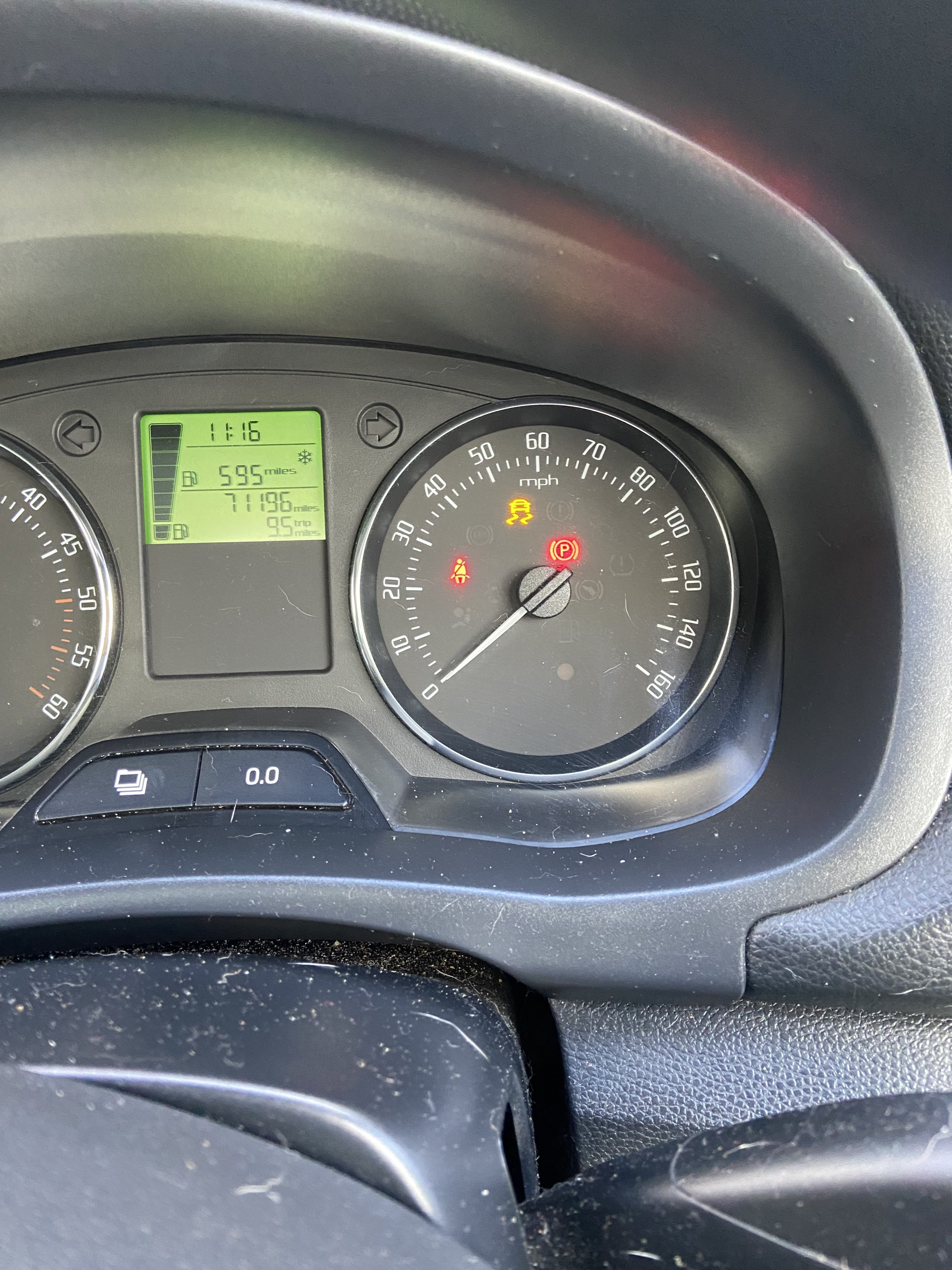

  3. Hi thanks for the reply. I asked auto electrician to check the battery and it was ok but will pass your comment on thank you. Could it be the battery in the key fob playing up? Cheers
