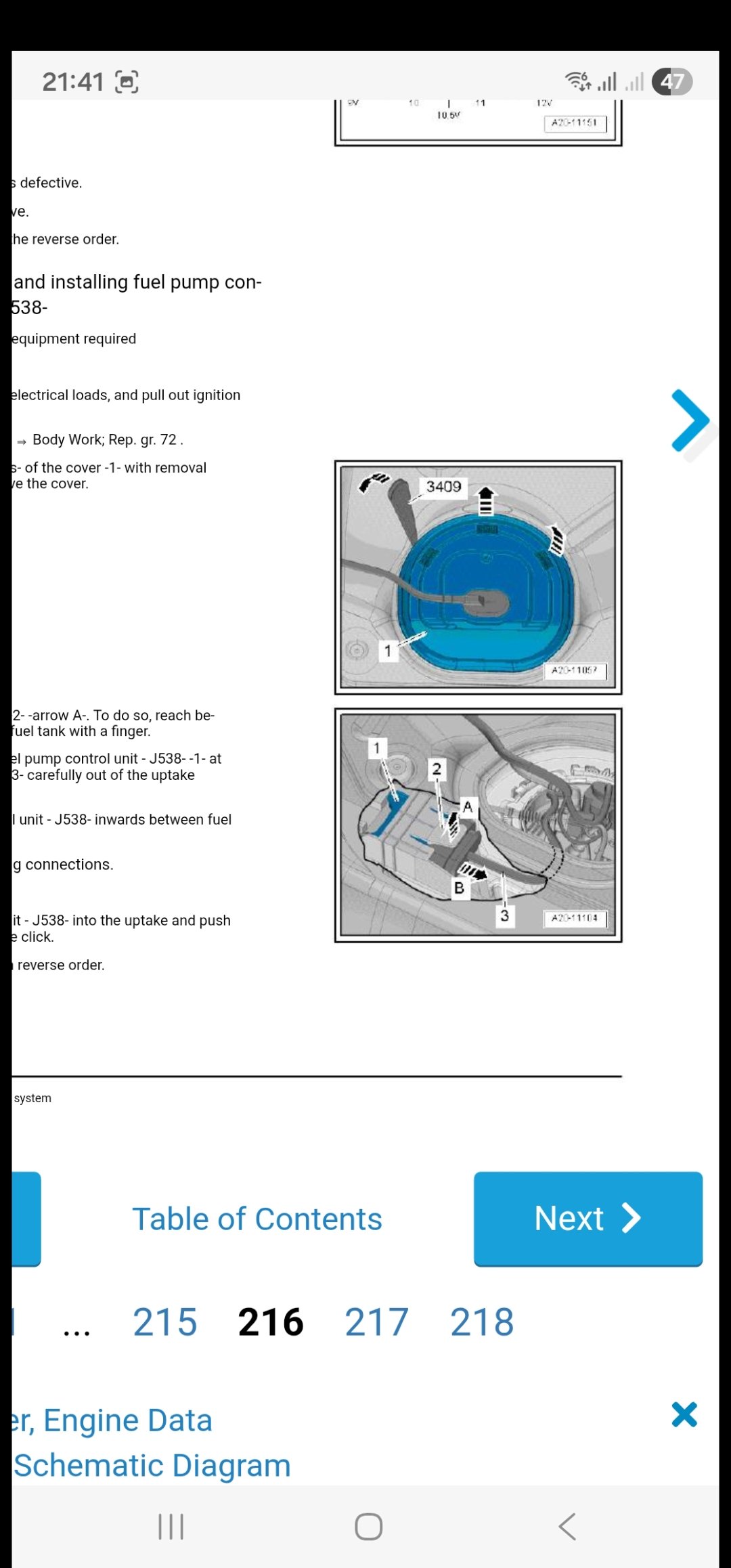

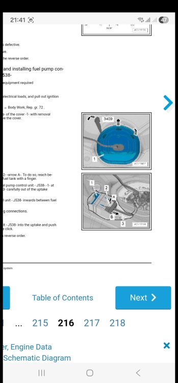

  1. I've literally just replaced mine today. Rear bench remove. Drivers side inspection cover out. Then look in from the passenger side and lay down where the bench seat would be and you'll see it underneath the metal that the rear bench sits on towards the driver's side rear door
