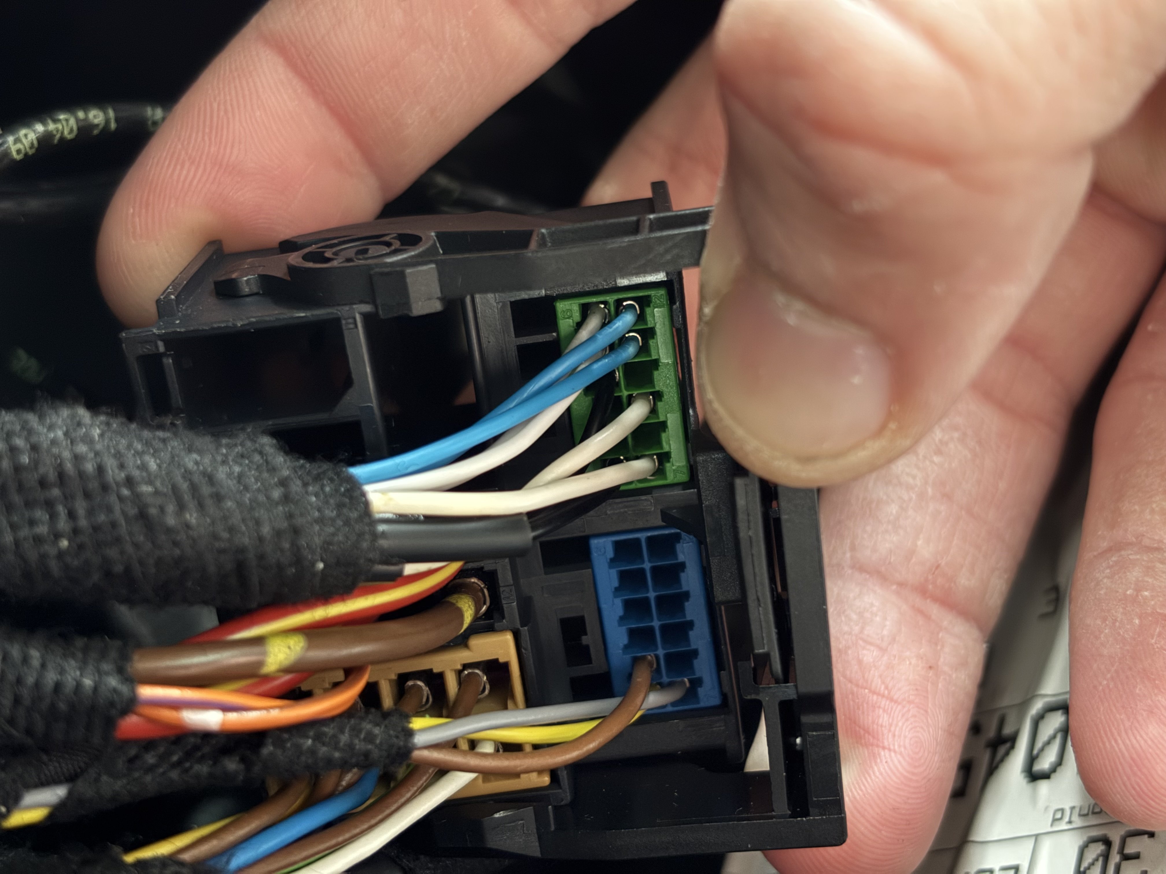

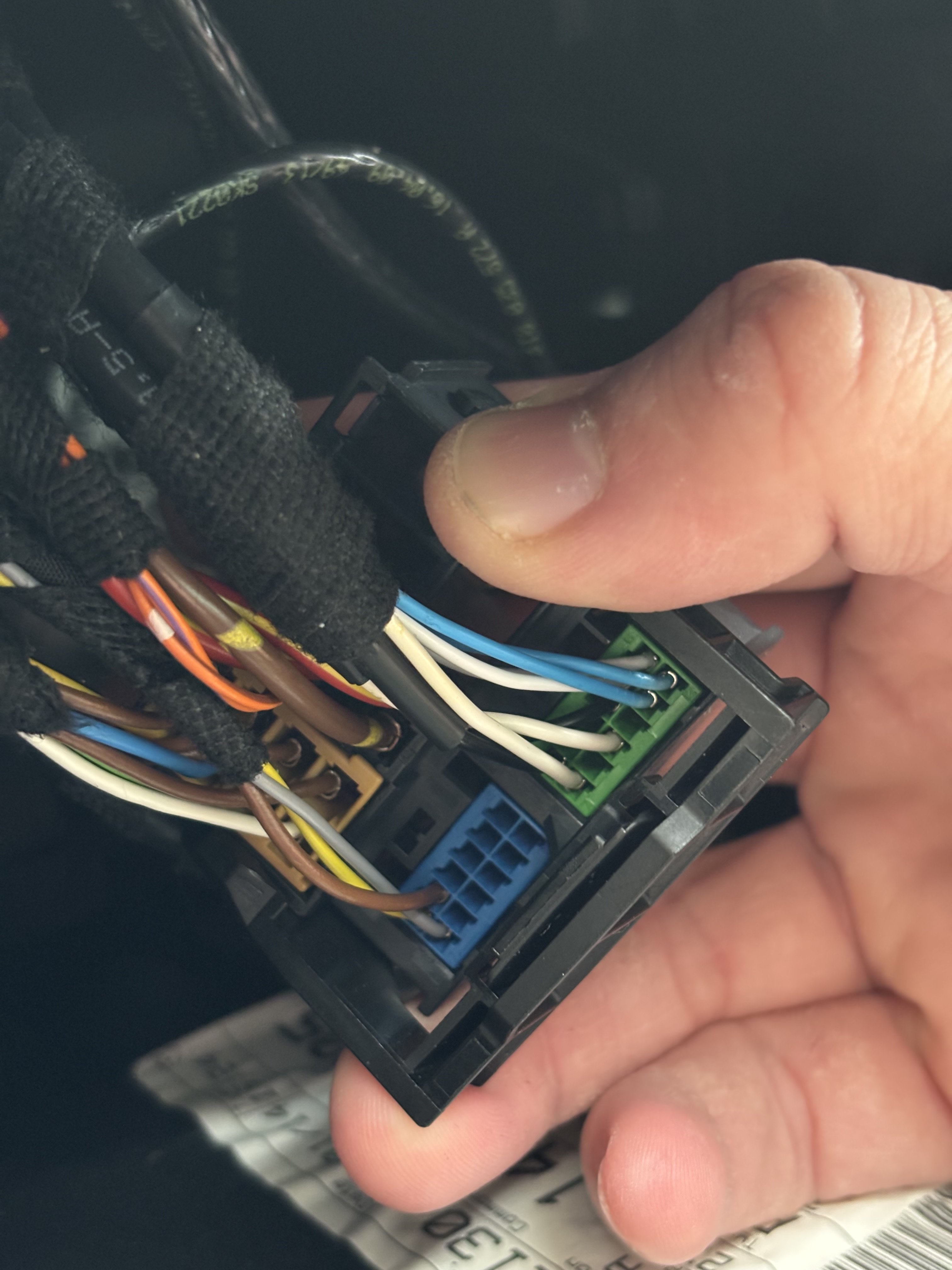

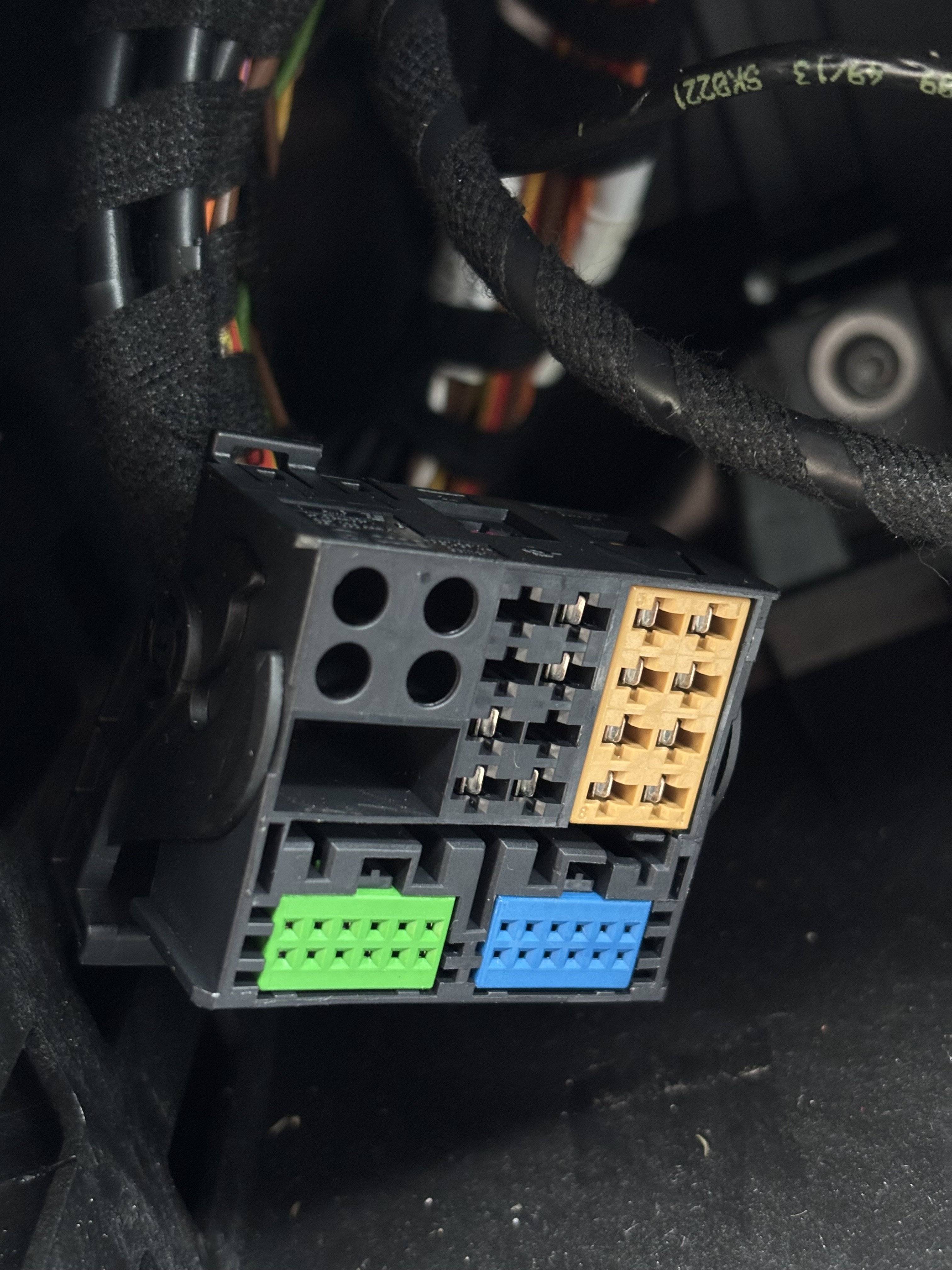

So if I get two cables and put them into the holes from the old quad lock side then put them in the correct places on the new quad lock it’ll work? The issue is I don’t have the blue or green connector for this. The quad lock just has two empty slots where they are. Am I misunderstanding this? Is there maybe a different harness I can buy?

Hi, that’s great news thank you so much! So would I have to buy the connectors for the harness and then take the wires out of the old quad lock and put them into connectors and then into the holes in the new quad lock on the harness? This is the one we bought, I’m pretty sure it’s the same as the one on eBay (that one got cancelled)

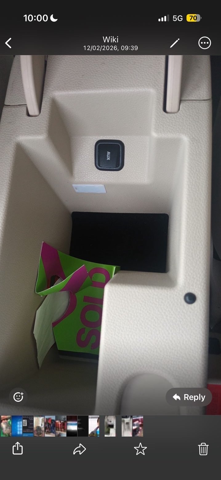

Alright, thank you! One last question. Does replacing the Aux in the armrest require removing the center console as I’m not sure I want to do all that, so I may wire the usb/aux port I get to the glovebox if that is the case. Also, is the wiring for the aux port the same as what I would use for the usb aux port or will I have to wire from the armrest to the new unit?

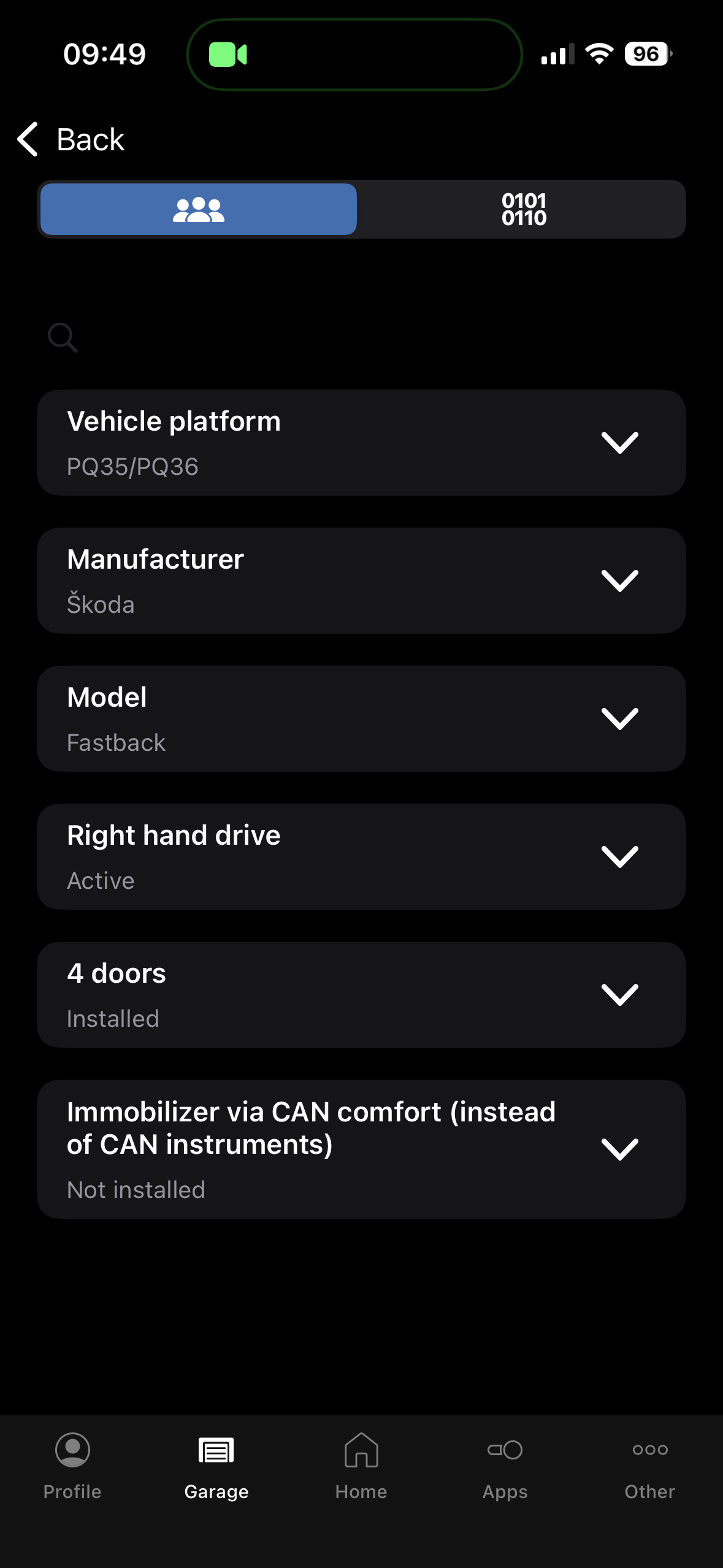

Thank you, I have informed the seller. Is the plastic piece you’re talking about inside the cavity after I remove the unit? Also removing address 37, in the gateway long coding page on obdeleven I only have these options (in screenshot). Here is the code as well: 35 33 03 I do have module 37 listed as navigation in control units though.

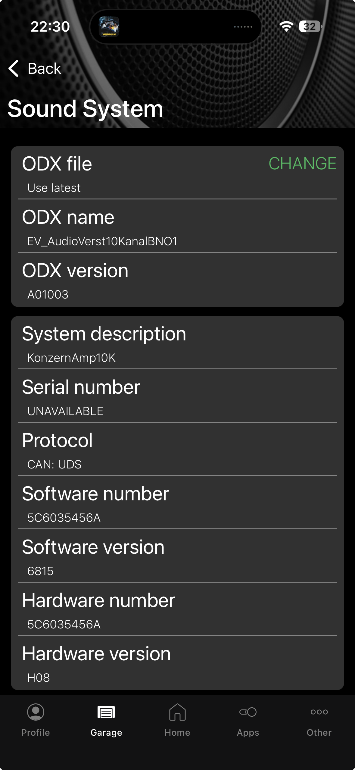

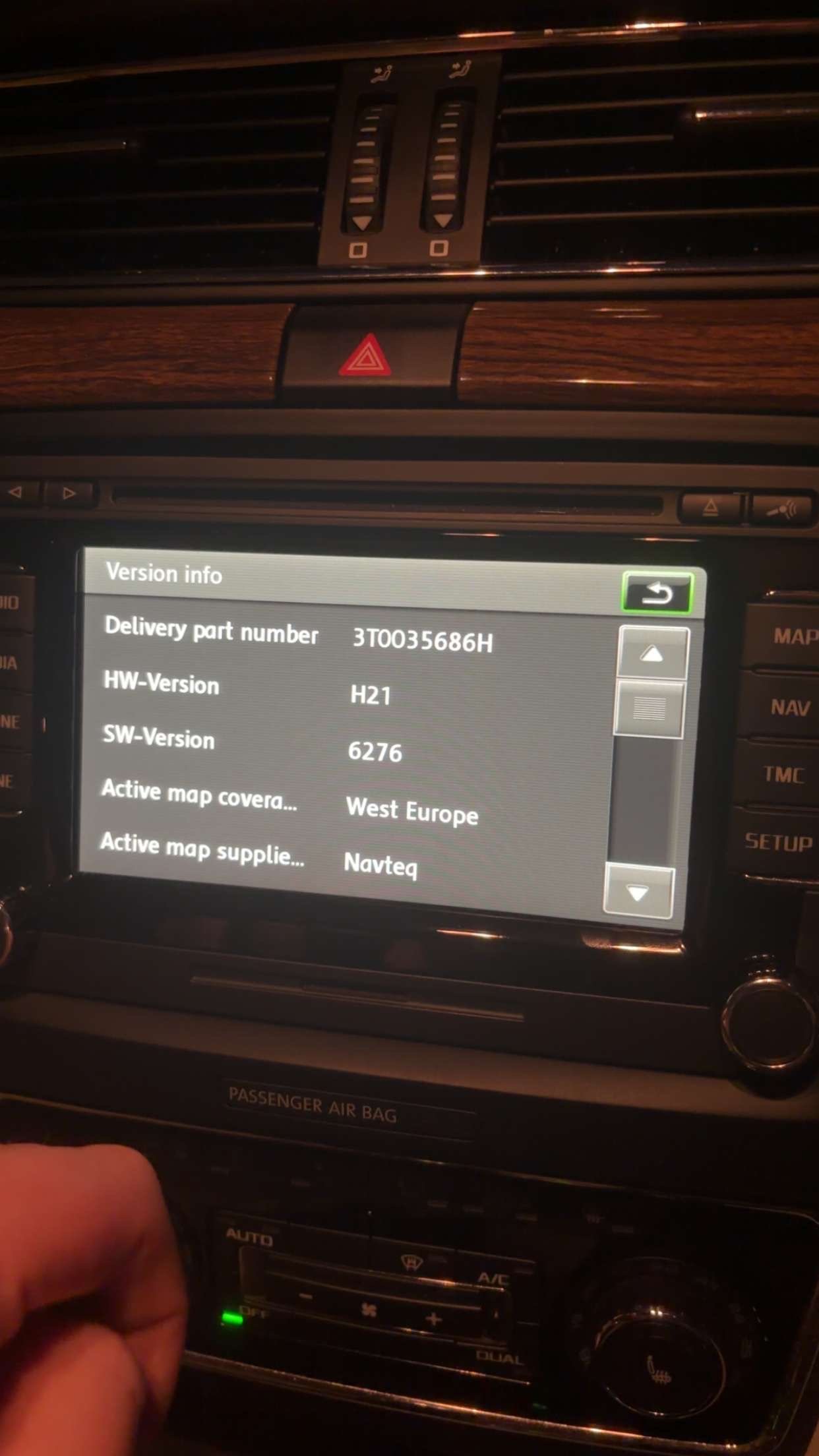

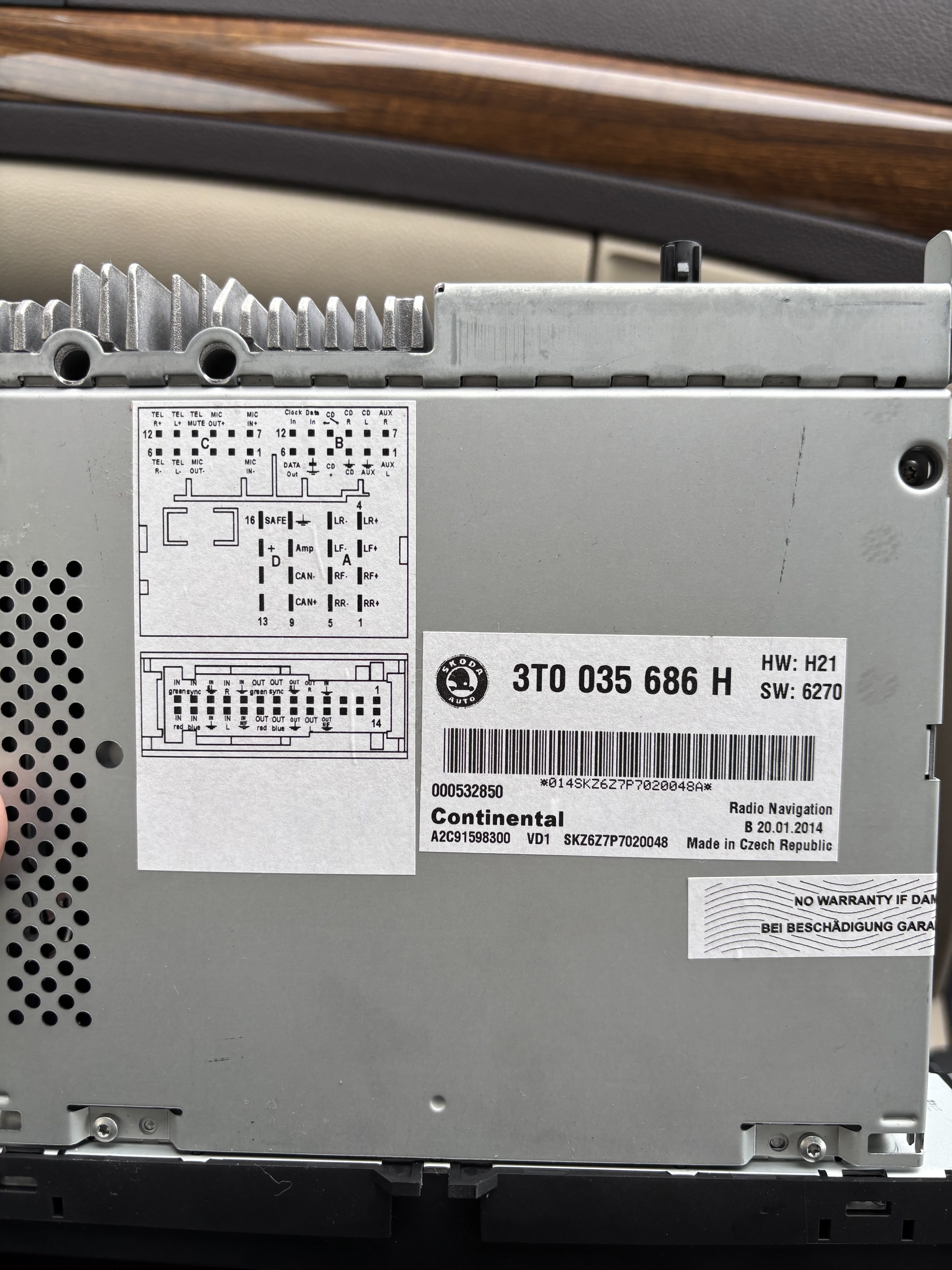

Hi, I am upgrading my friends ŠKODA superb Columbus headunit to a new one. The issue I’m having is that I’m not sure how to code it myself and I’m not sure if it has an amp or not for seller pre-coding. All he wants is a unit with CarPlay in it that is OEM. I have two here which I will link: First Second The first option is already unlocked and the person can pre code it for me, however, we are unsure if his car has the amp or not and so the seller cannot pre code it without knowing that. The second option is not unlocked so I will have to patch it (I patched my own unit in my polo but I’m not sure if this will be different) and code it which I have never done. I am also aware that we will have to buy a pq to mqb adapter, and then also buy a usb port that supports CarPlay so we can wire that in somewhere too. I would like to know if his car has the AMP and whether anyone knows what the best unit would be to upgrade his one? I have attached two pictures, the first one is his current units software, the second is the sound system details page from an obdeleven scan. The sound systems module has an ID of 47. Thank you in advance.
