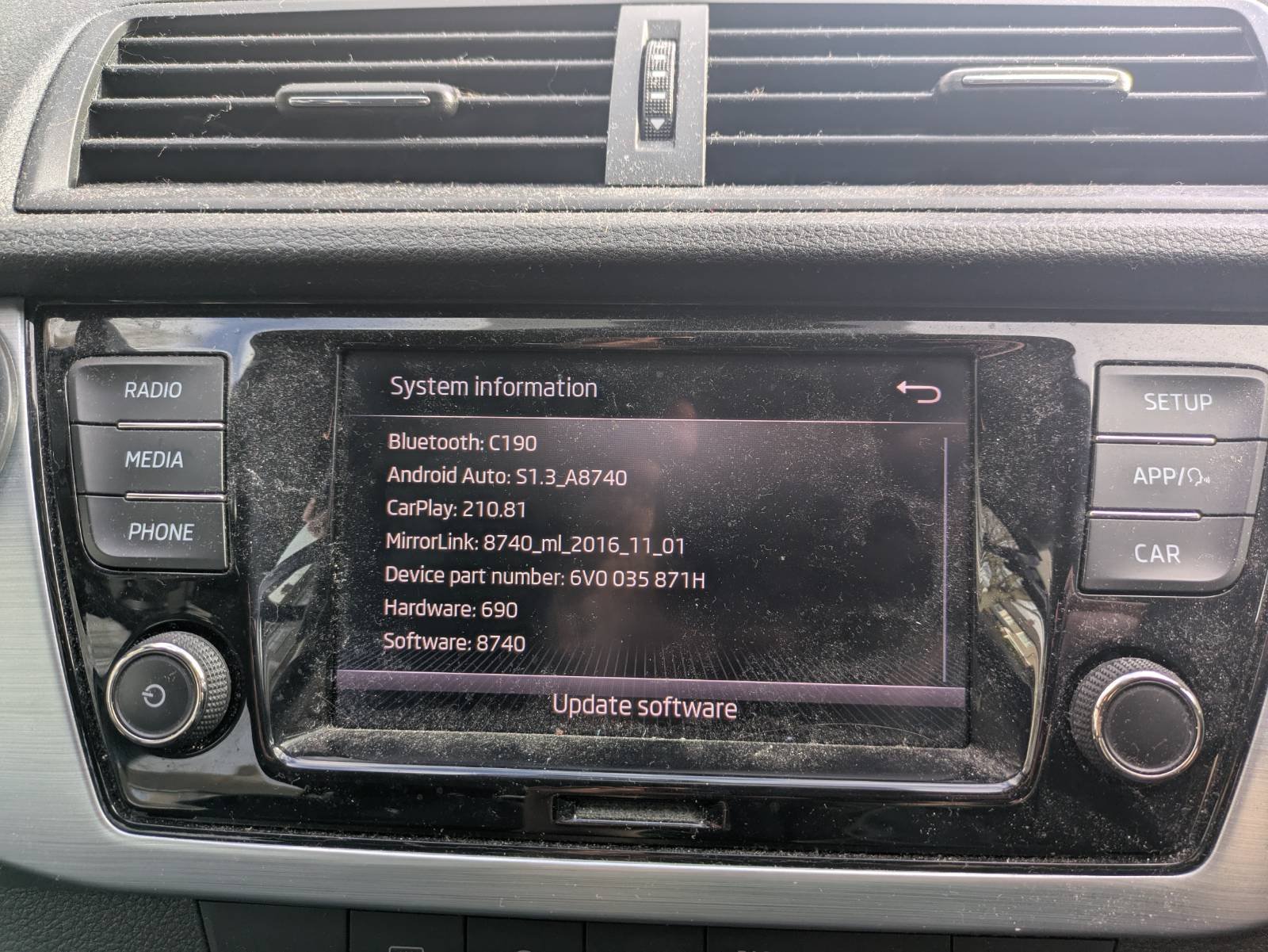

  1. Ok sounds promising! Do you know where I can find the wiring diagram for this specific infotainment unit (6VO 035 871H) to confirm whether the AUX pins exist?
  2. Hi, I have a Skoda Fabia III (2019), which has a Swing infotainment system with model number 6VO 035 871H. It does not support AUX line in (only SD card, USB and Bluetooth), and there is no AUX port next to the USB port. Is there any way I can add an AUX line in adapter to the back of the infotainment system and then enable AUX mode using OBDeleven (or some other diagnostic tool)? I'd really like to be able to use my nice MP3 player in the car, but it doesn't work over USB / Bluetooth. Here's a picture of the system I have (car needs cleaning I know!)
