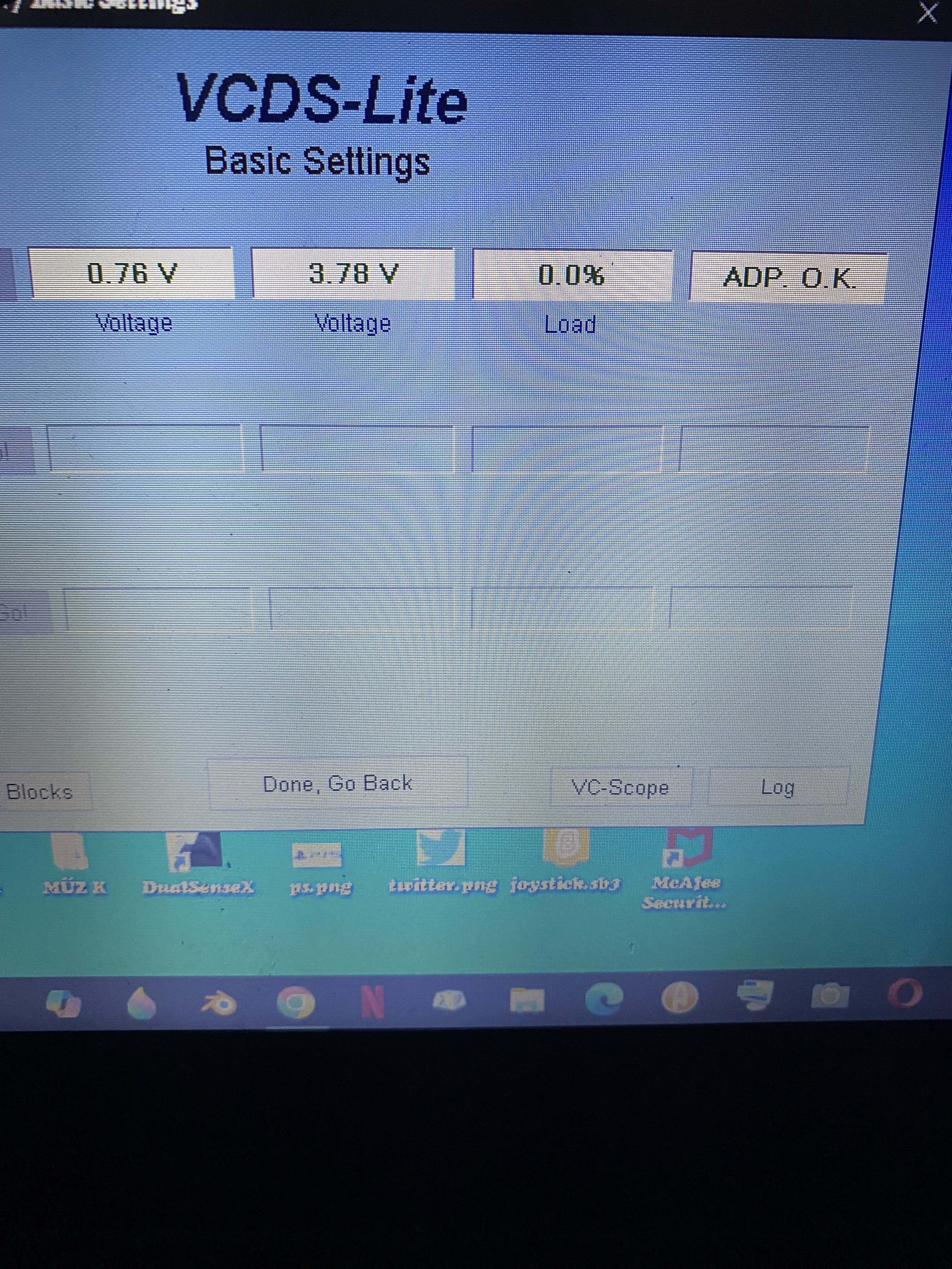

  2. Hi Pete, I apologize for bothering you. I've tried maybe 10 times, the adaptation is successful but the voltages on the screen (Vcds Lite 1.2) remain unchanged, and the adaptation is successful within 10 seconds. With the pin 6 socket plugged in and the contact open, the voltage is 0.75V. During the output test, it fluctuates between 0.80-3.80V with different voltages. Is it possible for the adaptation to be successful without the values on the Vcds screen changing at all, or is something going wrong? Thank you.

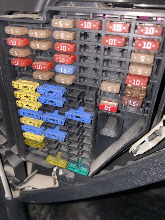

  3. Hi Pete, After changing the fuse, 12V came to Pin 1, thank you very much. Adaptation was also successful in the VCDs, even though the voltage and load values didn't change. After that, I got the P0403 error again 😔

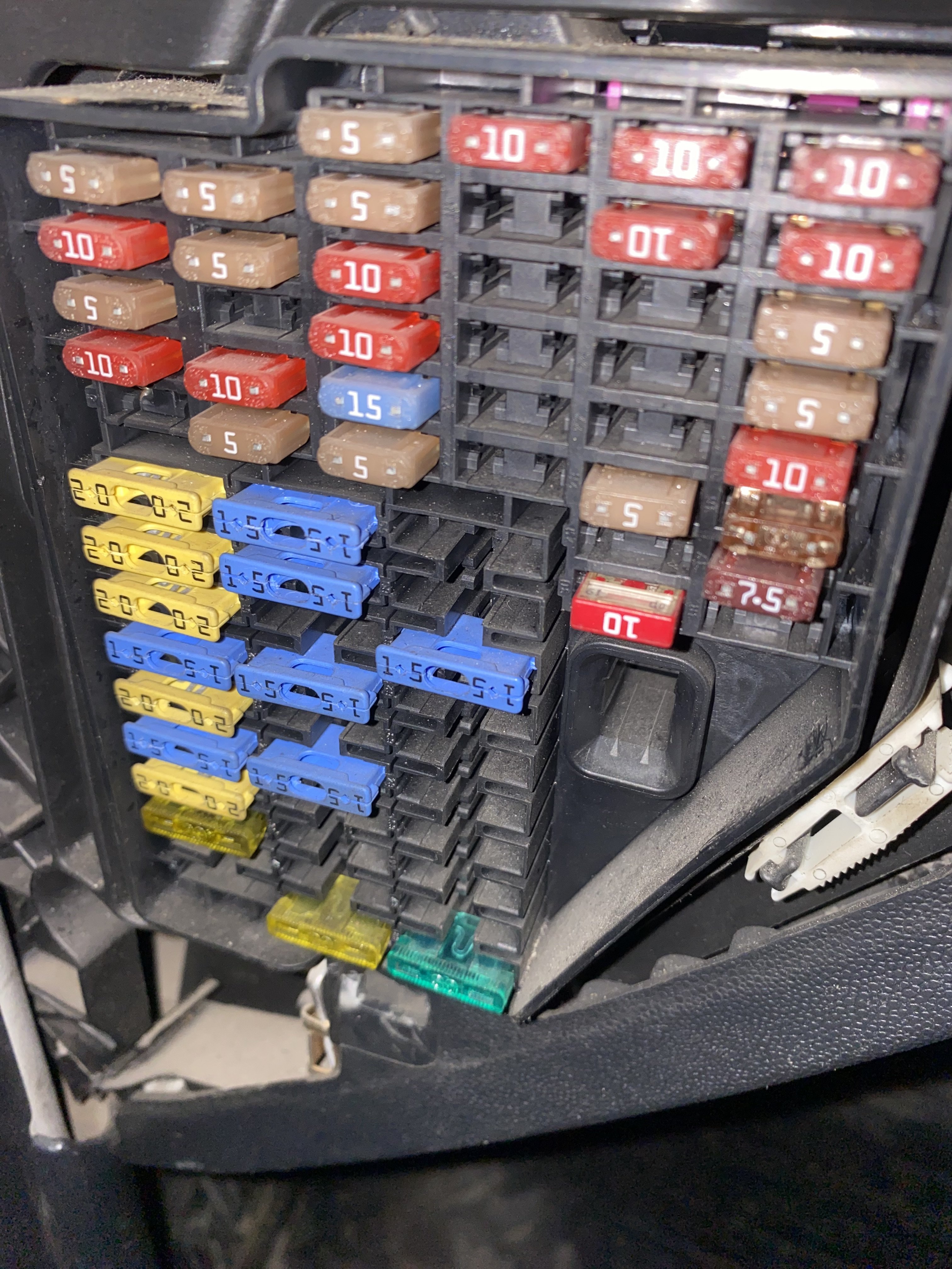

  4. Hi Pete, I've attached a photo of the fuse panel. Do you think there's a mistake? Thank you.

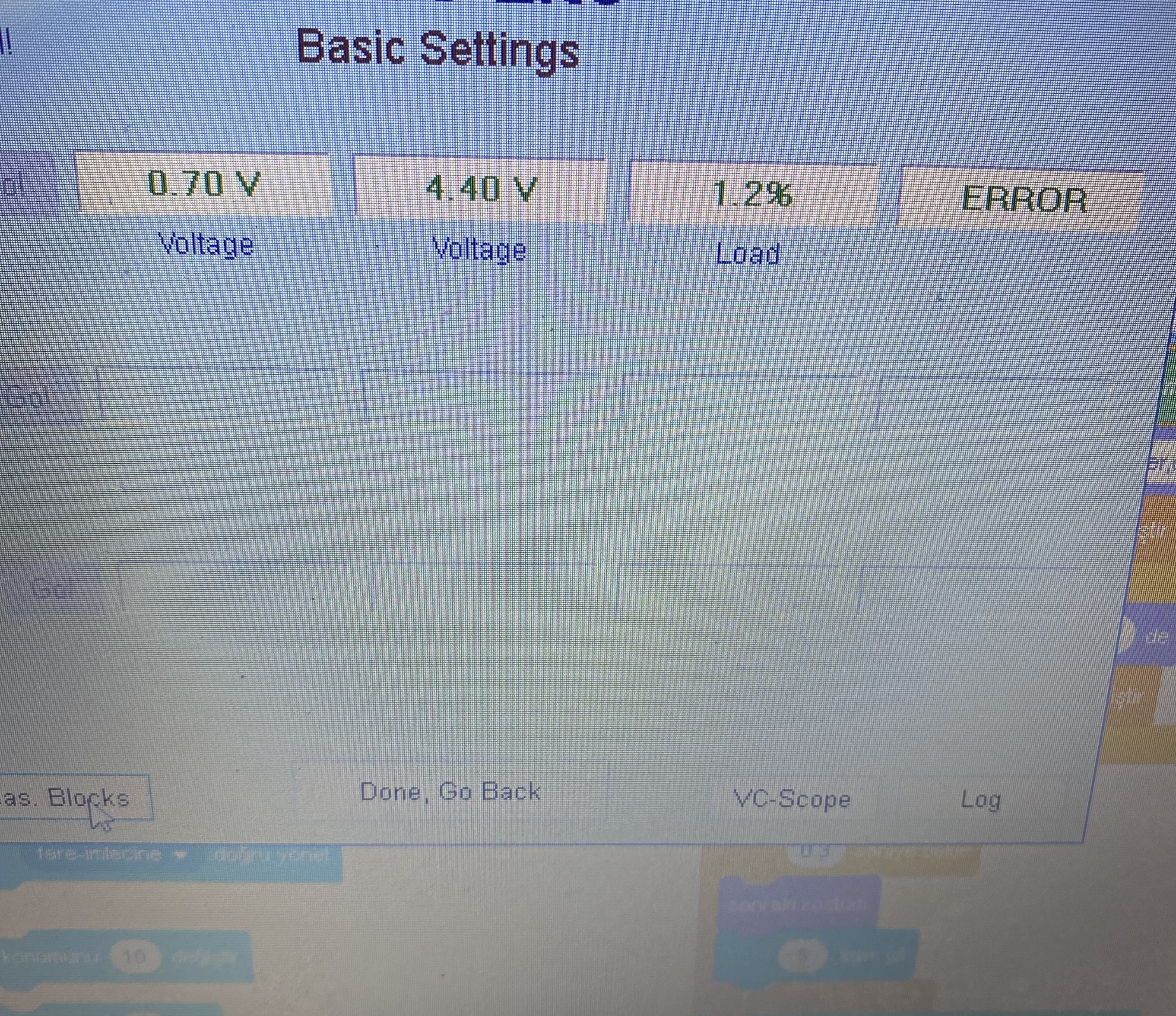

  7. Hello everyone, My car is a 2006 Fabia Classic 1.2 HTP model. Some time ago, the check engine light came on and showed a P0403 Open Circuit error. The EGR valve was first replaced with a Delphi brand one, but after 15-20 km, the P0403 error reappeared. Then it was replaced with an original Pierburg, the error code cleared, and after another 15 km, the check engine light came on again and showed the P0403 error. Measurements i took with a multimeter: With the valve not connected to the EGR socket and the ignition on, and the engine off: Pin 1: 0.24V (With the ignition on and the engine off, should I be seeing 12V here?) Pin 2: 5V Pin 3: Empty - not used Pin 4: 0V Pin 5: 4.33V Pin 6: 0V First of all, I want to ask; are these values normal? When I try to perform an adaptation in VCDs, the 0.70V values in the first box and the 4.40V values in the second box remain unchanged, resulting in an adaptation error within 5 seconds. My other question is: When the valve is not installed, and I check the pins on the ECU socket from the EGR socket, I hear a beep sound on 4 pins except for pin 1. I don't hear a sound from pin 1 on the ECU socket. Could it be normal that pin 1 isn't reaching directly the ECU? Thank you.
  8. Hello everyone, My car is a 2006 Fabia Classic 1.2 HTP model. Some time ago, the check engine light came on and showed a P0403 Open Circuit error. The EGR valve was first replaced with a Delphi brand one, but after 15-20 km, the P0403 error reappeared. Then it was replaced with an original Pierburg, the error code cleared, and after another 15 km, the check engine light came on again and showed the P0403 error. Measurements I took with a multimeter: With the valve not connected to the EGR socket and the ignition on, and the engine off: Pin 1: 0.24V Pin 2: 5V Pin 3: Empty - not used Pin 4: 0V Pin 5: 4.33V Pin 6: 0V First of all, I want to ask; are these values normal? When I try to perform an adaptation in VCDs, the 0.70V values in the first box and the 4.40V values in the second box remain unchanged, resulting in an adaptation error within 5 seconds. My other question is: When the valve is not installed, and I check the pins on the ECU socket from the EGR socket, I hear a beep sound on 4 pins except for pin 1. I don't hear a sound from pin 1 on the ECU socket. Could it be that pin 1 isn't reaching the ECU? Thank you.
