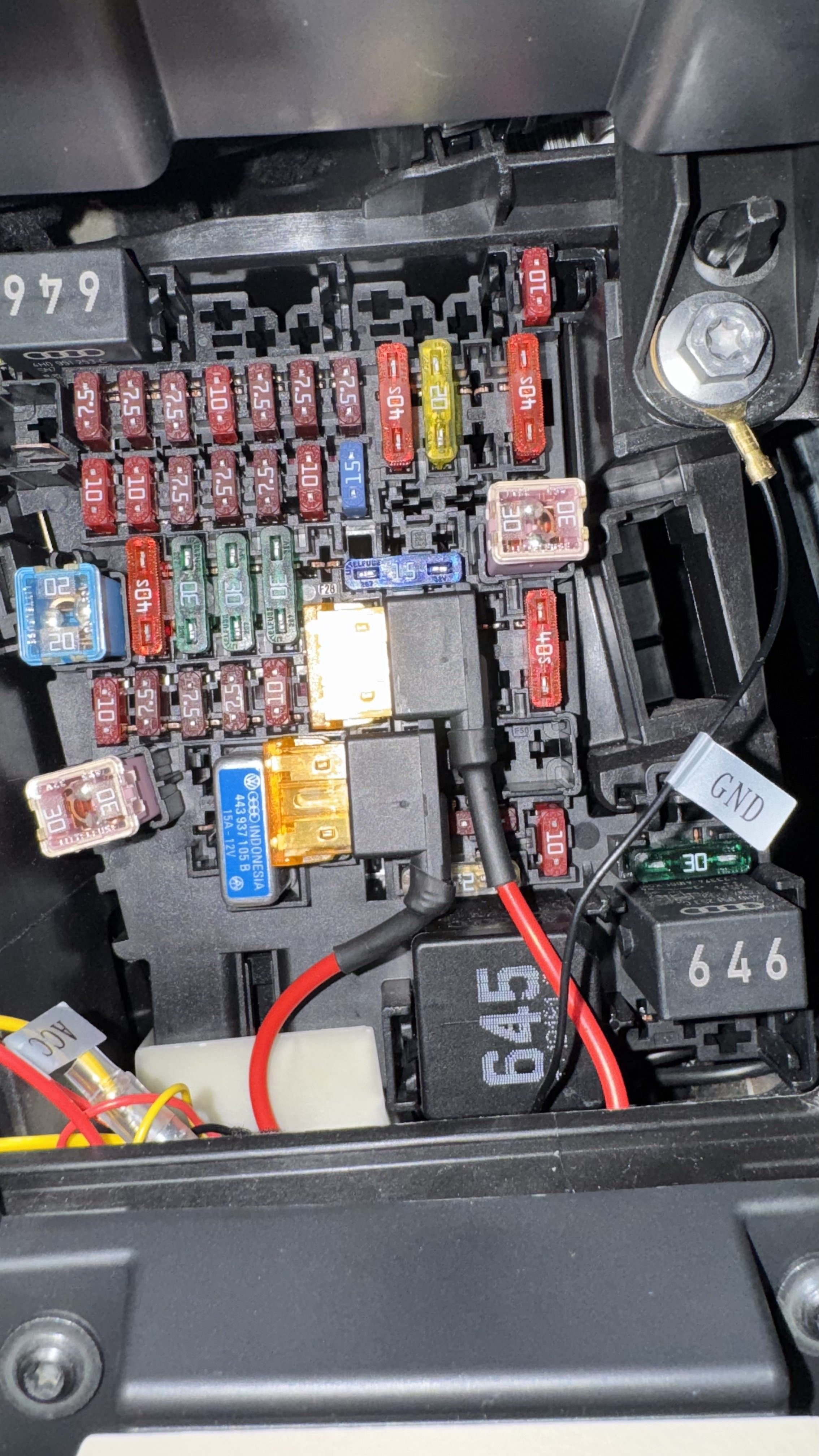

  1. Hi all, I tried using the rear wiper fuse for my dashcam, but there wasn’t enough space to fit the adapter because there’s a big fuse right next to it. Would it be okay to use ACC fuse 48 (probably the blind spot system - 20A) instead of 47? Also, slot 40 didn’t have a fuse in it, but it seems to have permanent 12V. I put a fuse tap there with a 5A fuse for the dashcam only and leave the first slot empty. Everything works fine and no errors on the dash but just want to check if this setup is okay.
