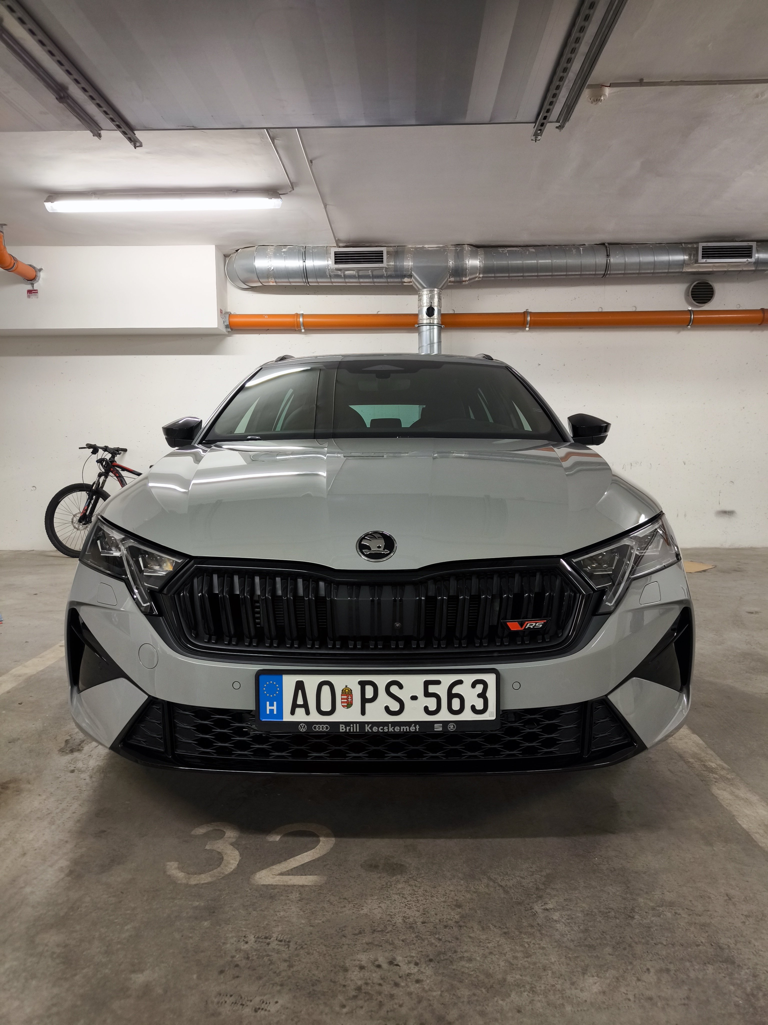

  4. Yesterday I kept investigating the issue and doing some more diagnosis by driving the car. :) The vibration is also noticeable during engine braking at certain speeds — sometimes more, sometimes less. I can feel a stronger vibration through the seat, while the steering wheel only has a very slight vibration (it does not shake, it just vibrates slightly). It occurs in the same way during engine braking as it does during acceleration, so I would rule out the drivetrain, engine mounts, or the driveshaft, although I’m not an expert. It is probably most noticeable around 140 km/h. Below 110 km/h and above 150 km/h, it disappears. I checked the tyre pressures, and at the moment my main suspicion is wheel balancing. I have booked an appointment for next week at a local tyre shop with very good reviews, since the reviews of the official service were not too promising. I’ll keep you posted — maybe my case will help others here as well.
