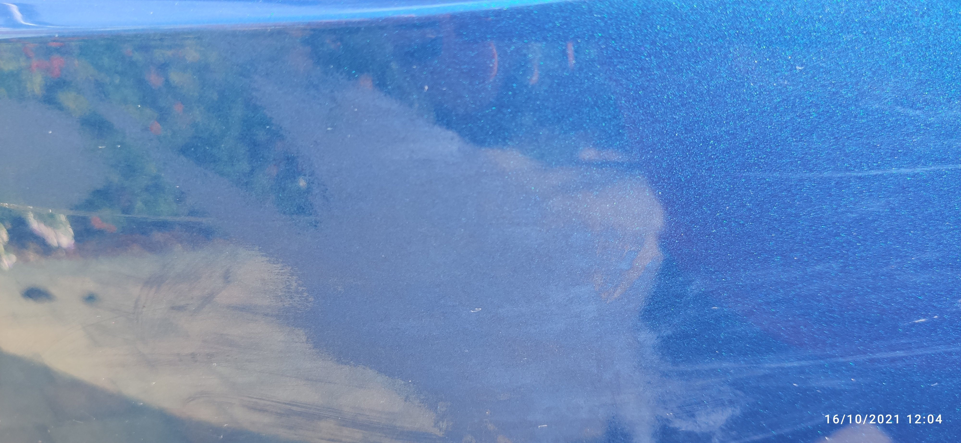

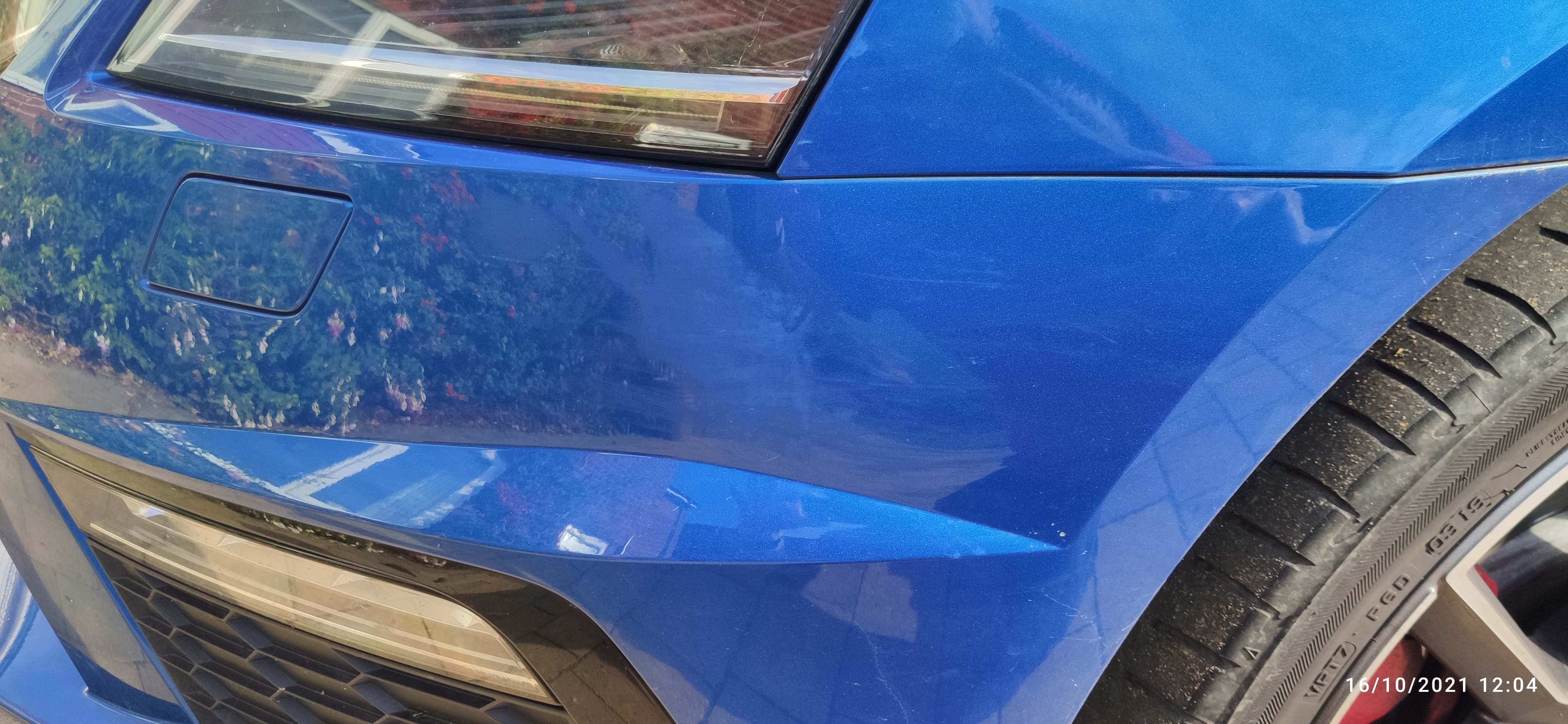

  1. Thanks for the tip about spraying it. I sprayed it with WD40 and it looked like the mark had disappeared completely. I left it to dry and it still looks as if it has gone. But when wiped off, the mark returned. Does this mean that I can put something else on it that will remove the mark permanently? If so, I would be very grateful for suggestions.
  2. I have to accept that you are all probably right and something has happened without me knowing it. At least it saves me from taking it to the dealer and wasting both their and my time. I will just have to pay to have it sorted as it is not very pretty
  3. Thanks for this. I haven't cleaned it for months and I haven't been anywhere where someone could have had the time do anything like scuff it and then try to clean it up. It has been on my drive or I've been driving it almost all the time. It has been parked in car parks occasionally, but it is almost incredible that someone would try to clear up a scuff, surely they would just drive off? Oh well, it looks as if I can't demonstrate that it is a fault with the paint.
  4. Thanks for your response. Yes I have had it from new and there has been no accident or any other repair. The mark has been there for a few weeks now, I don't clean it very often and have never polished or waxed it. No-one else could have tried to repair it. I don't work and my senior management doesn't touch the car.
  5. Octavia VRS 2019, photos attached. The paint on the front nearside bumper is discoloured or it could be described as marked but not by any damage. It doesn't wipe off, there is no dent or any sign that anything has hit it or scraped it. It looks as if the paint could be faulty. Has anyone got any ideas what might have caused it and what might be done about it? It is still under warranty and I will take it in for the dealer to look at it, but i would like to forestall the inevitable reply that it is not a manufacturing fault and instead it must be my fault! All help and advice gratefully received
