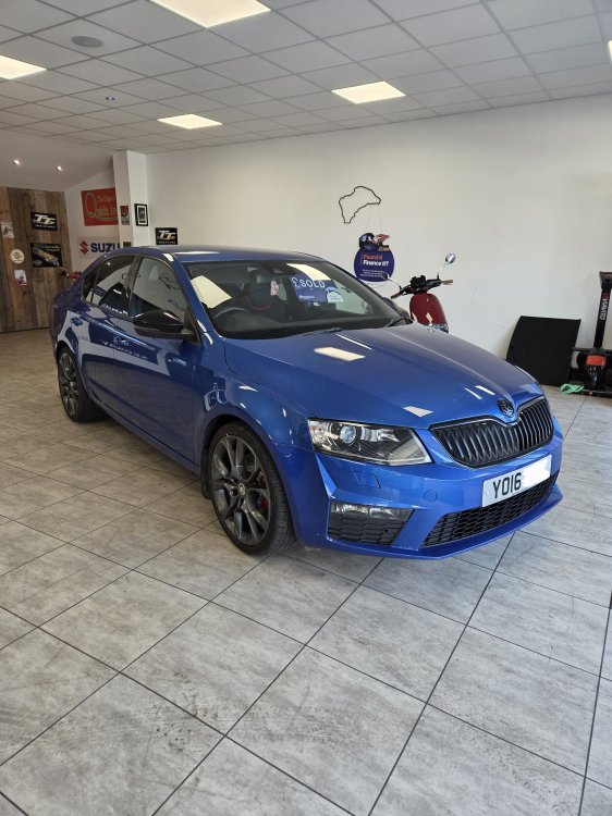

I know people are probably getting bored of this topic, but Skoda's are new to me, I certainly didn't expect VW group of all manufacturers to have this sort of problem. Especially with an engineering defect like this. Anyway, I bought my 2016 Octavia VRS a couple of weeks ago, I saw it on the forecourt and immediately knew that I wanted it. Usually, I research common faults before buying cars, but thinking Skoda was a reliable manufacturer, I took the plunge. It was only after I bought the car I found out about the dreaded CUPA/CUNA oil consumption issue. And, I am in fact using more oil than id like. Around 1/4 of the dipstick gauge in 100 miles, so probably 1 litre of oil per 500 miles? I did come across a thread on here, which said that they used Liqui Moly engine flush, then filled with Ravenol SVMP 5w30 oil, with a Liqui Moly Cera-tec additive. As well as, just using a different oil, Liqui Moly 4200 5w30 oil. Can anyone confirm this actually works, from personal experience? Is it as simple as using a better quality oil, (or at least better option of oil for this particular engine), especially at the milage these cars are at now? Assuming all other components are in serviceable condition, DPF not blocked, EGR not clogged, turbo seals not blown etc. I have contacted the garage I bought the car from, but id like to know for future servicing reference, that is if I keep the car. Thanks all.
