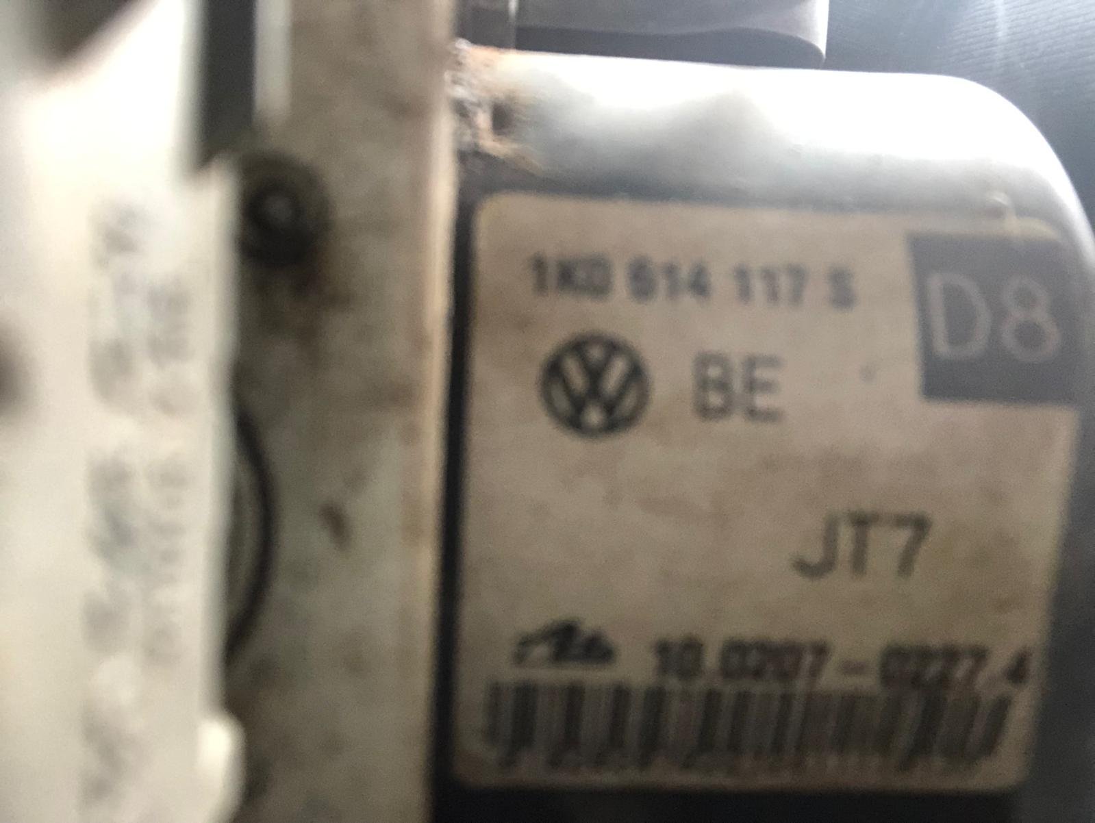

  1. Thanks, I don’t have any means to coding it unfortunately - I’ve only got a basic scanner. I’m trying to avoid having to pay to get read, then re coded.
  2. Thanks, that’s what I’d thought - just wasn’t sure if that was the pump part or the whole unit. Do you think if I source a match its likely to just plug in and work without having to get it re coded?
  3. I’ve got oil leaking from the ABS unit on my Octavia 1.4 TSi. Definitely coming from the unit itself and not the pipework or connections. In order to get a replacement unit, I’ve been advised I might be able to get a recon unit that is plug-in and play - and will avoid the need for coding it - as long as the part numbers are identical. My question is which part number needs to match, to allow me to avoid coding the unit. The photo attached shows the label on the pump section. Thanks
