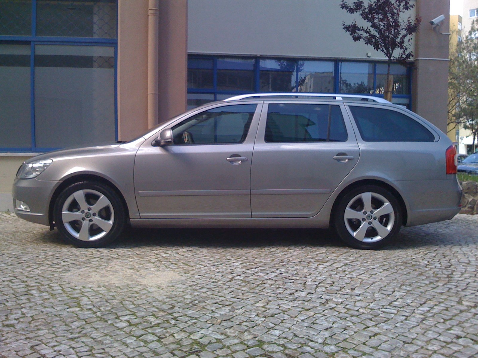

  7. Hi everyone, My name is Patrick from Lisbon/Portugal and I am the owner of a Skoda Octavia Sportline DSG from 2010. It's just a wonderfull car to drive and enjoy. ☺️
