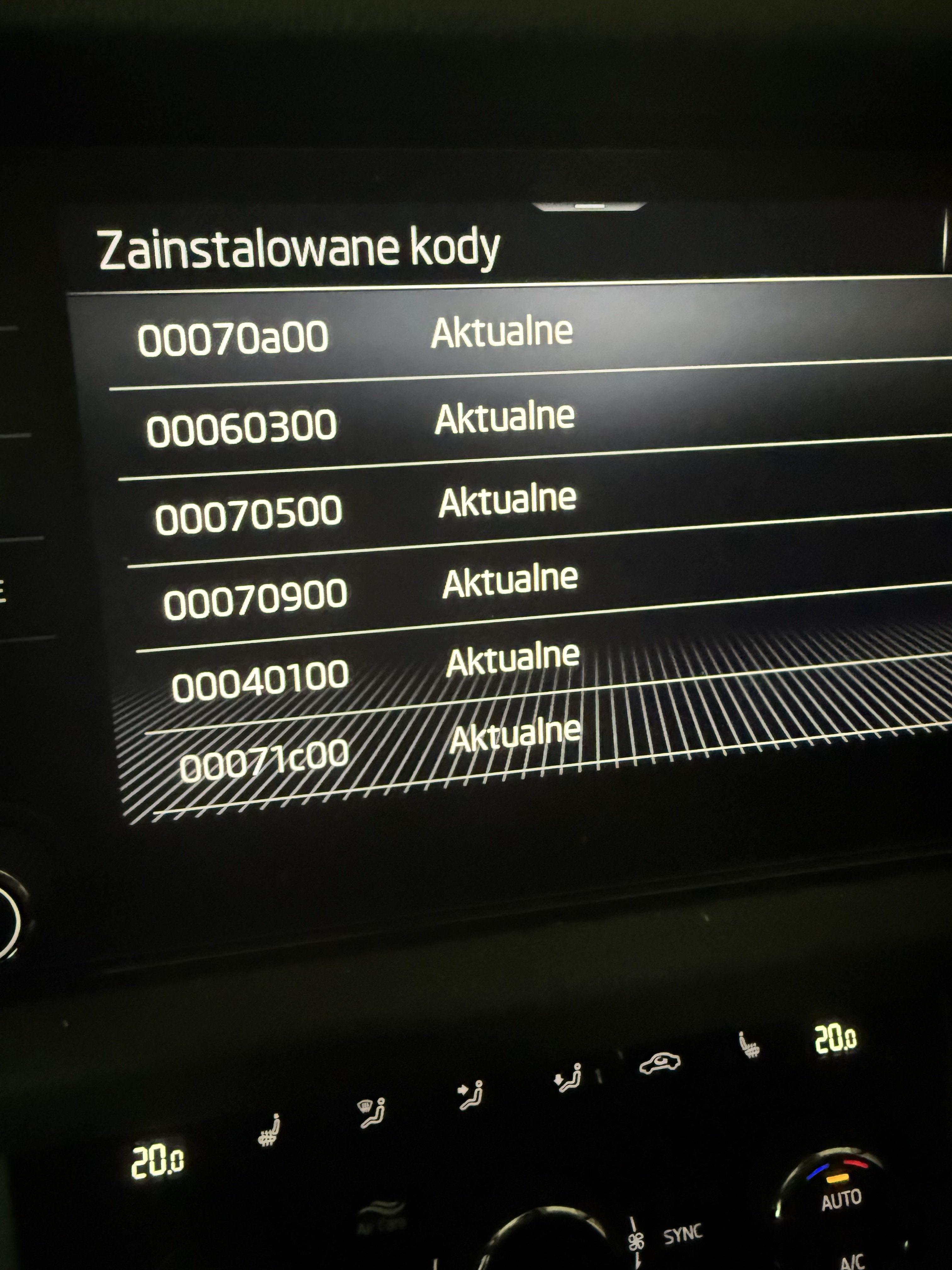

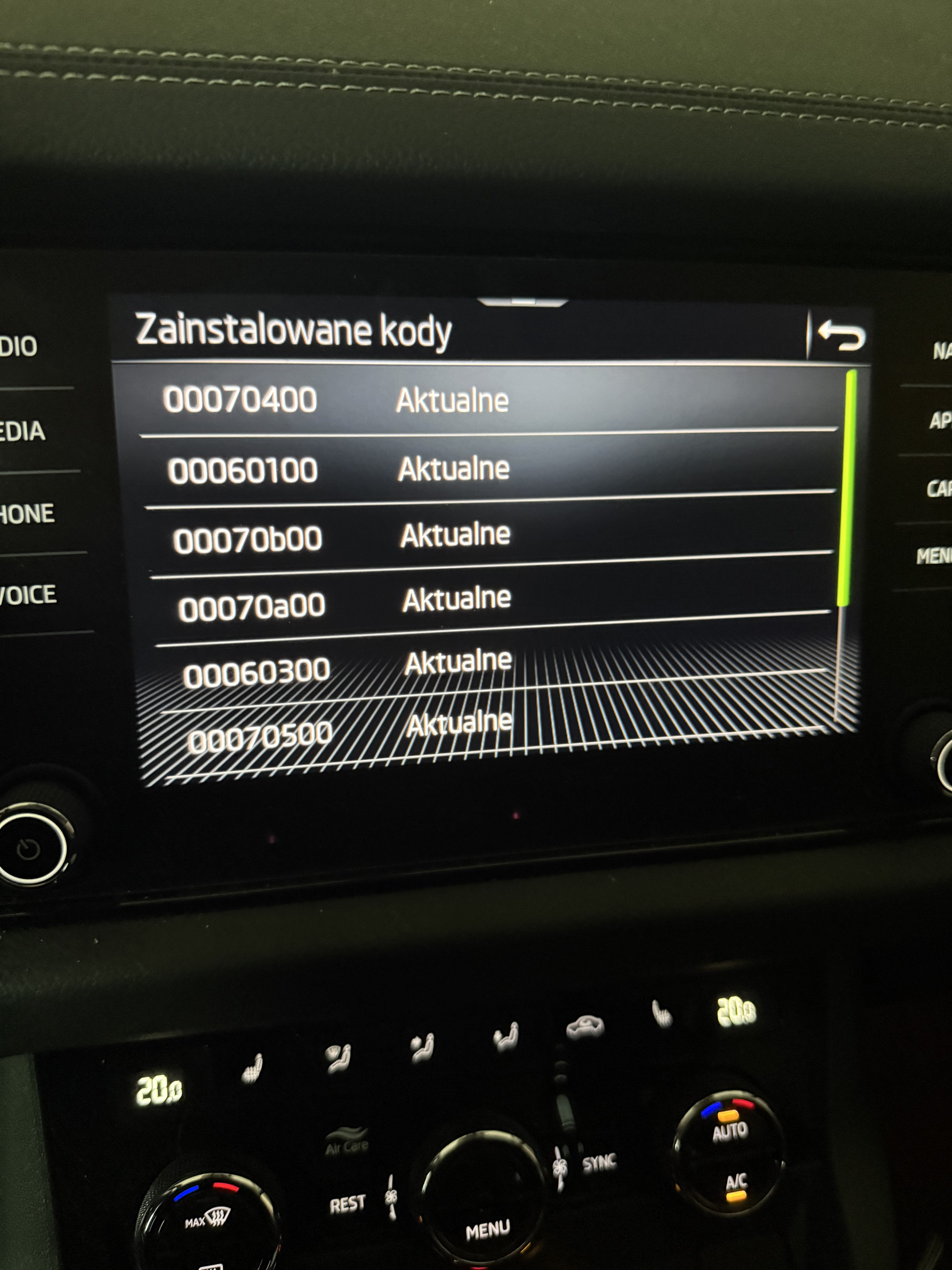

  4. @Cairus I have the following FECs valid - attached photos. 00040100 seems to be the right one for navigation.
