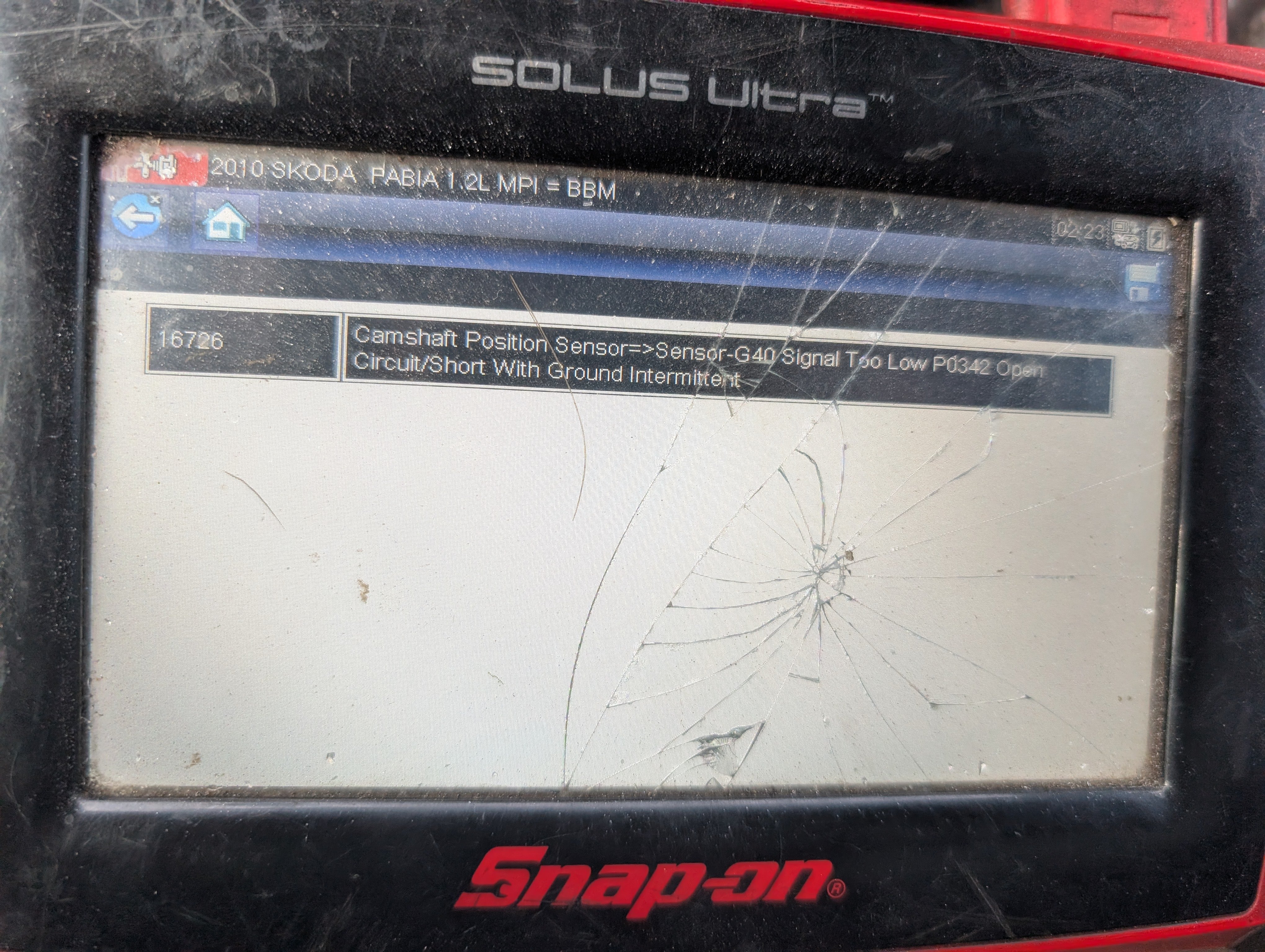

  4. Hi, car was in the garage this morning, code is still the same as the one in the picture above. It is definitely a twin cam.
  5. Spark plugs were changed over a year ago and checked on last service and were ok. (October 2025)

  7. Pretty sure it's a twin cam but will find out and reply again and with codes, I do have the original code and have attached it to this comment, this is off when it all 1st started after the camshaft sensor had been changed. The problem started over a month ago with no eml on but spinning over and not starting, then it would start. Diag comp said the same code as attached, so the sensor got changed, problem proceeded to get worse. Timing chain then changed and the eml started to appear. Can be intermittent however. Sorry I'm not much use, trying to learn the best I currently can.
