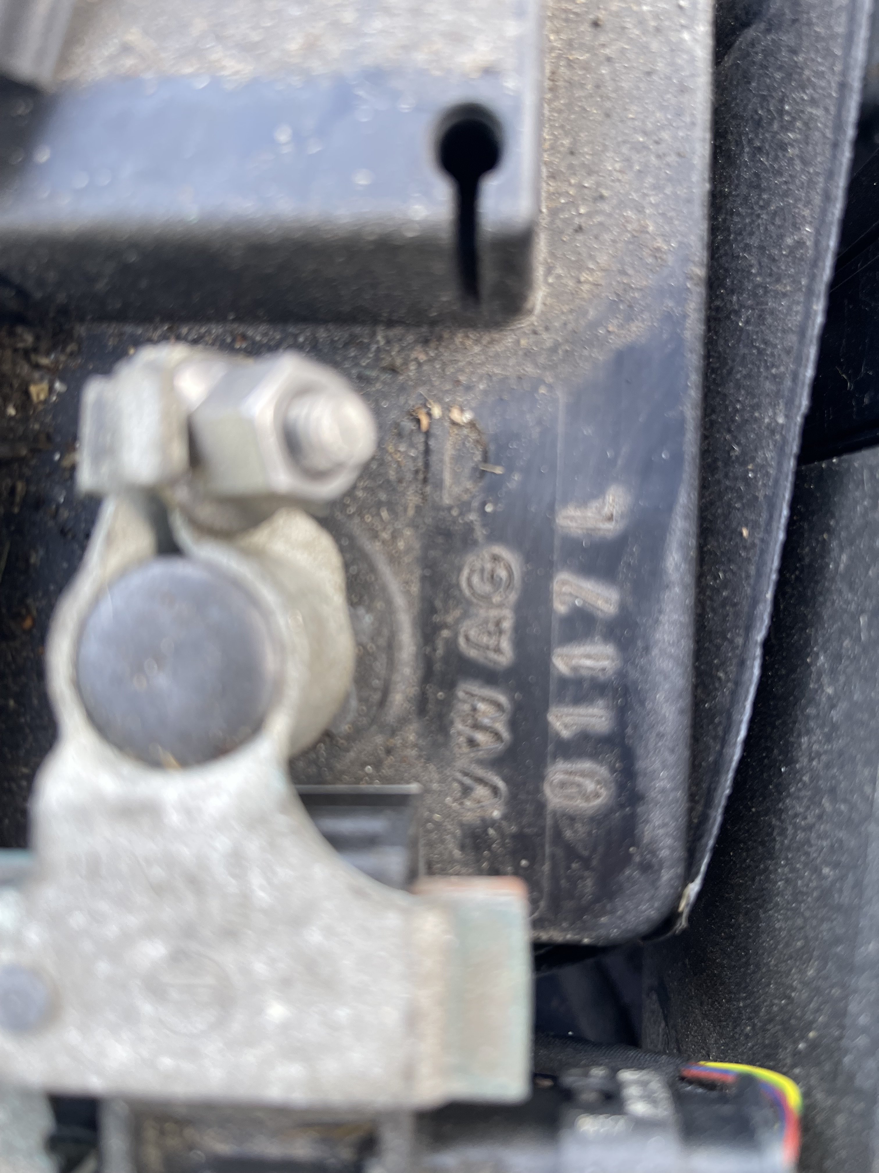

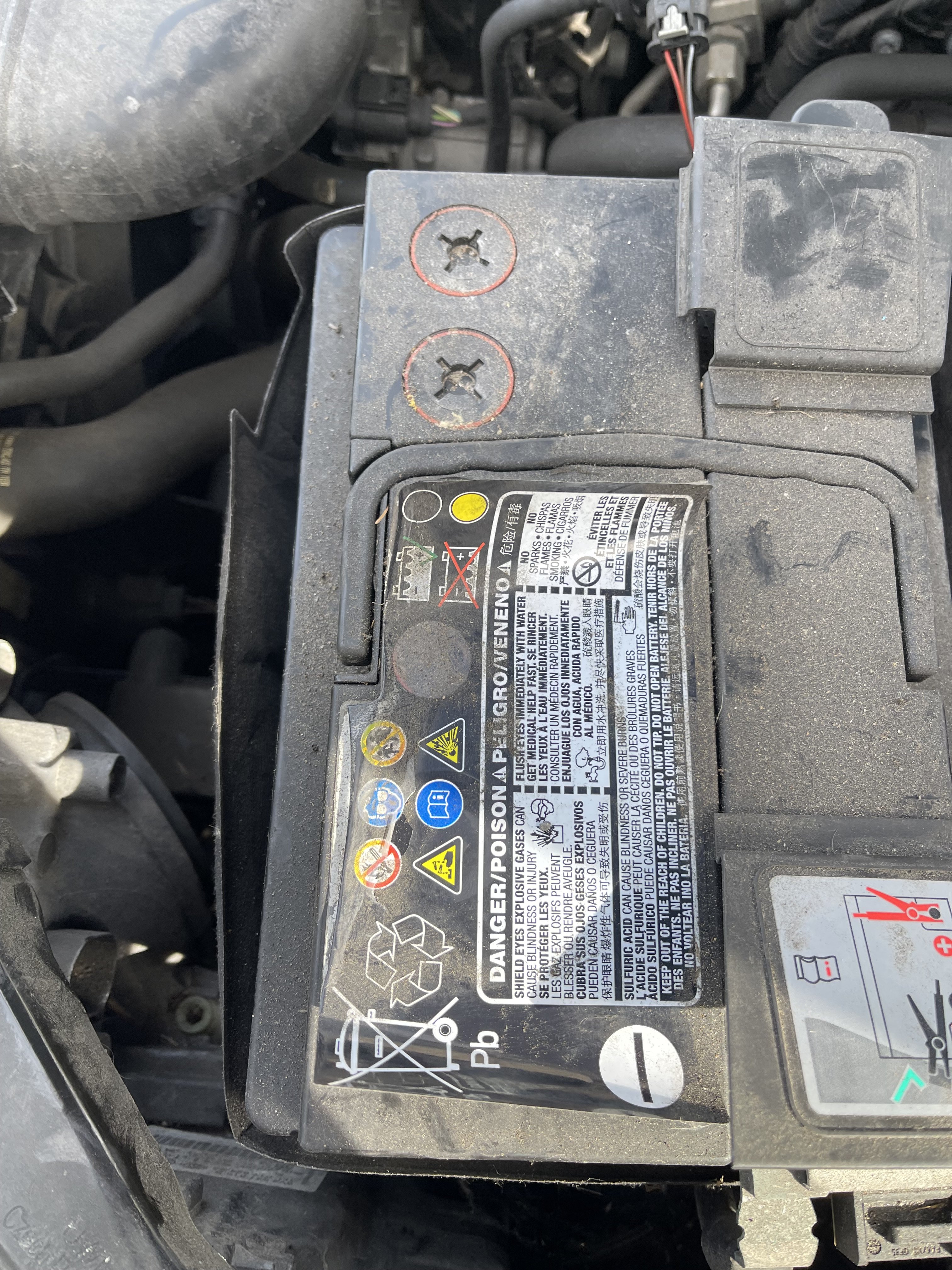

  5. I bought the car for my wife in 2020. There was only 16000 miles in it. It came with full service history . Battery has not been changed so it is the factory original battery. The VW VAG etching with 01171 also confirms this as I believe 17 means 2017 which is the year the car registered. I have been able to get a full view of all 4 sides of the battery and confirmed no labels. The parts catalog for my cars VIN listed several engines some with EFB in the description others with nothing. Battery is 9 years old and had a recent issue with battery 12v low message in the end had to push the car to get it to start. I then drove the car for 20 mins before going home. Checked it again 12v low message still there but car started immediately . Switched engine off then checked battery with digital meter it was reading 12.57v and with engine running it was 14.62v. So alternating appears to be ok and battery in ok range. Went back out to the car 20mins later and no longer any error messages. No reoccurrence of issue in last couple of days and have not done much mileage so a bit strange. Prefer to know the full spec of the battery if I decide to replace it. Want to make sure like for like battery replacement. Don’t trust the garages.
  6. How can I confirm car battery type and spec on my Skoda Fabia Mk3 TSI 90 CJZC. No labels other than Pb. However there are some etchings on the battery. VW VAG with 01171 below at the - terminal and DD52 at the + terminal. Google AI suggests it may be a Varta D52 (AGM027) made in 2017. However when I check the parts catalog using my Cars VIN on 7zap most of the batteries listed are EFB batteries with no mention of AGM. I know one option would be to buy OBD11 tool with subscription which would also enable me to register a new battery but I believe that would be a waste of money considering I am not a car mechanic so tool would be very rarely used. Looking for advice on what other options may be available.? I have uploaded a couple of pictures in case someone can identify the battery make and type.
