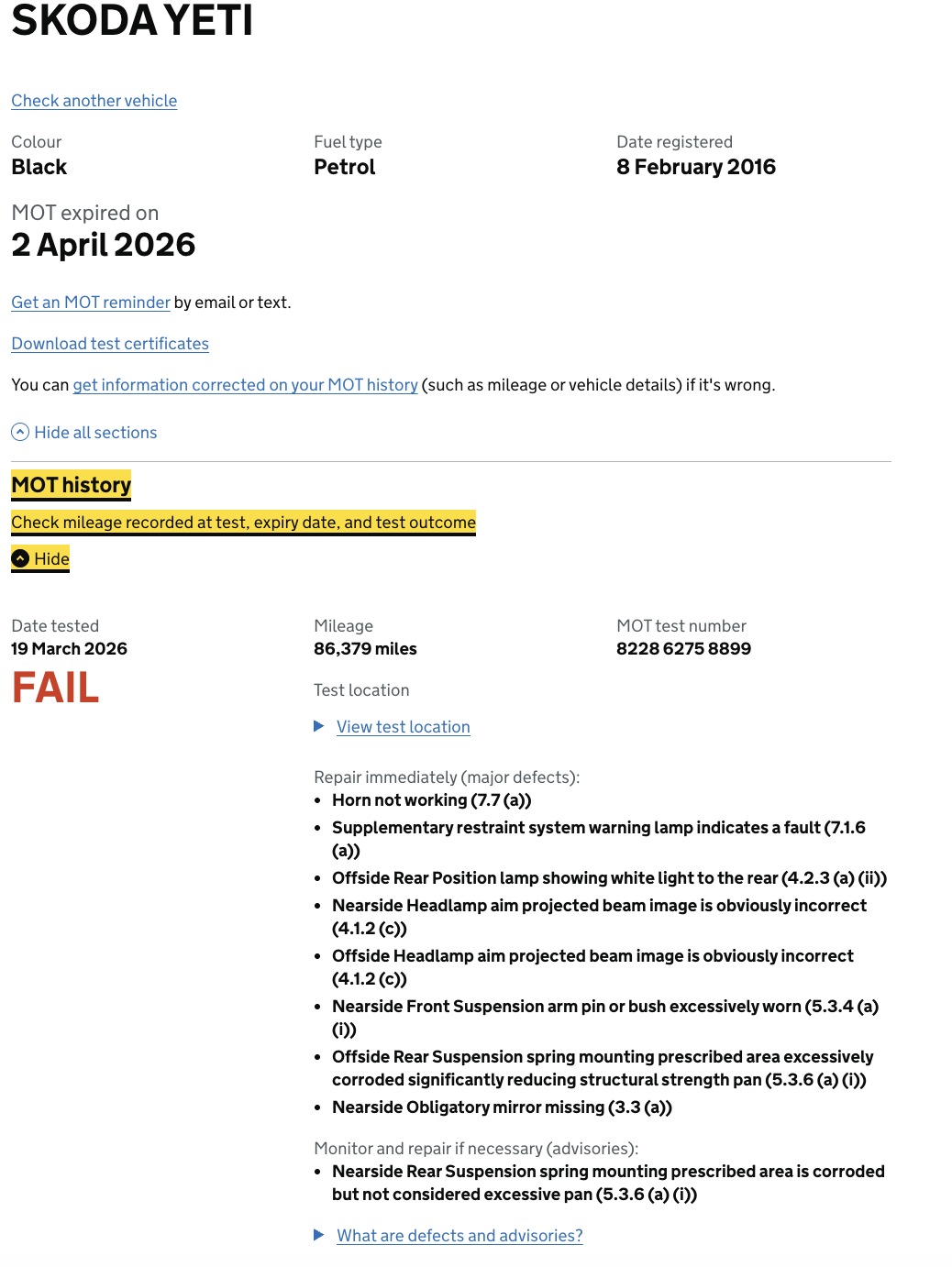

  4. Just got the service history – it had the timing belt + water pump changed in 2024 which is good, however failed its MOT recently..
  5. Thats what I thought tbh hence the check haha. Just got the service history – it had the timing belt + water pump changed in 2024 which is good, however failed its MOT recently..
