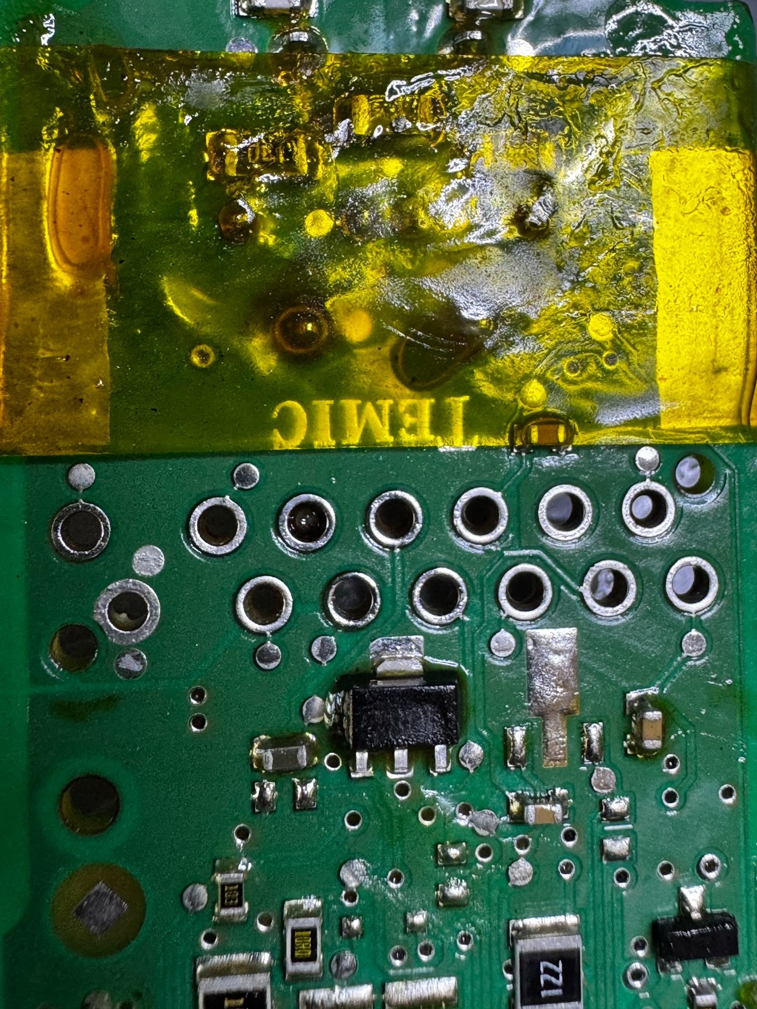

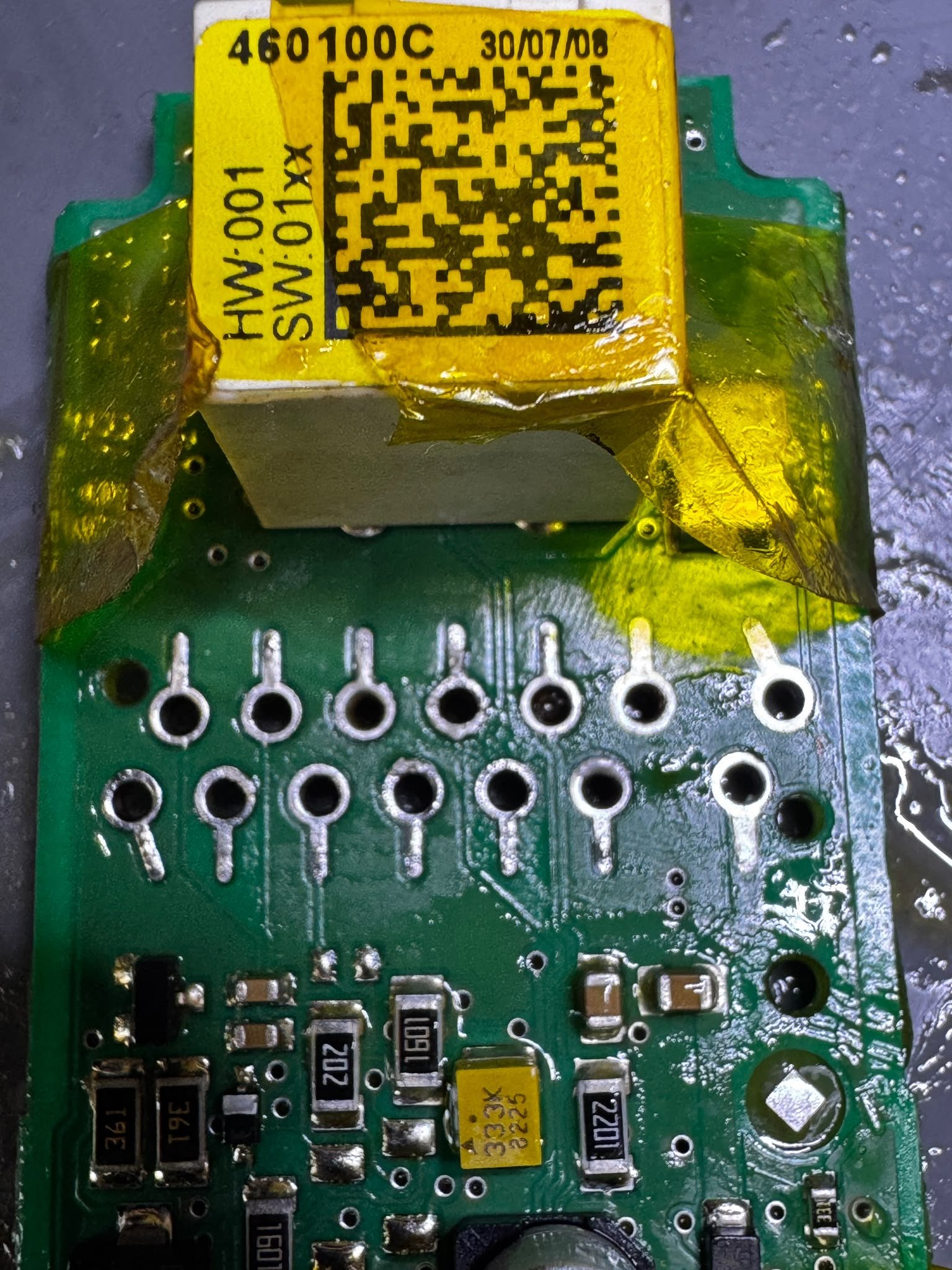

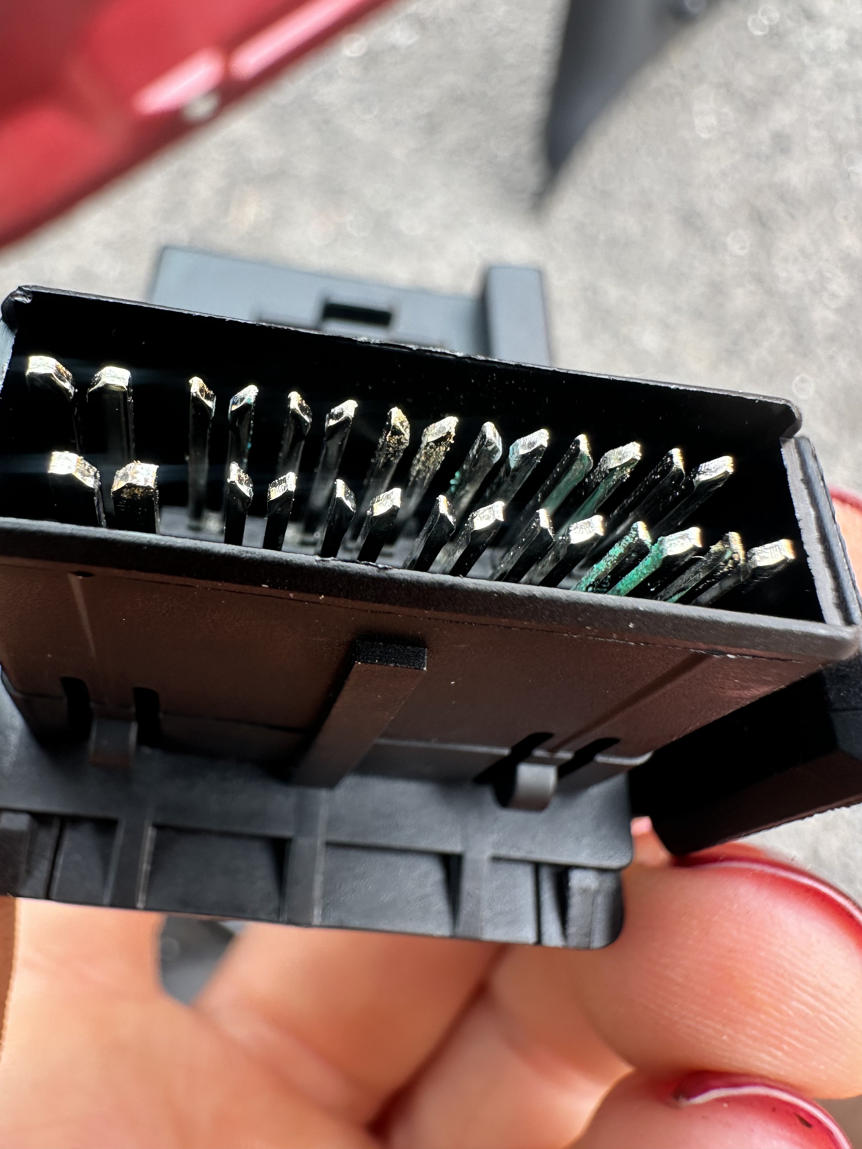

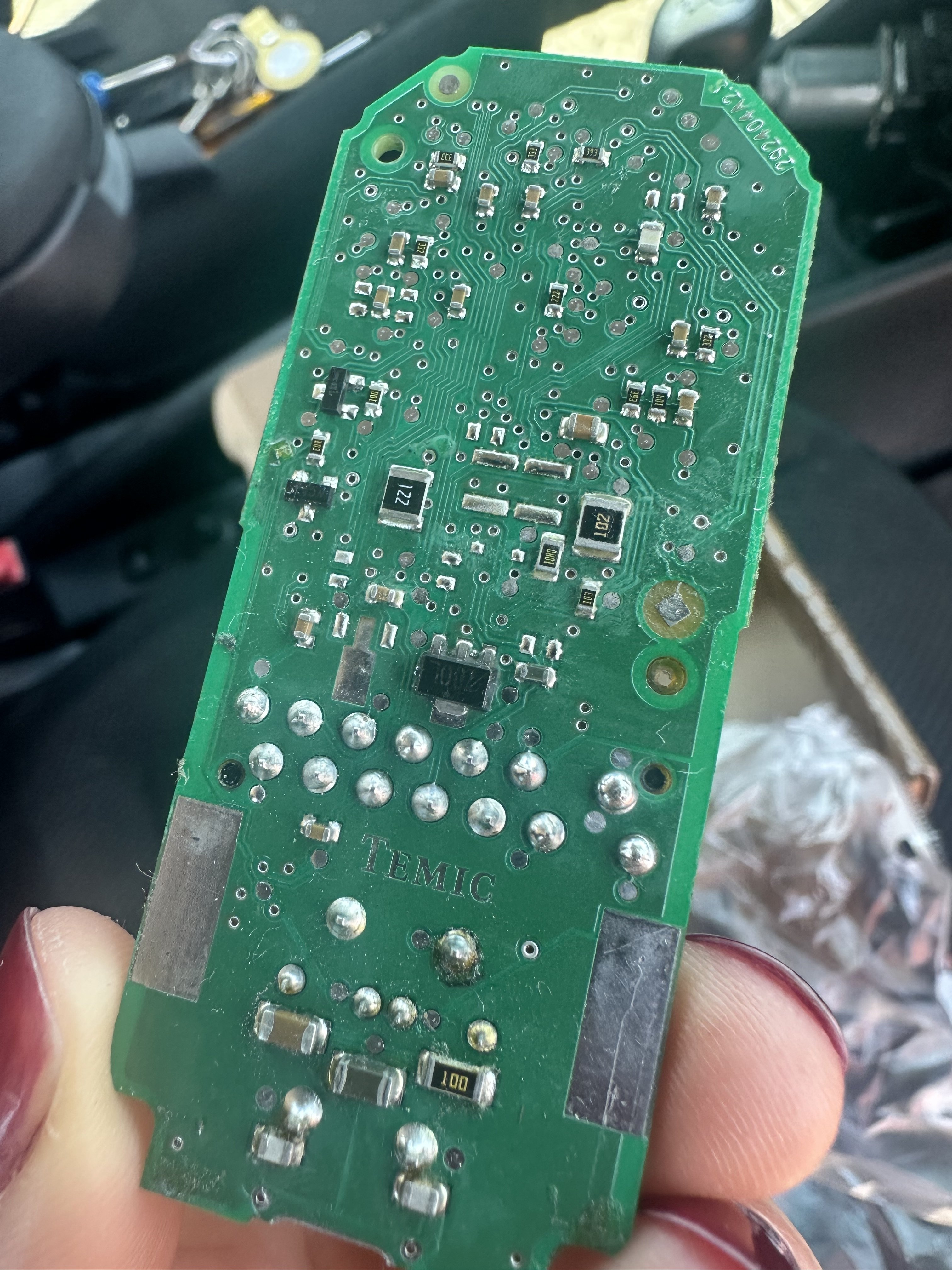

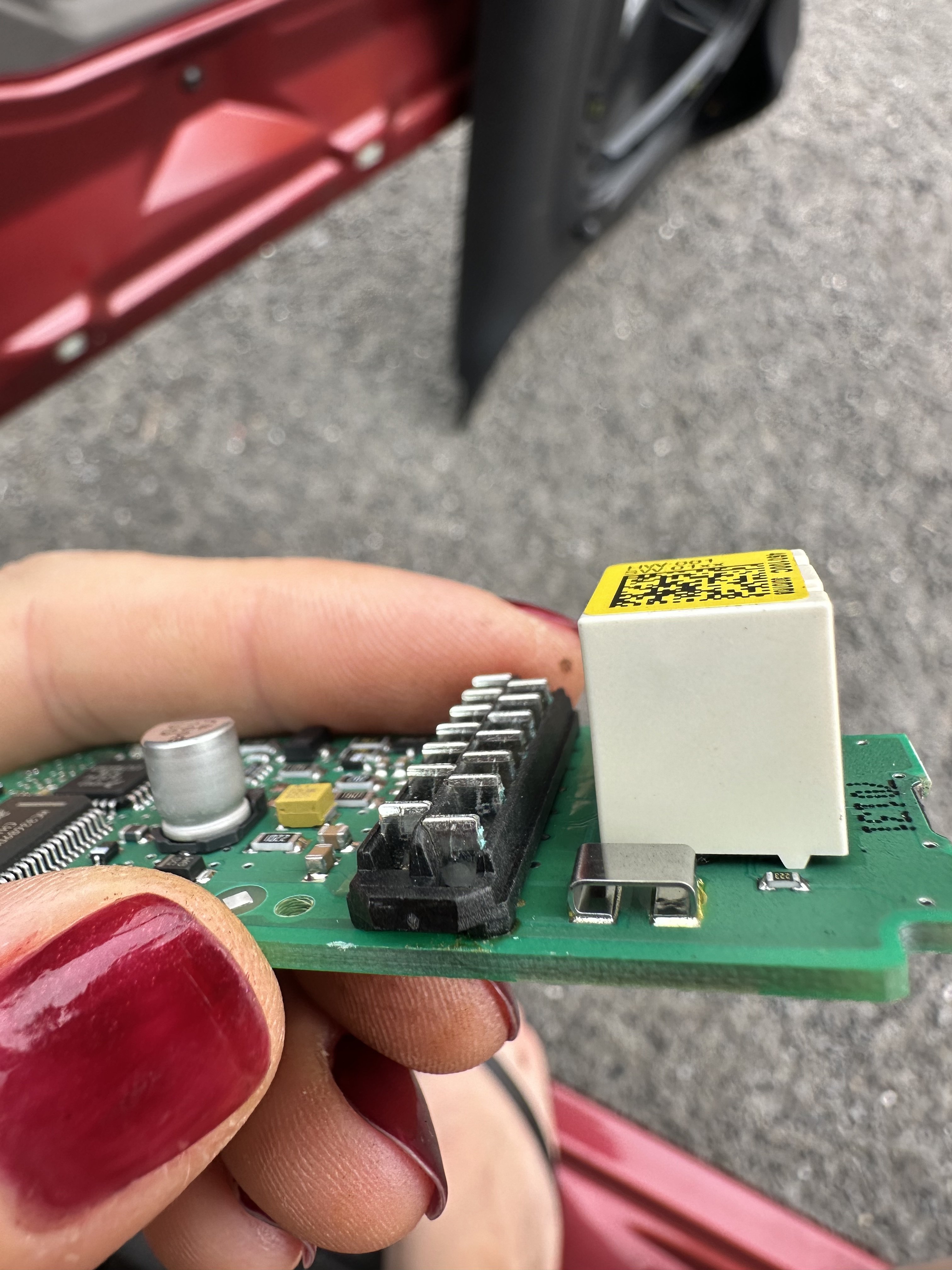

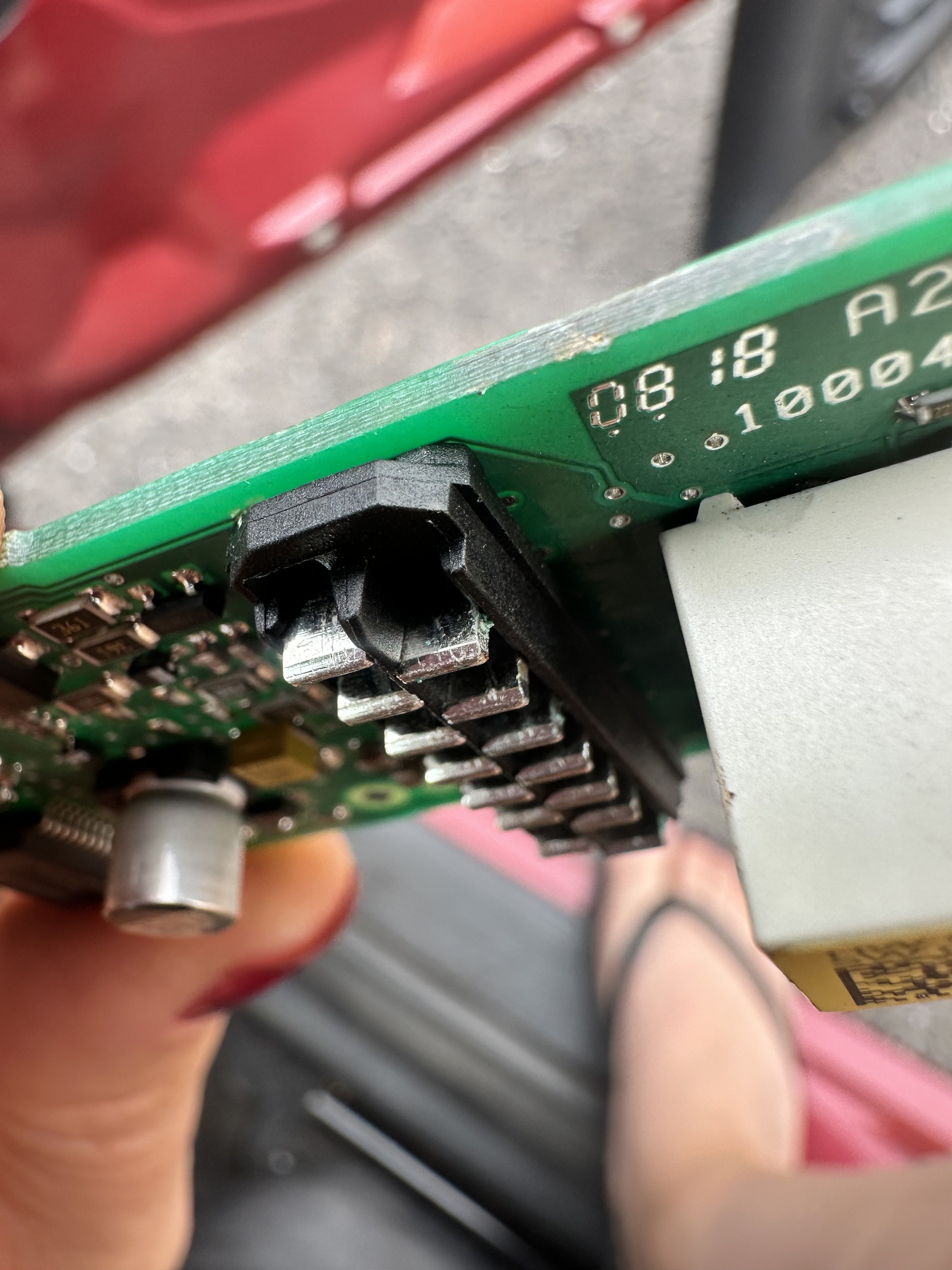

  3. All the fork pins were cleaned when the board was re soldered. I will check their angle and give them a pinch on my next dismantling! Mananged to find a replacement motor to try for £20 too, just waiting on the postage!

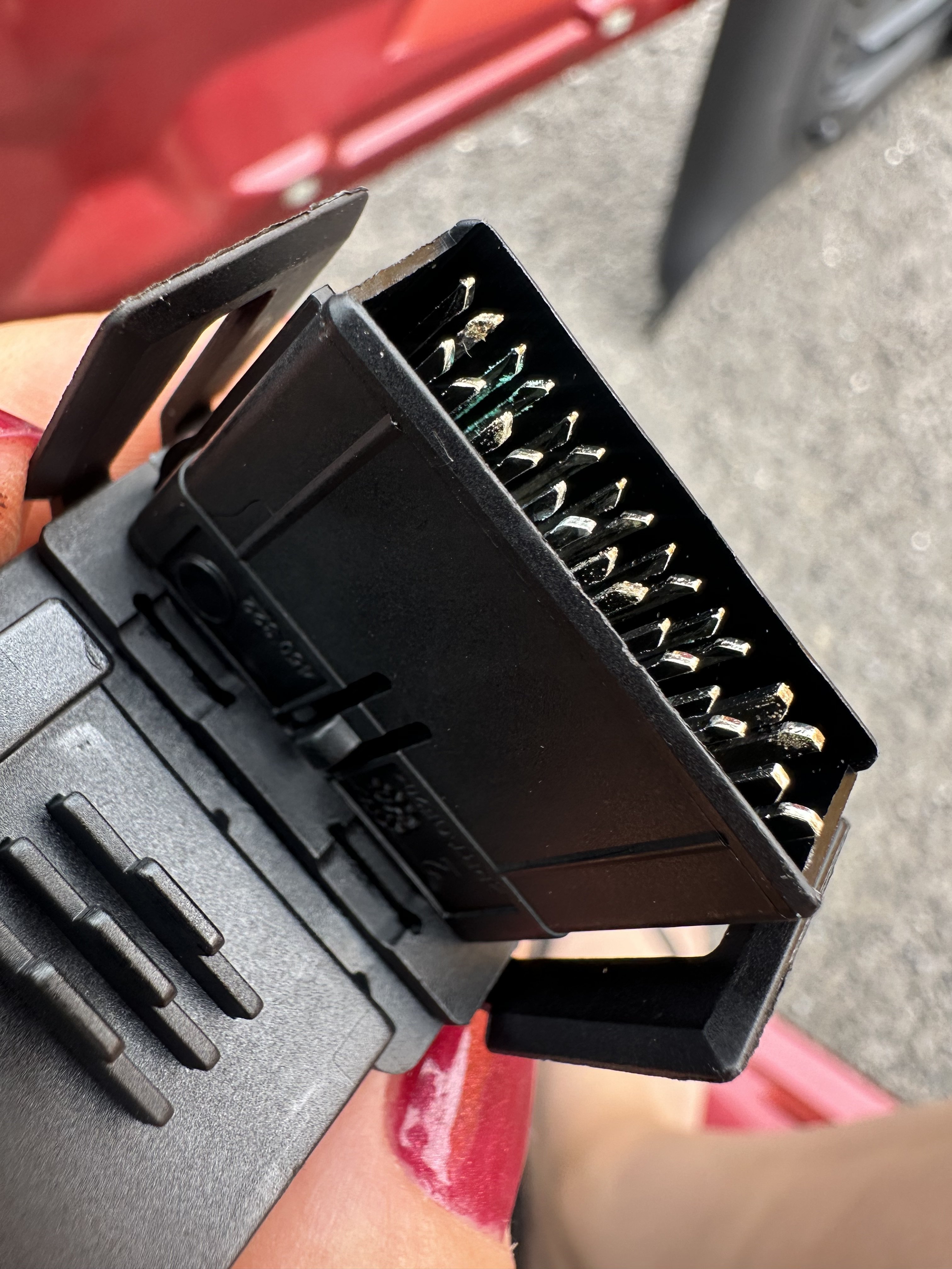

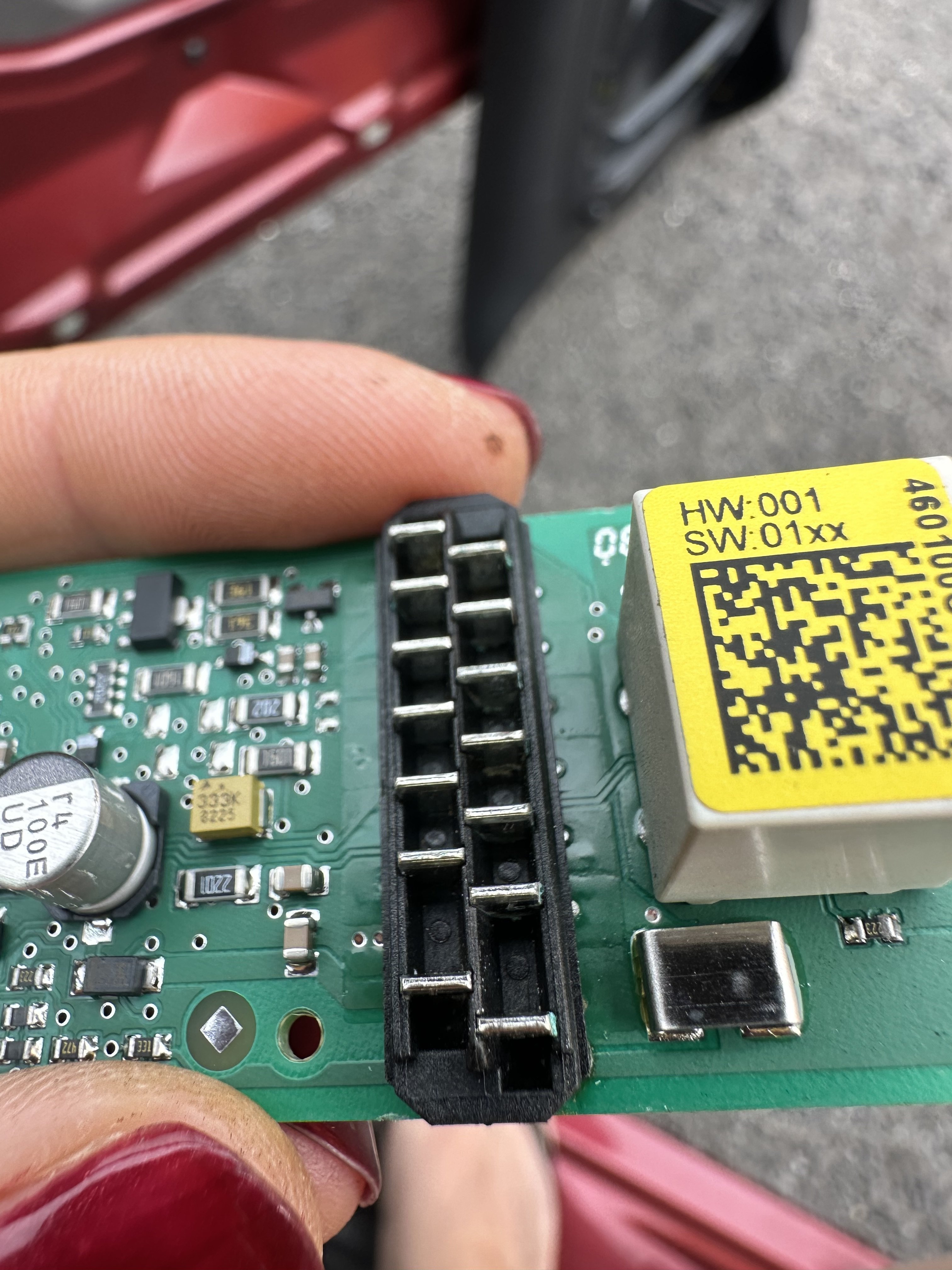

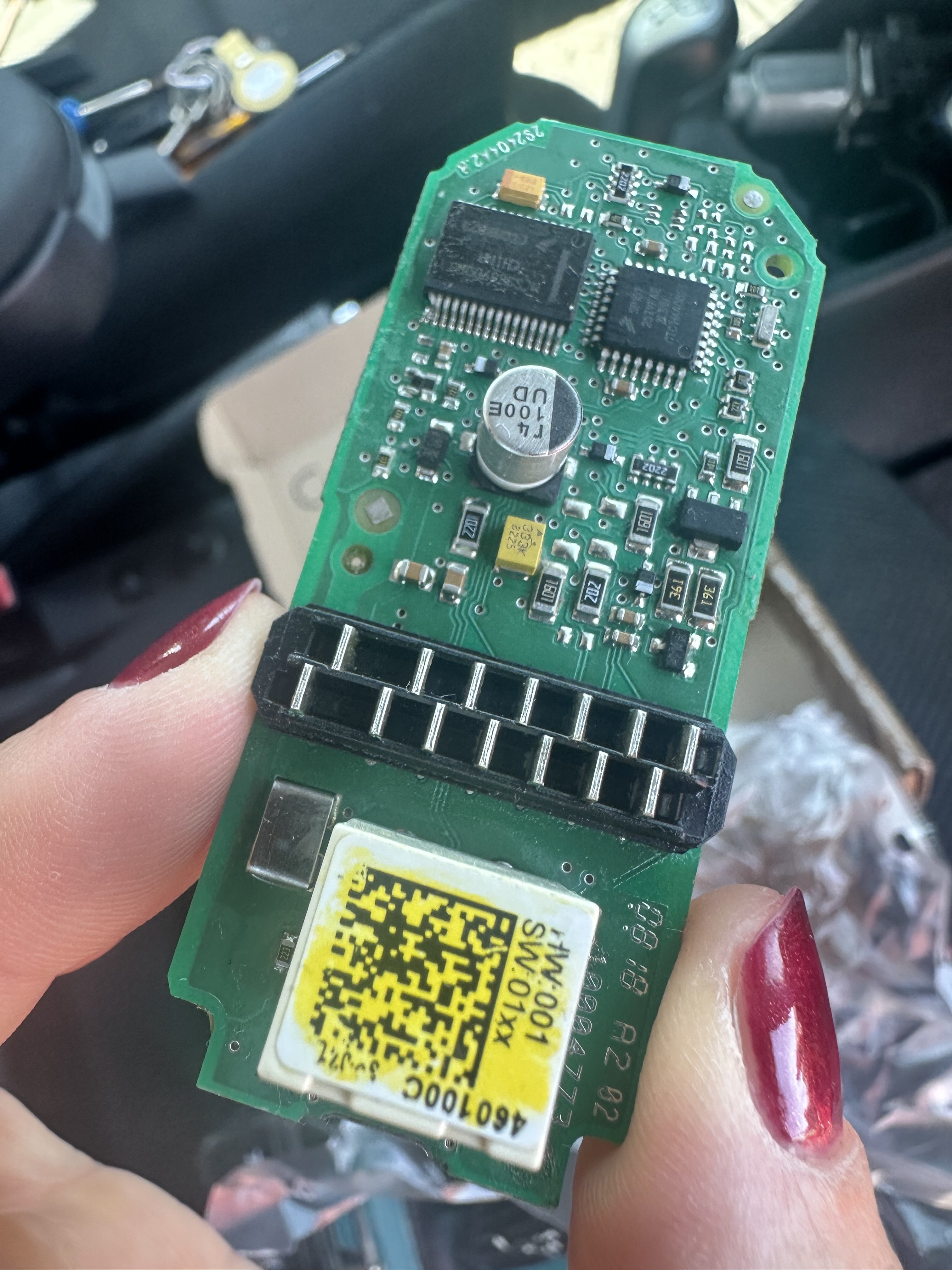

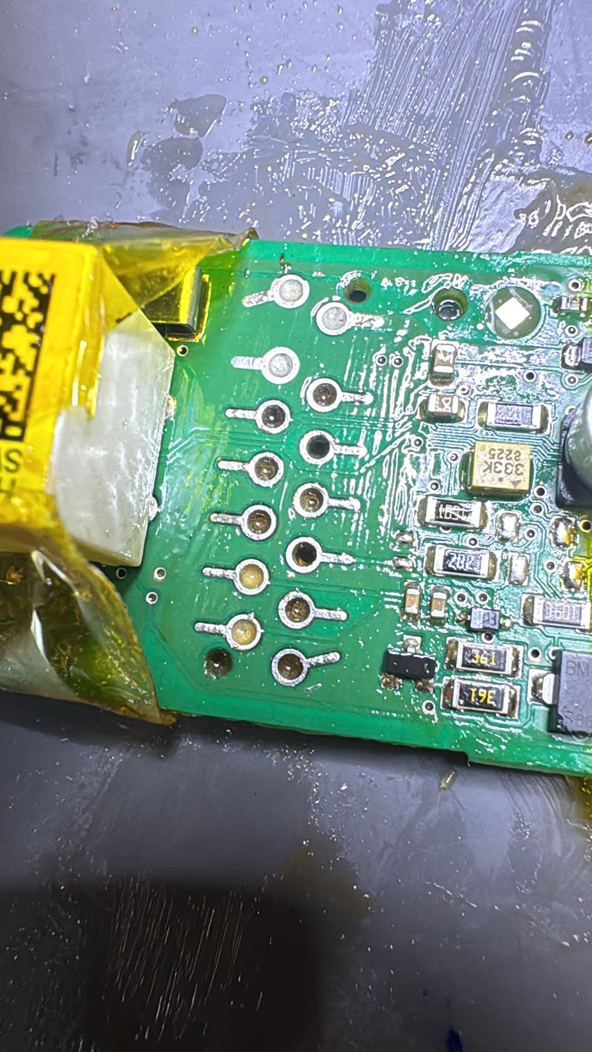

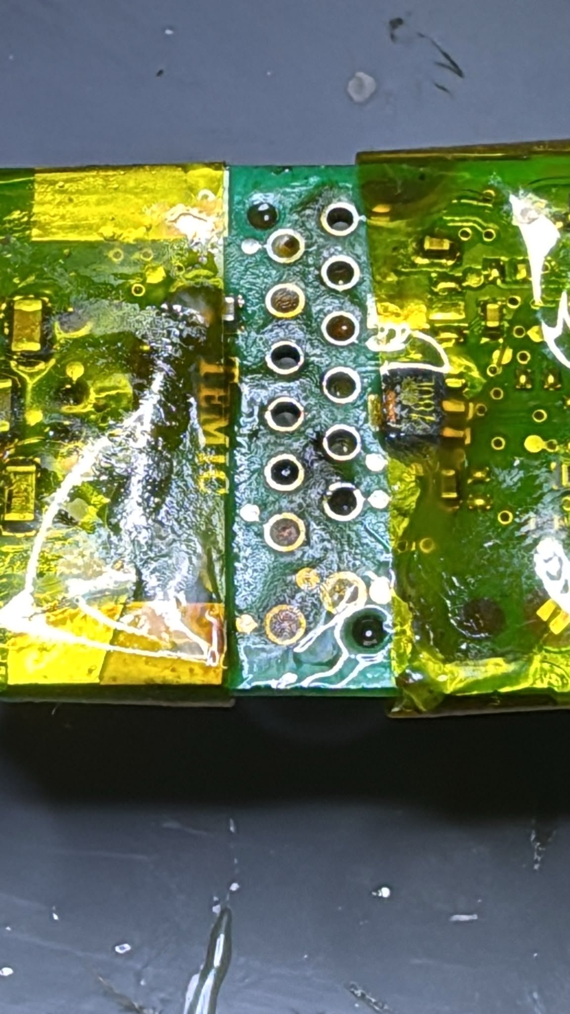

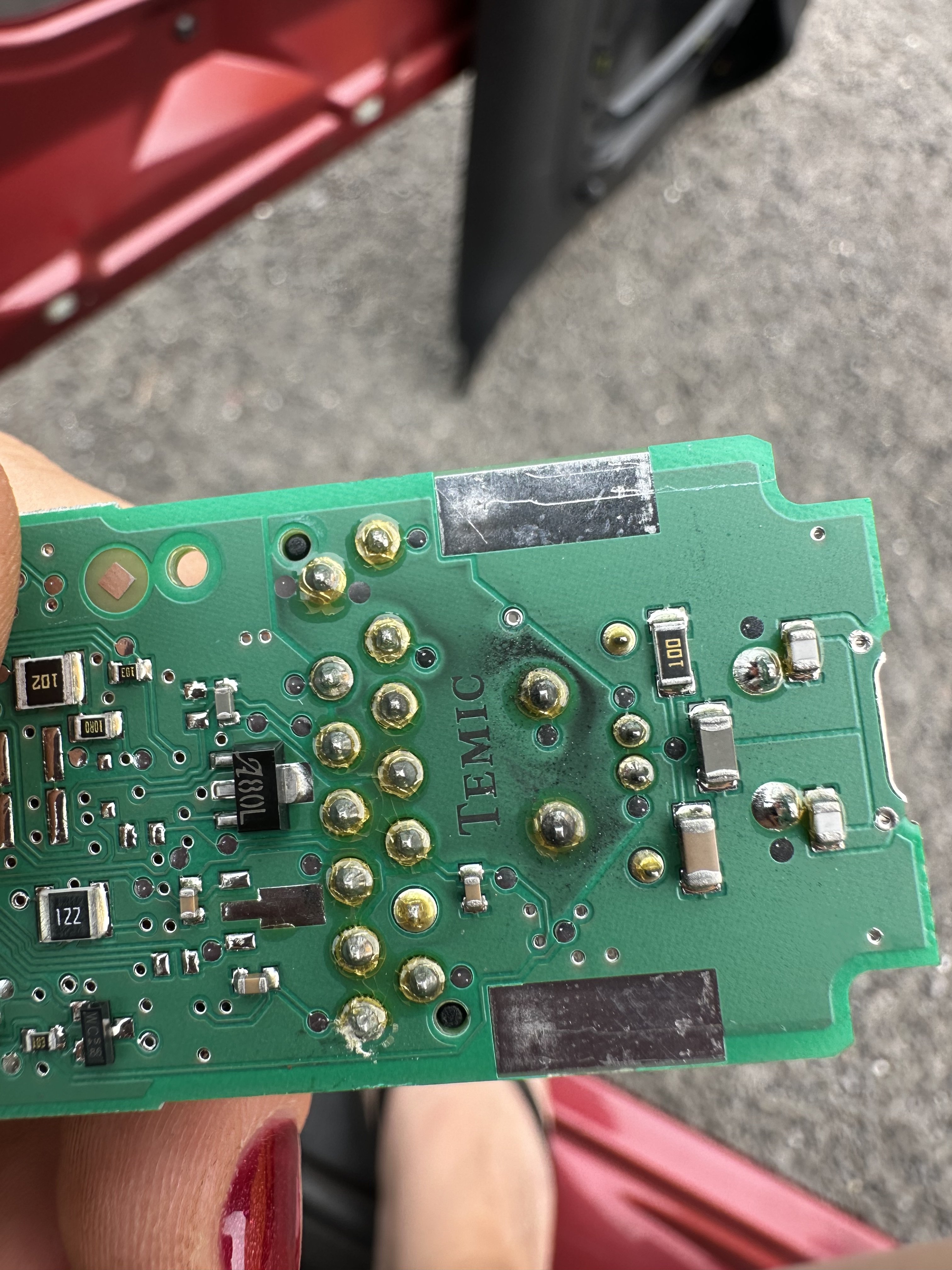

  8. Here are the results of my dismantling Breezy_Pete. I have a friend who is qualified in micro soldering, so have passed both pieces over to them for cleaning and repair! There does to my eyes seem to be some black and green residue over the components. Any further advice for me? Two more!

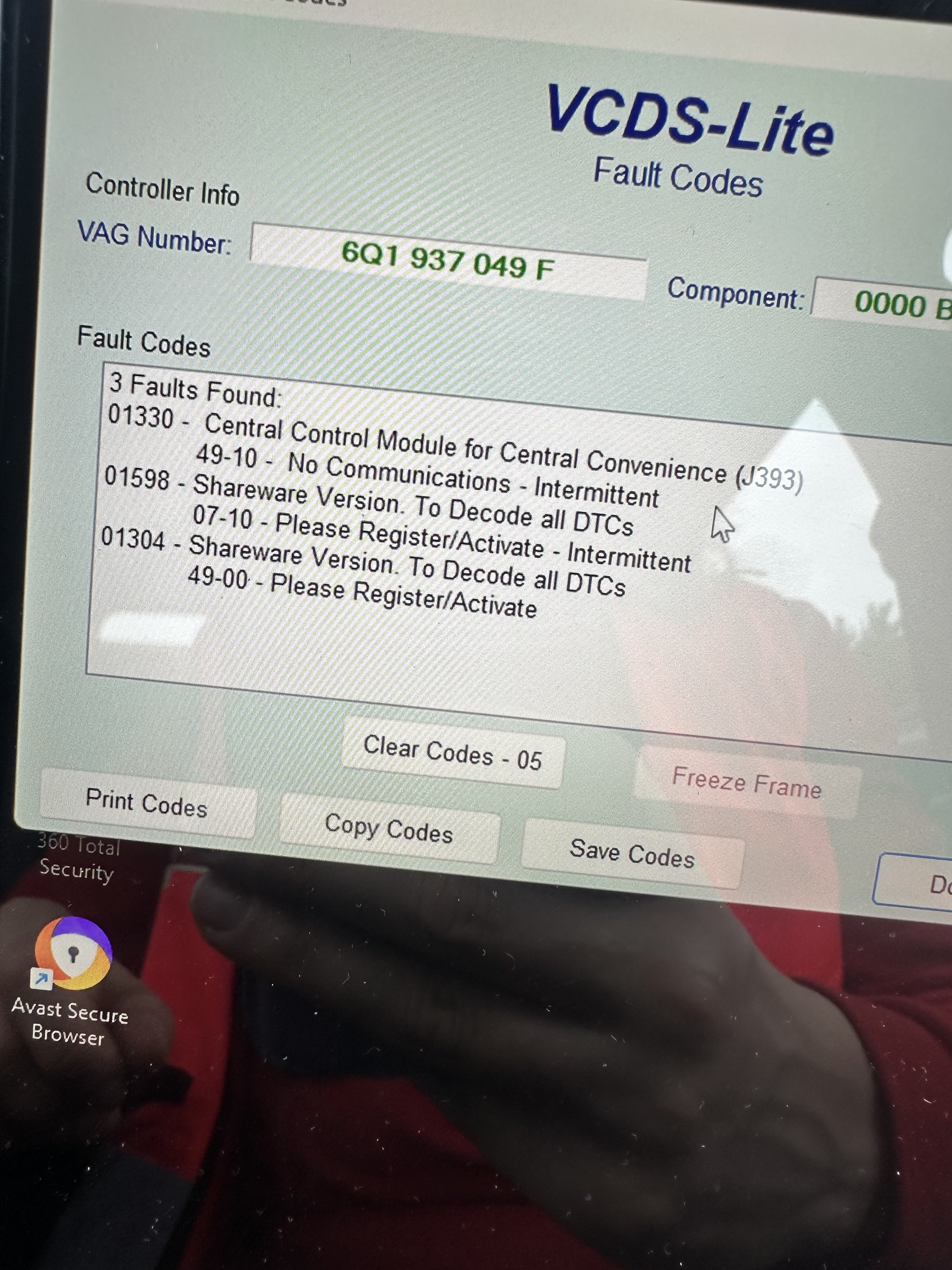

  9. Thank you so much! Plugged the car in tonight and an error would seem to confirm your suggestion also!
  10. Thank you! Please can you tell me where I find this board - the old ball and chain is a certified board repairer 👍
