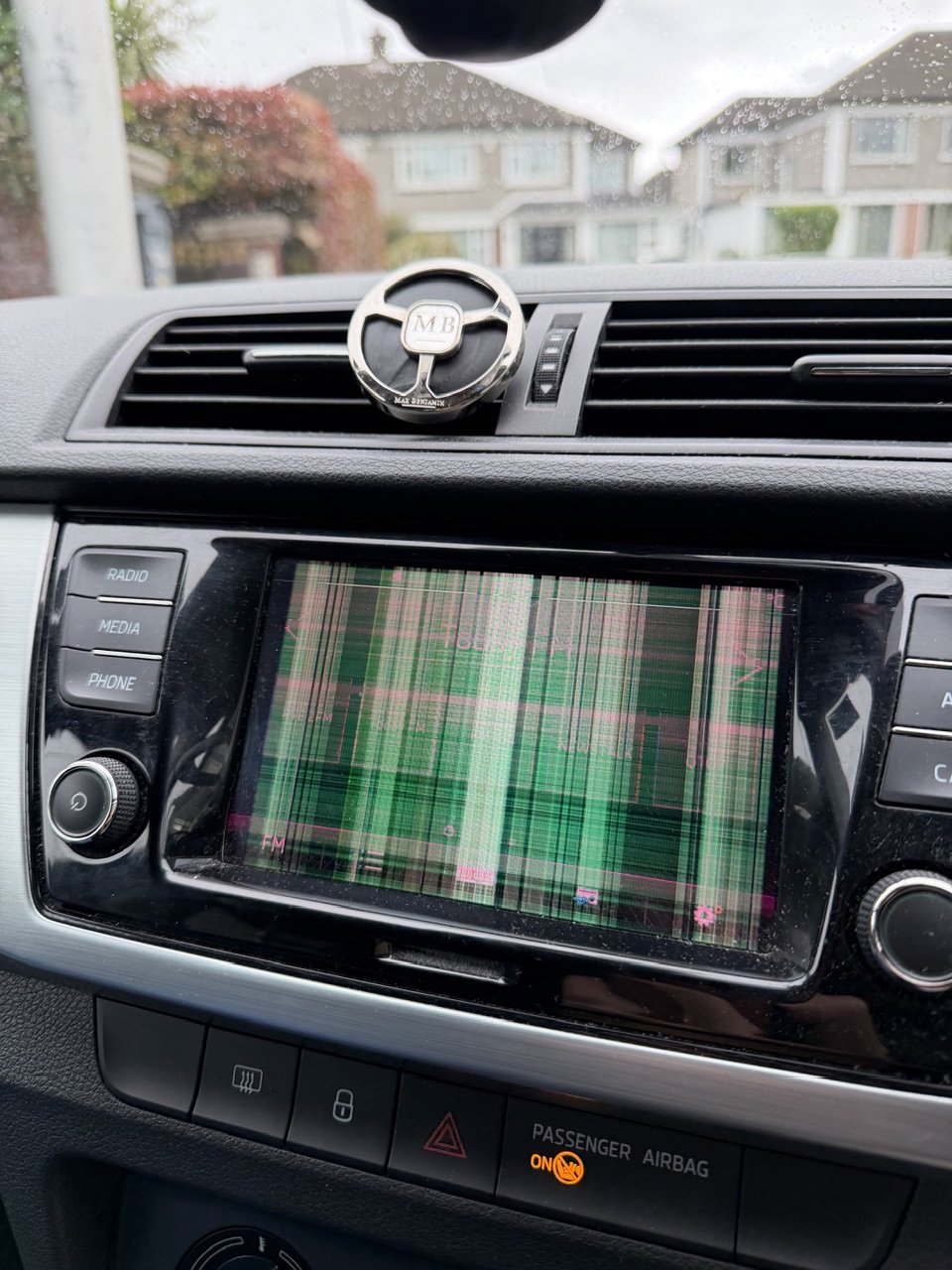

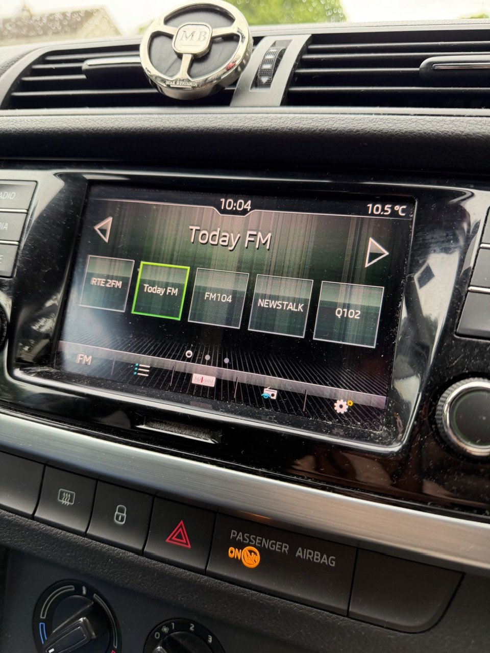

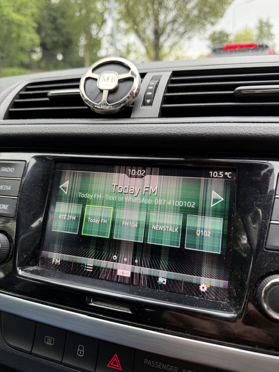

  2. Thanks - part number is 6V0 035 871 H, model MIB2GP
