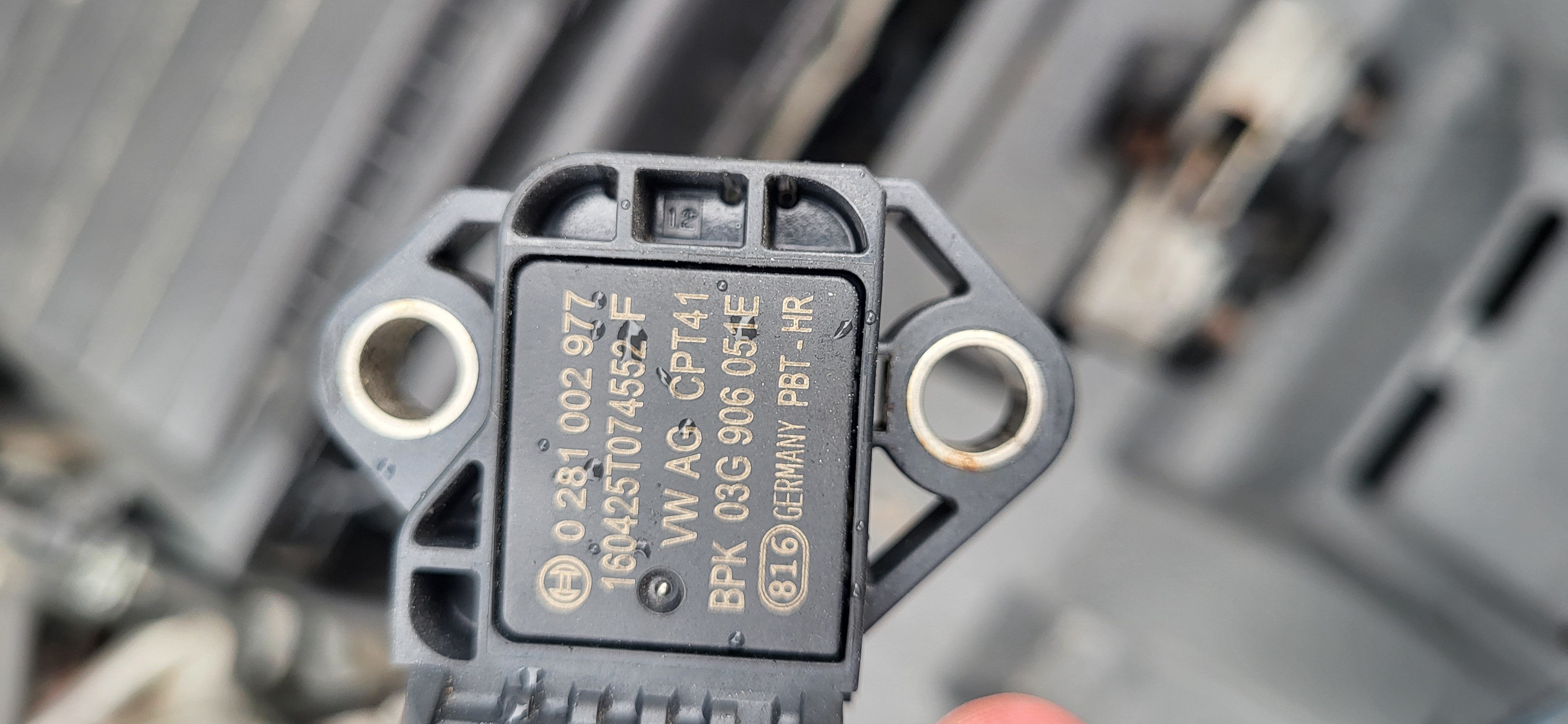

faxiw

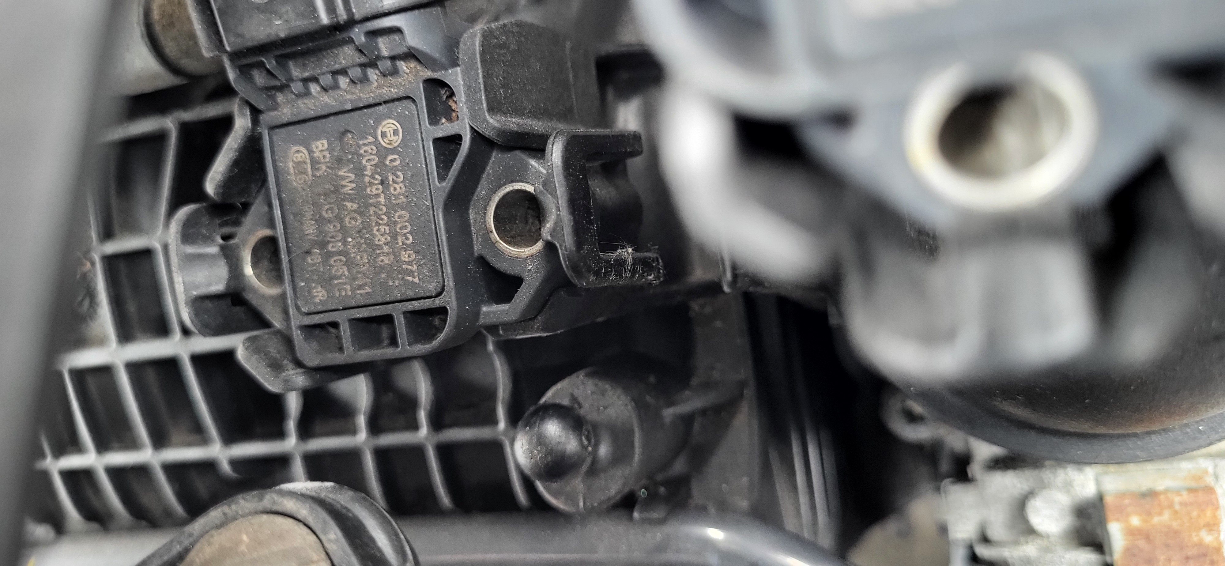

  1. Brilliant, I didn't even see that they were the same part. Thanks for your time with this, I really appreciate it

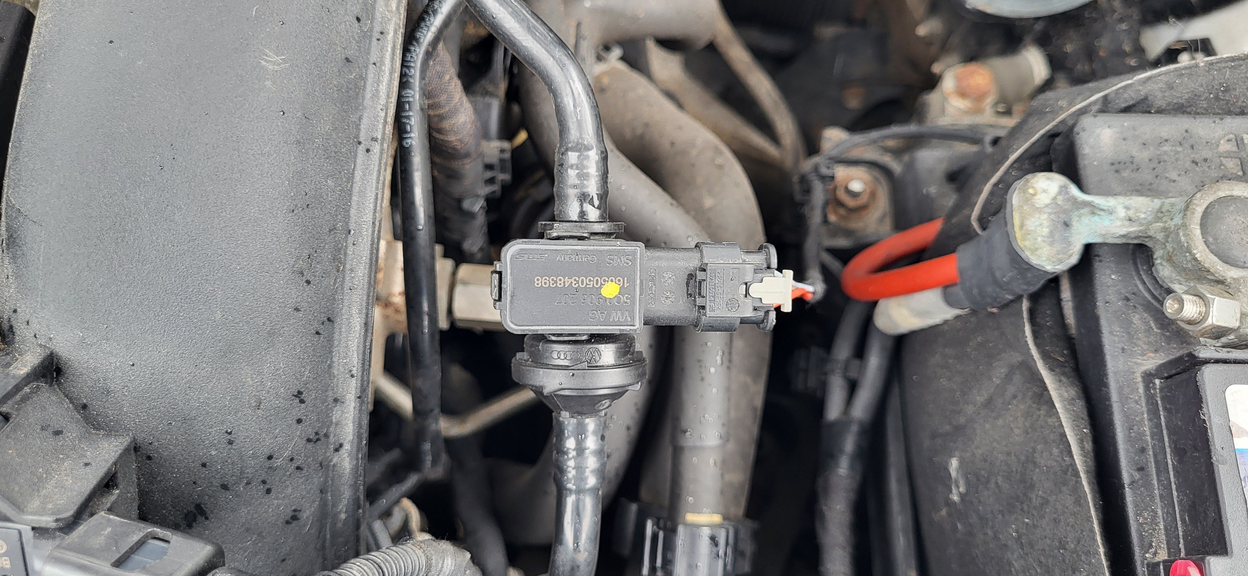

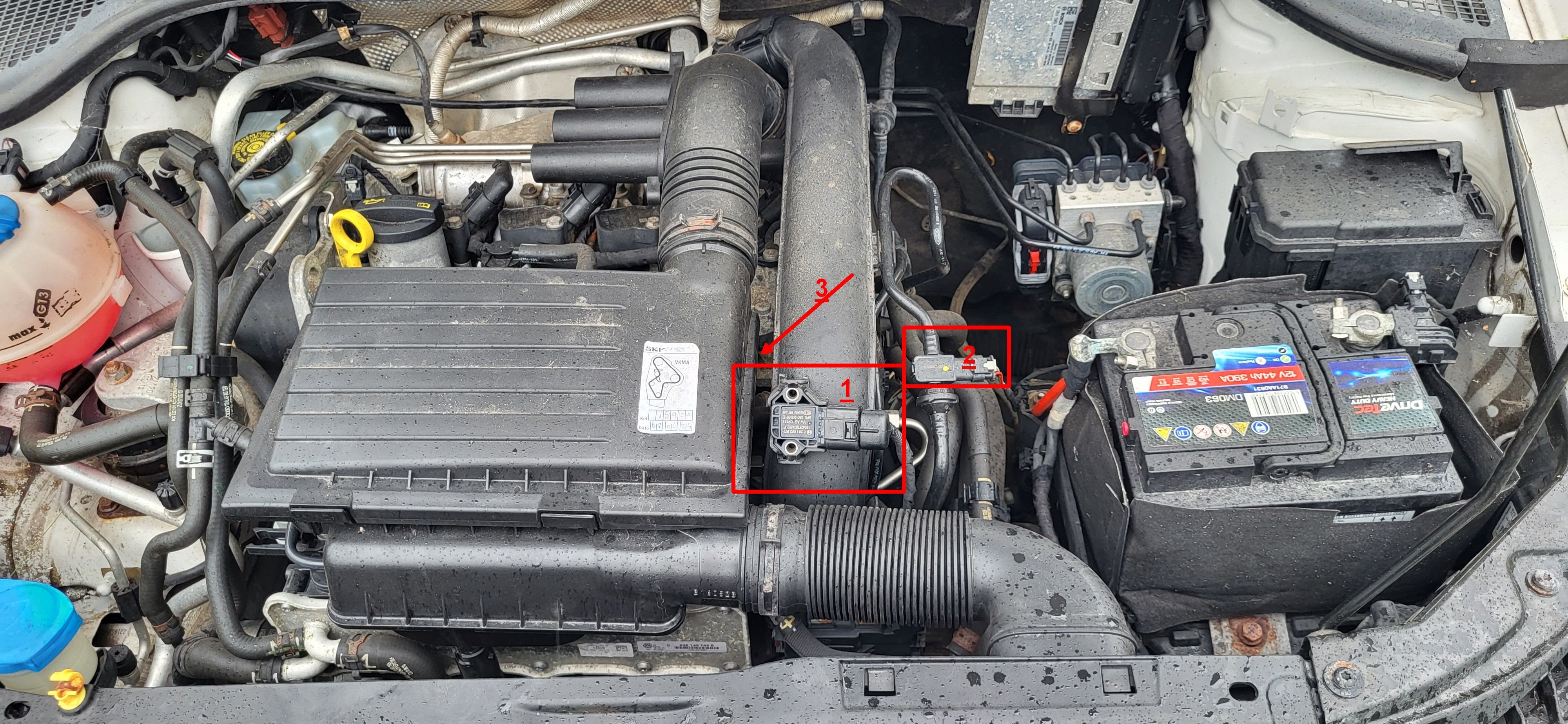

  2. Oh ok, so it could be one or both of these where it's reading the temperature as too high. I'll see if I can find the replacement parts, hopefully I can just swap them out myself. Thanks for the help
  3. Hi Rum4mo, thanks for that. Looking at a intake charged air sensor is the same as the intake air temperature sensor? Just want to be 100% The arrow for 3 is the top picture, I should of labelled the picture itself and not just named it. My mistake
  4. It's a petrol 1.2 TSI engine I believe - year 2016
