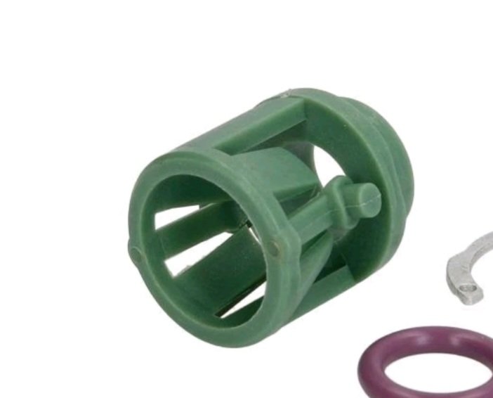

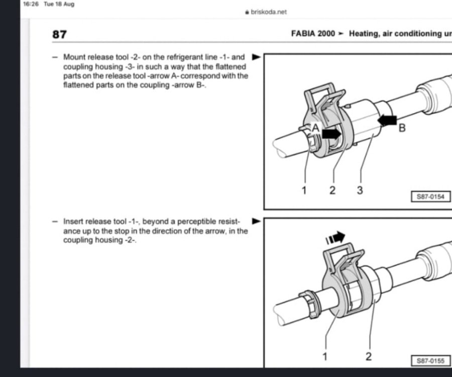

  2. This bit in broken on mine anyone have any ideas how to get the pipe to release. The 2 green pins are not visible on the metal part of the pipe and its not releasing
  3. This bit in broken on mine anyone have any ideas how to get the pipe to release. The 2 green pins are not visible on the metal part of the pipe and its not releasing
