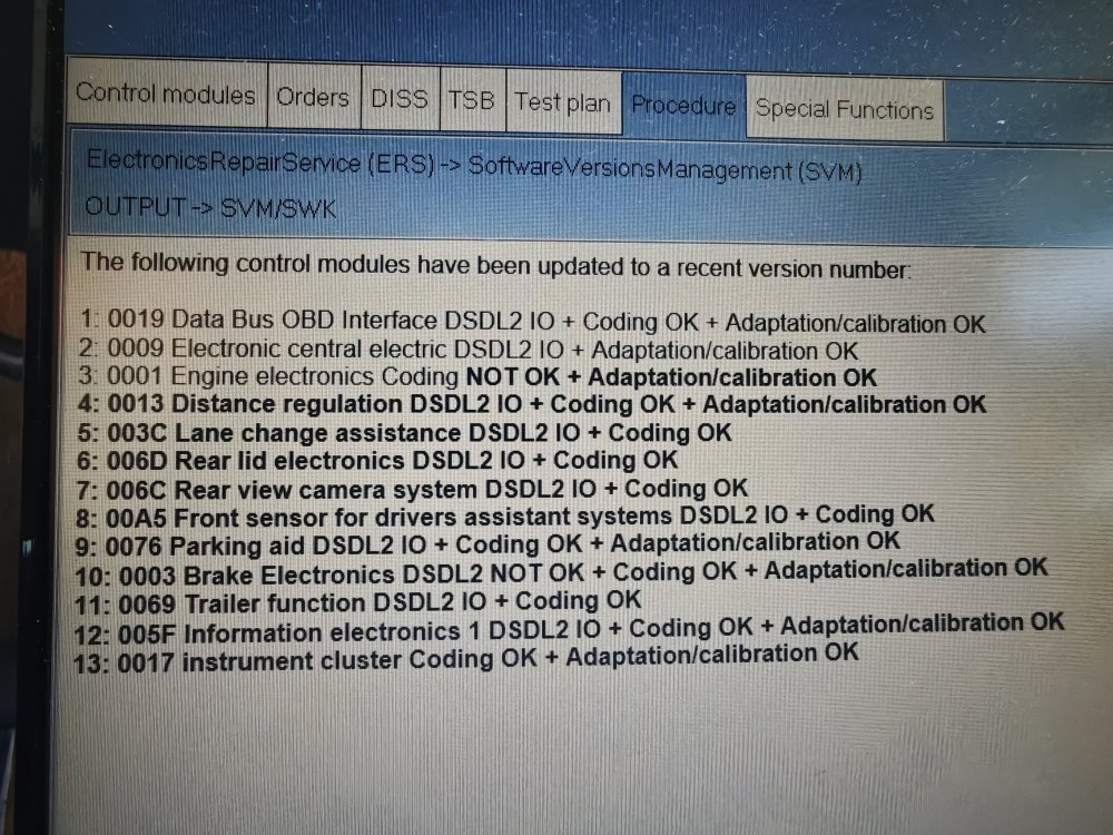

  1. I ran the SVM code again and everything is sorted, to get the lights on the trailer you have to switch the light on manually in the car.
  2. I ran SVM TOWAB with Odis S yesterday and it went through and updated, coded and adapted a bunch of modules. But when I tried to pull a trailer today it didn't recognize it, parking sensors beeping and emergency braking in reverse. What could it be?
