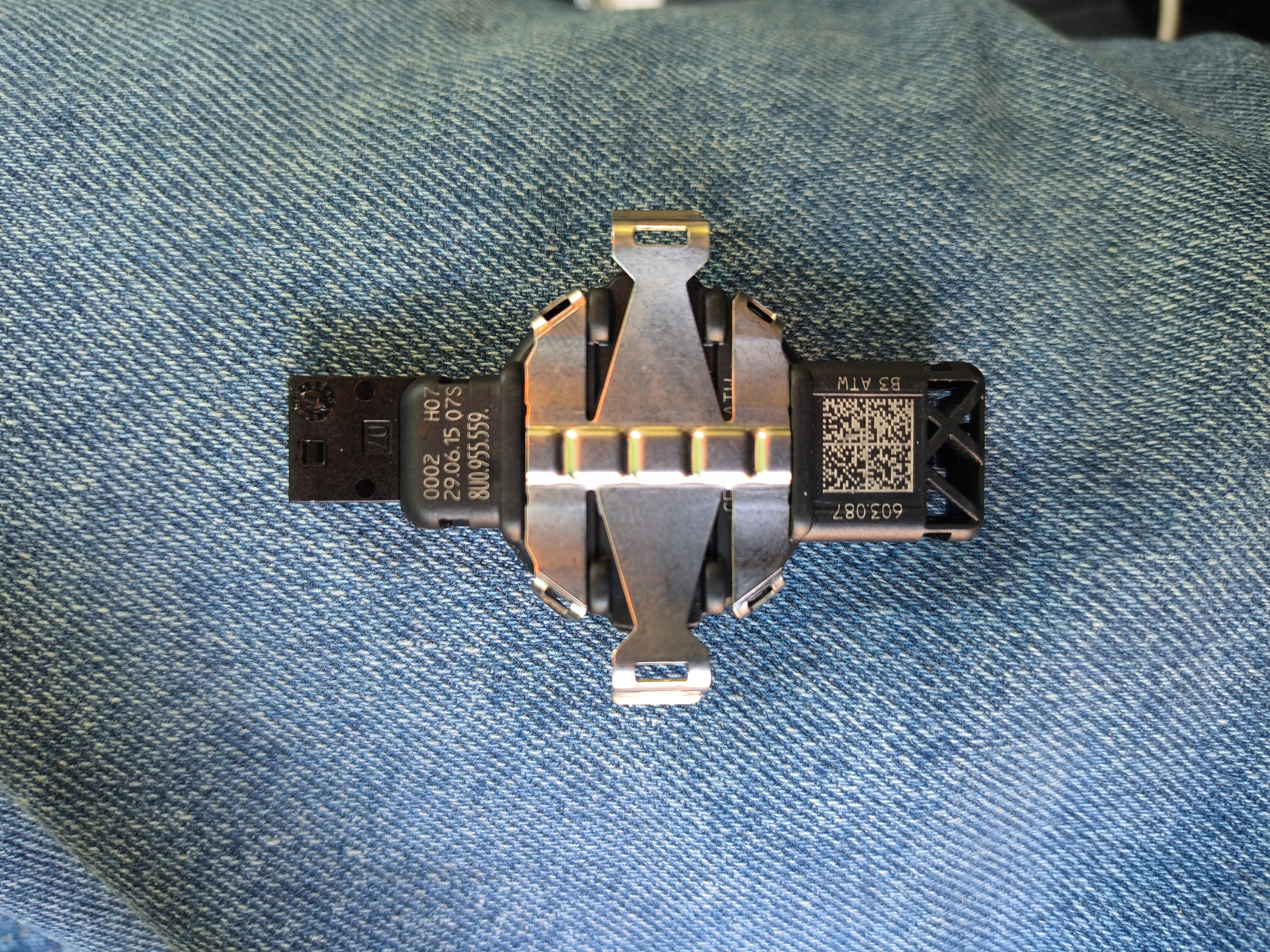

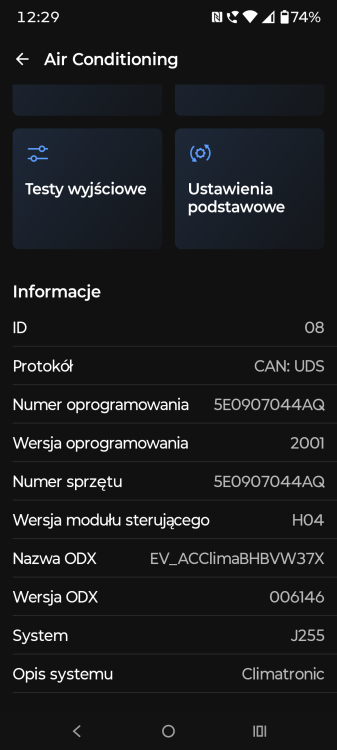

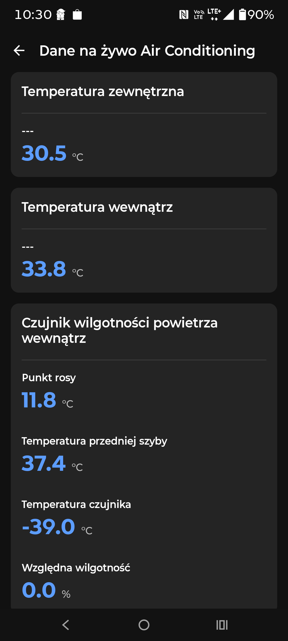

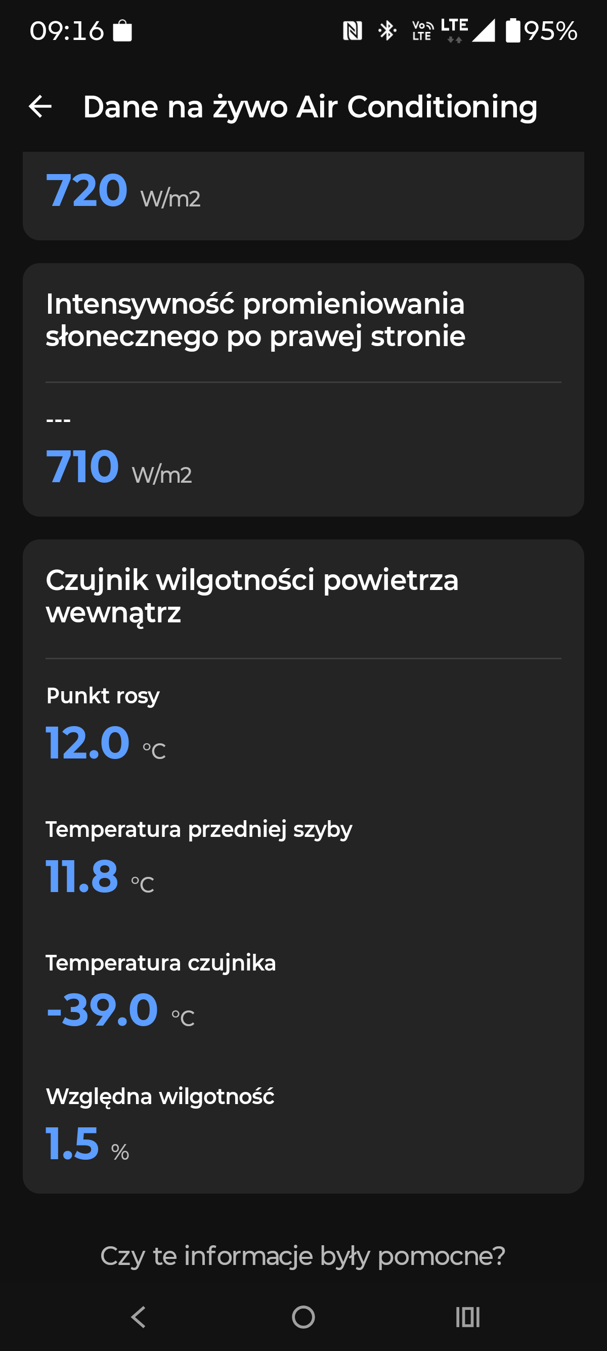

  1. Good morning, everyone, On a 2018 Octavia 3 1.4 TSI, the windshield was replaced, and the rain/humidity/temperature sensor under the mirror was repositioned. After that, the climate control started acting up. It’s a dual-zone Climatronic system. There are no communication errors with this U80.955.559 sensor, but the temperature readings it returns are unreliable: either 11 degrees in the heat or 37 degrees oC and a bit, alternating with humidity readings around 0 and a sensor temperature of minus -39 degrees. I replaced the sensor with another one—same result. Has anyone else encountered this problem or know how to fix it? I diagnosed it using OBD Eleven. I’m attaching screenshots. Best regards, Tomasz Translated with DeepL.com (free version)
