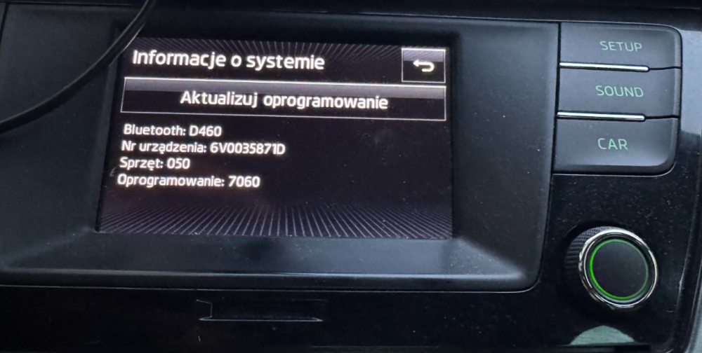

  2. Hi Pab567, Thank you very much for the response. Regarding units it would be great if you help me with getting patched one. Please send me priv message - I can not initiate conversation yet as I am new member.
