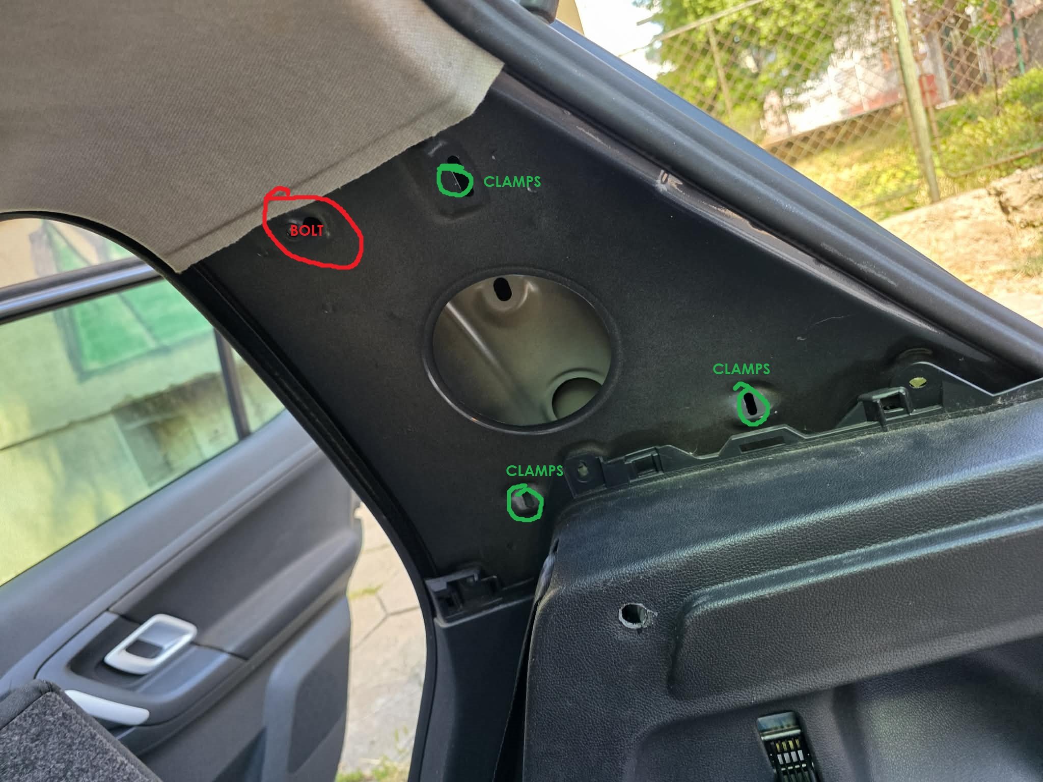

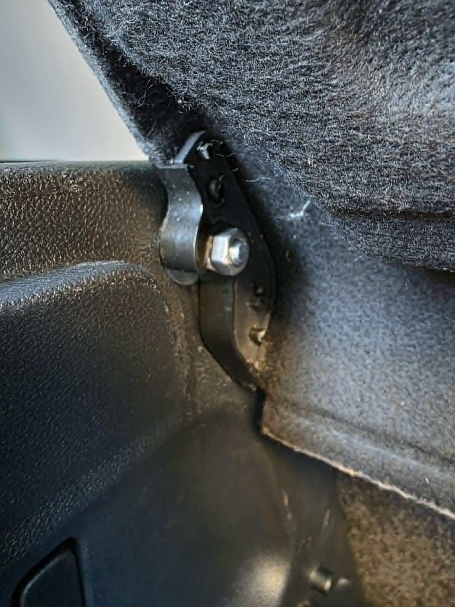

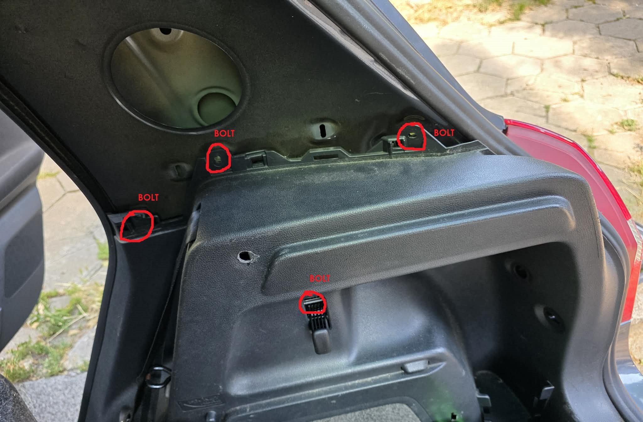

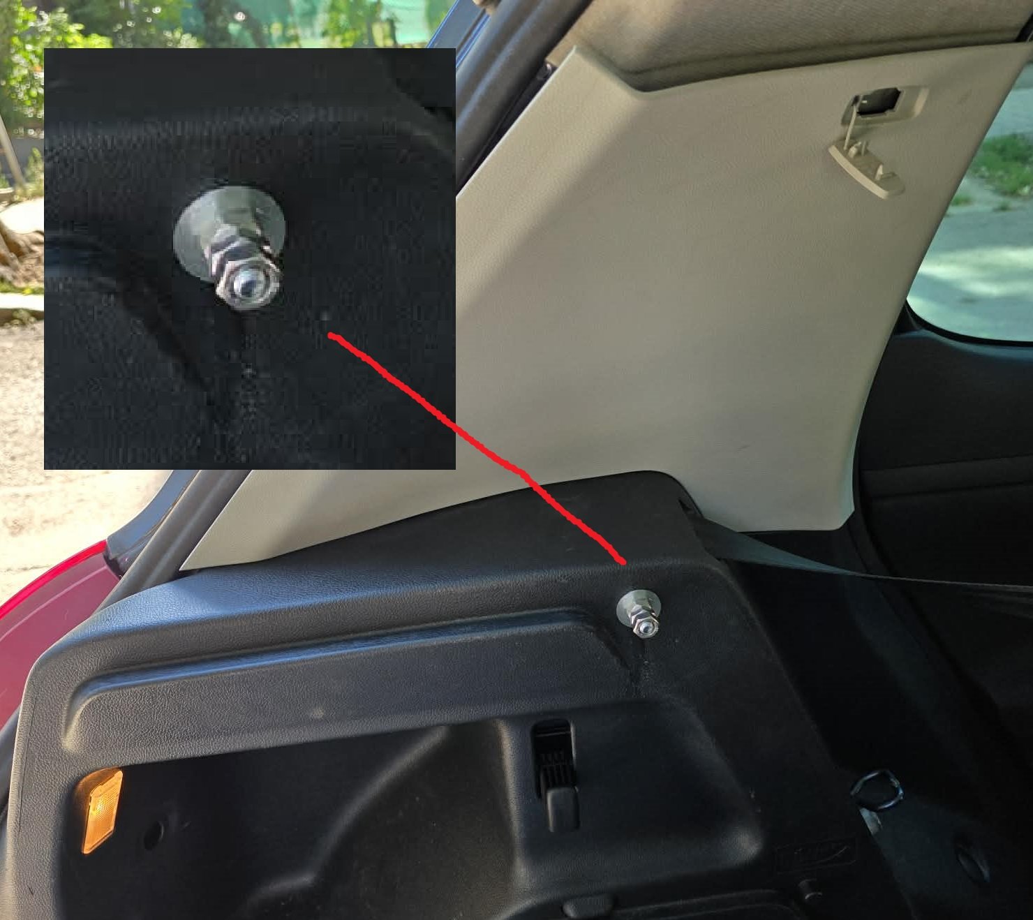

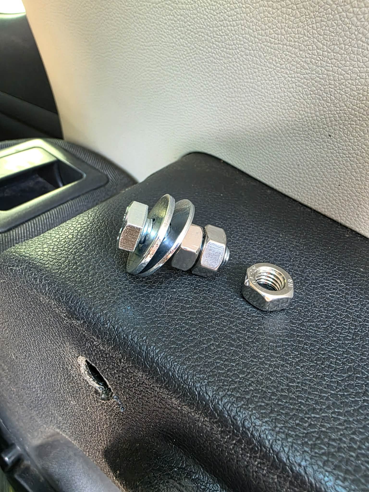

  1. FIXED IT! Hi all, just to let you know I found a DIY solution: Dont waste your money on repair kits or replacement panels. Needed: 2x Bolts M8 - 25mm ( I think 20mm would also work fine) 4x Washers M8 Large 6x Nuts M8 Disassembly of the side panels: To get access to the hole from inside the panel you need to remove the top panel first: Then the lower plastic panel: Note: I didnt remove the whole panel, just to open it enough so I can stick my hand inside with the M8 bolt and 1 washer: Obviously you need to place 1 washer on the inside and 1 washer on the outside. Assemble: (After you place back all panels and screw them in, DONT forget to unfold the rubber seals over them so they can be in place) Final Result: Holding strong. Have fun! Scoda Fabia mk2 broken trunk side panels lugs hinges pegs shelf holders
