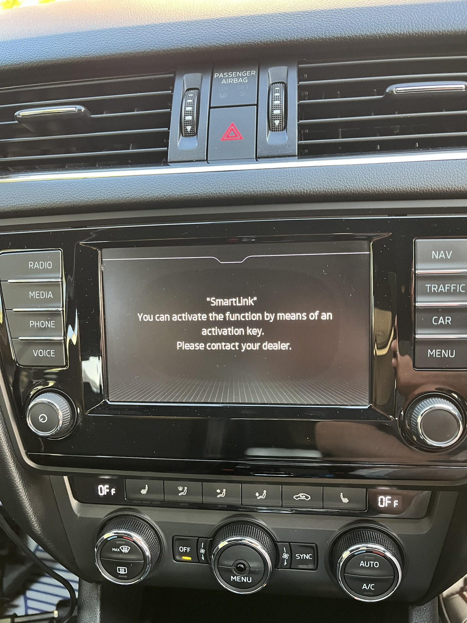

  1. Thanks, I contacted vision coding as they were recommend on a different thread but before I went with the purchase I came across this video and I managed to get it working as per the guide, all I needed to buy was a generic OBD reader from Amazon which I no longer have any use for and will be returning 🤣 https://www.youtube.com/watch?v=FoQA1dTqvRg

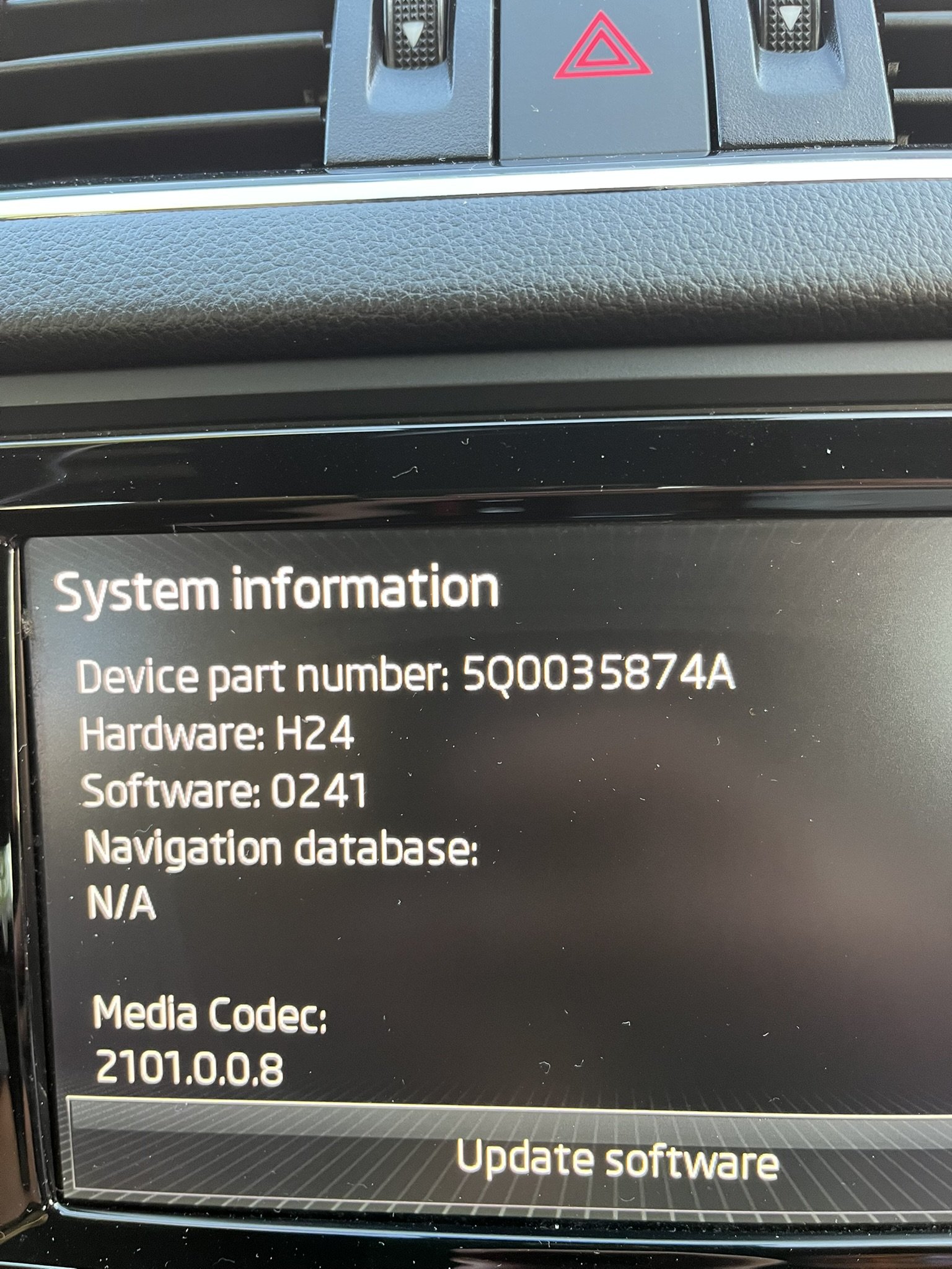

  2. Yes I know yet another post about the infotainment, I spoke to my local Skoda dealer and they were useless and said they could get me in for a check in September? Anyway, I recently bought a 2015 Skoda Octavia VRS. I believe it came with the MIB2 infotainment as the glovebox unit only has SD card slots no cd. What is the easiest way of activating smartlink as I would like carplay. Do dealers even offer the activation given how old the car is? Thanks.
