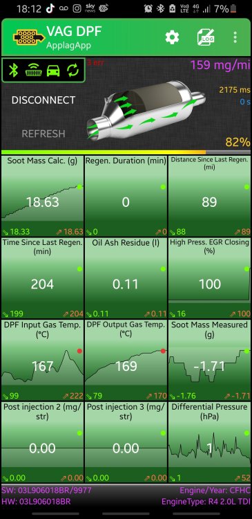

Hey guys, Since having my 2010 Yeti, 2.0tdi, 4x4, 140 remapped to 178ish I've notice the car runs very frequent dpf regens - approx 100 miles. I've attached the current DPF readings to the post, is something up or is this all normal? For the first time ever I had the DPF light come one the dash, a good run out and it went away. I then decided to run the VAG DPF as I was driving and was shocked to see the dpf racking up soot levels as quick as It did. The car runs very well, no issues bar the now annoyingly constant regens. Thanks
