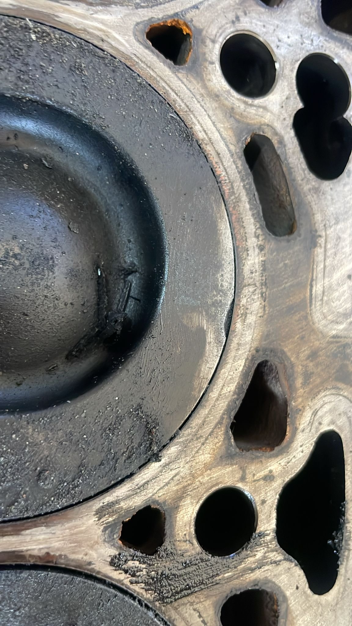

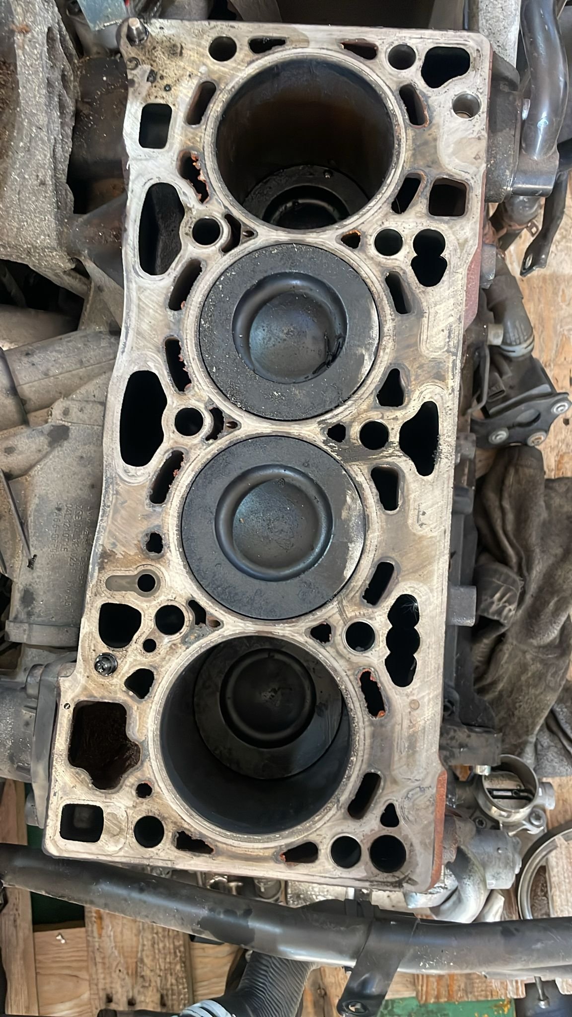

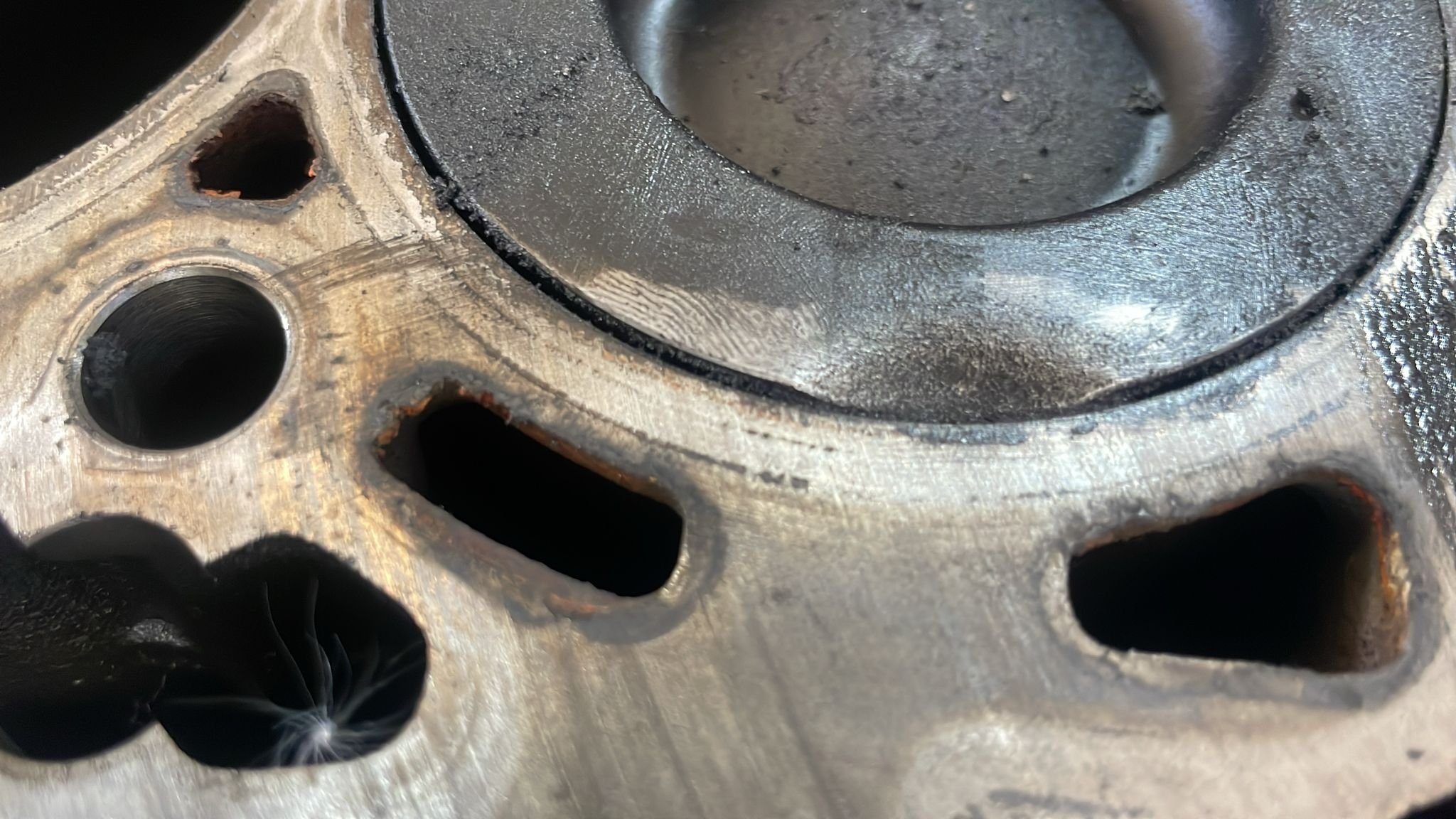

  1. I decided to change the glow plugs because occasionally it would take a moment or two longer to start and the fact that I had had a glow plug fail on me last year ( with a dash board engine warning) and the fact that It is generally considered that glow plugs would last up to about 150 thousand miles, so Thought it a good opportunity to replace them all at once, oh boy do I regretI not waiting until the service/MOT was due in October!
  2. I have just got the report back, it states: Engine is stripped and it wasn’t the glow plugs that caused the damage it had melted pistons 2 and 3 which then picked up on the boars and broke the piston rings.
