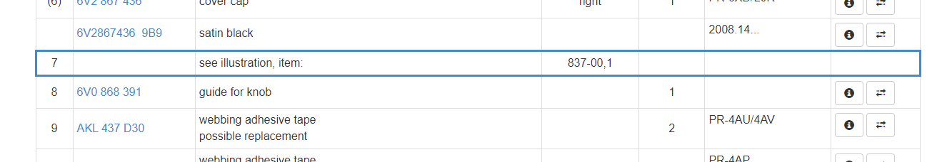

  1. I phoned Skoda in case they were cheap, only £23!

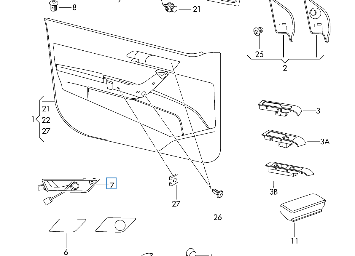

  2. Hi all, Does anyone know the part number for a drivers internal door handle assembly? The only catalogue doesn't show me. It's a 2015 NJ SEL. Thanks

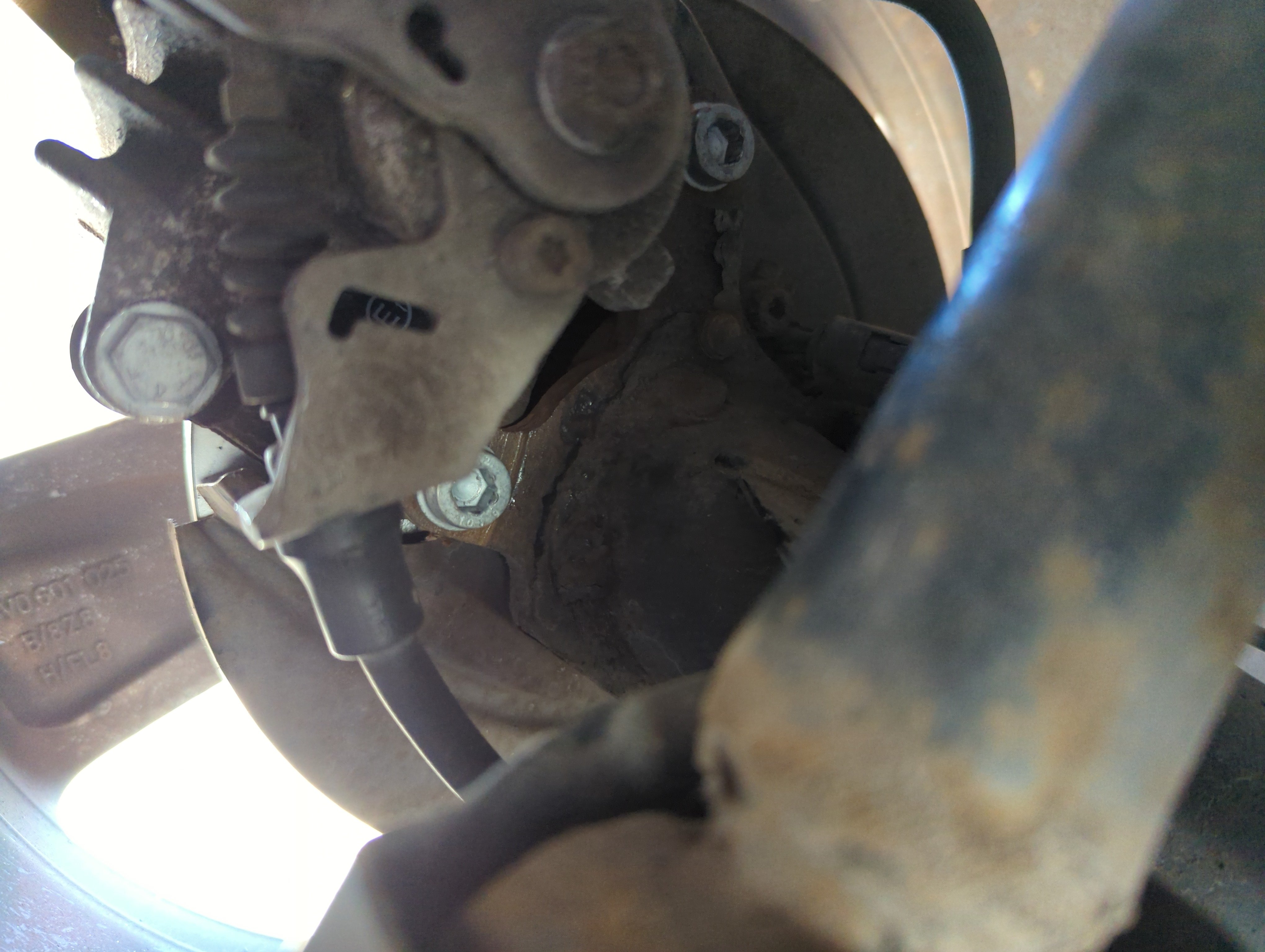

  3. The handbrake cables were the easiest bit to do, could get them off by hand. Both wheels were stuck on even though it had new tyres last year. Had to resort to a 10mph drive over speed bumps outside the house to get them to budge. The piston kept catching on the rubber when winding it back in, would of been stuffed without the proper tool. Needless to say I fitted new front shocks, springs, arms, discs, pads and drop links quicker than I got the rear brakes done! Need a drink now!

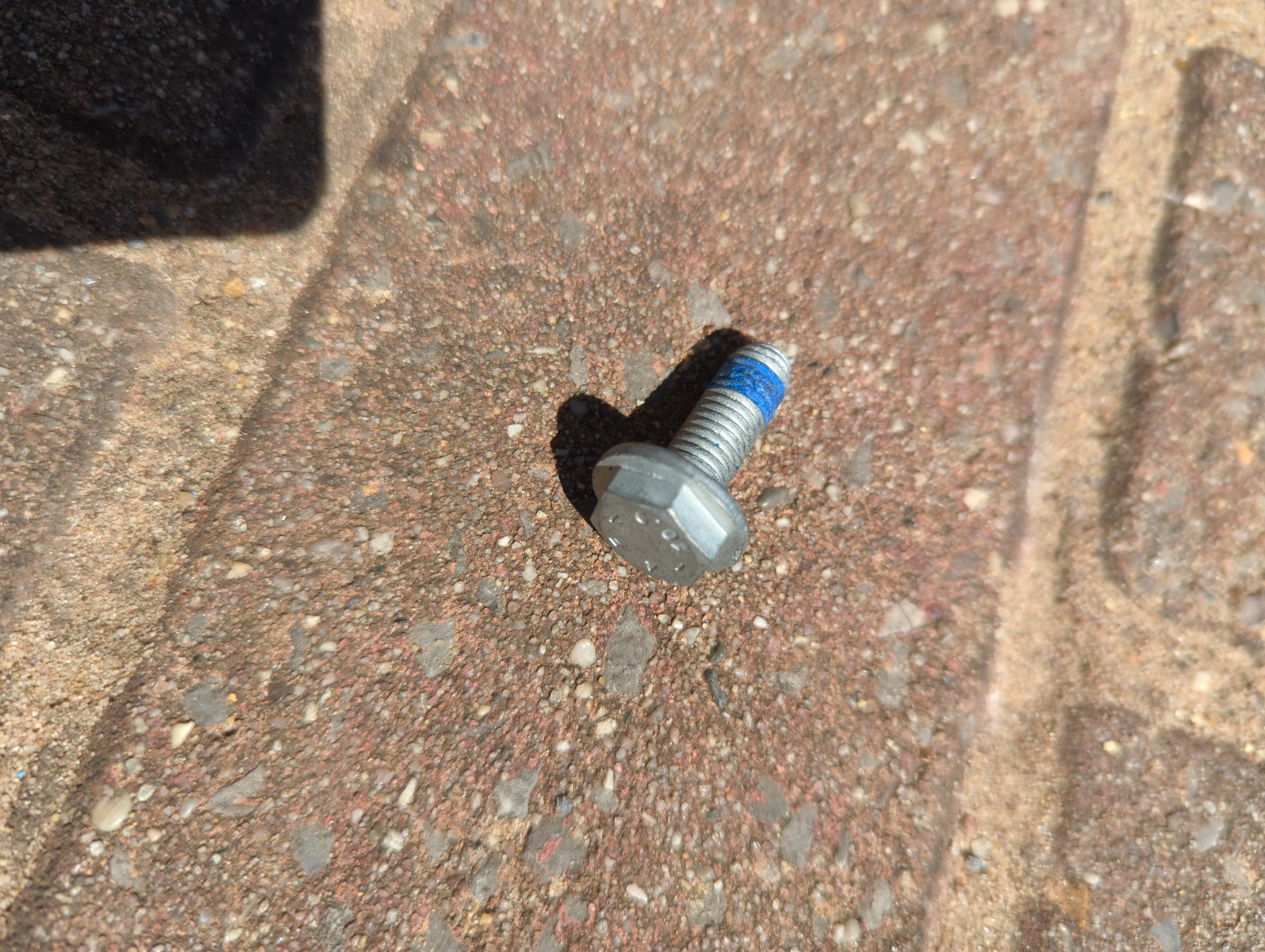

  4. No, just normal hex. The bottom ones came with the pads (ate). There's not a lot of room to get your torque wrench in either.
  5. I know, I was laughing at myself anyway!
  6. I mean it did 60k on this set, so have a while before that, in which case it will go to the garage!
  7. Nevermind, think I've been an idiot, the service manual was a different model, the other one shows 30+30. At least it won't be coming loose!

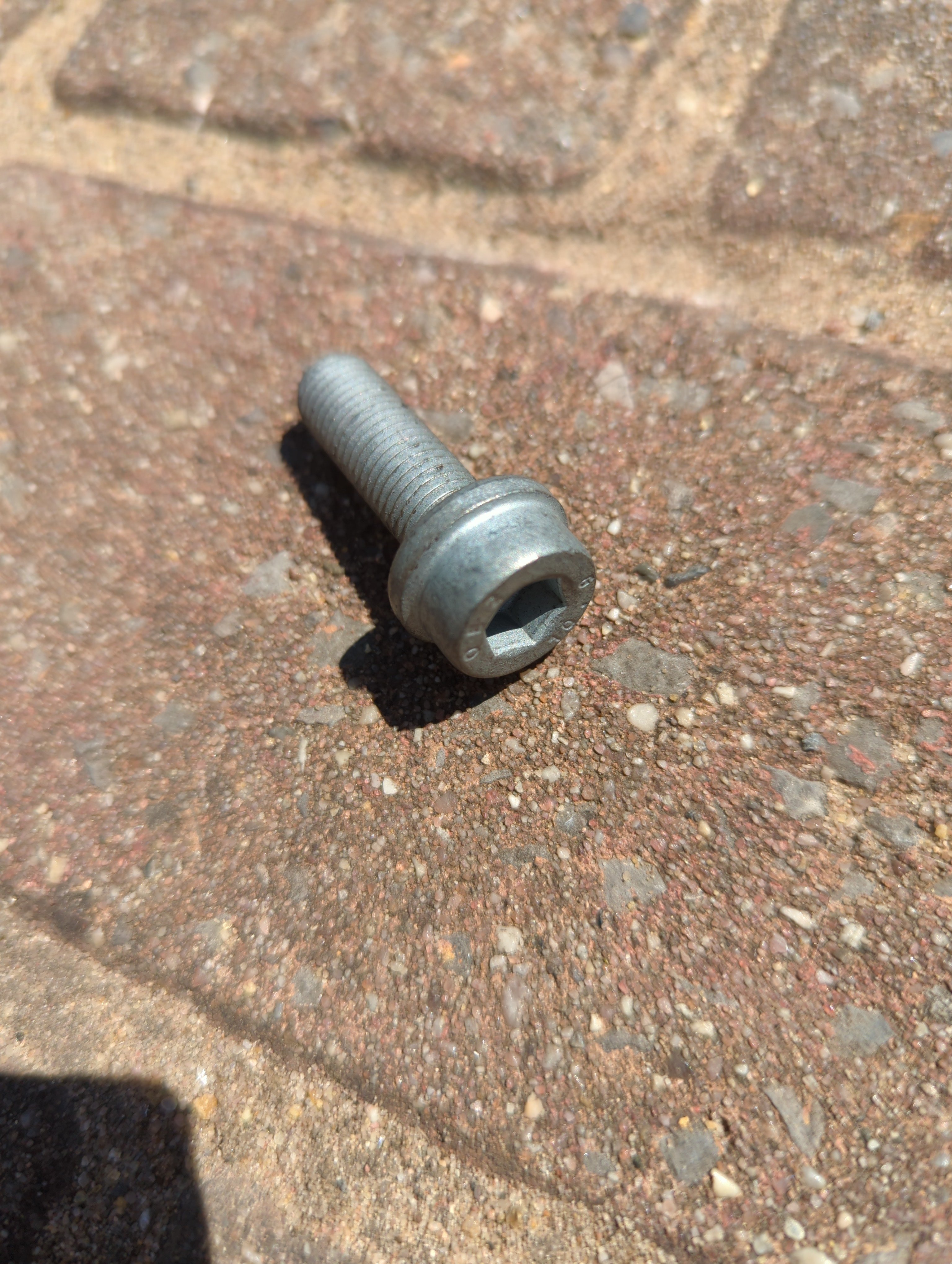

  8. Hi, having a bit of a nightmare. I have tightened bracket to 90nm but there is literally no way I am able to do the 90degrees too. I have used new bolts. Never had this issue before, they just do not budge and the hex is starting to fail. Any ideas?

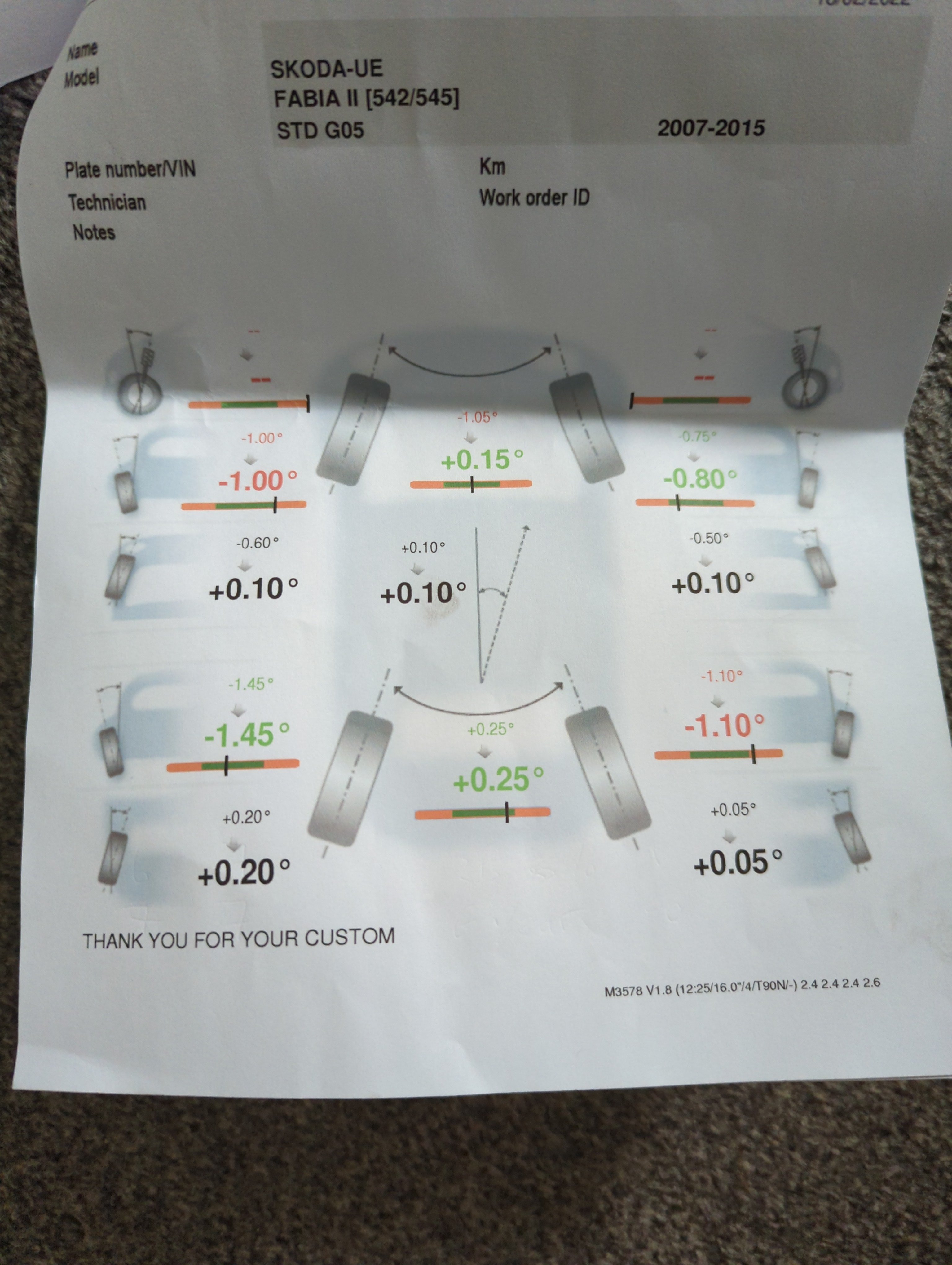

  11. Hi there, sorry forgot to turn on notifications! This is the geometry I ended up with. Not sure it shows the info it needs to though. Just noticed +10 would be 0.10 I assume?
  12. Hi, Just had my MK3 fabia tracked and notice the sheet says MK2. Would this be an issue? Obviously I can go back, but not worth it if the specs are the same. Thanks
