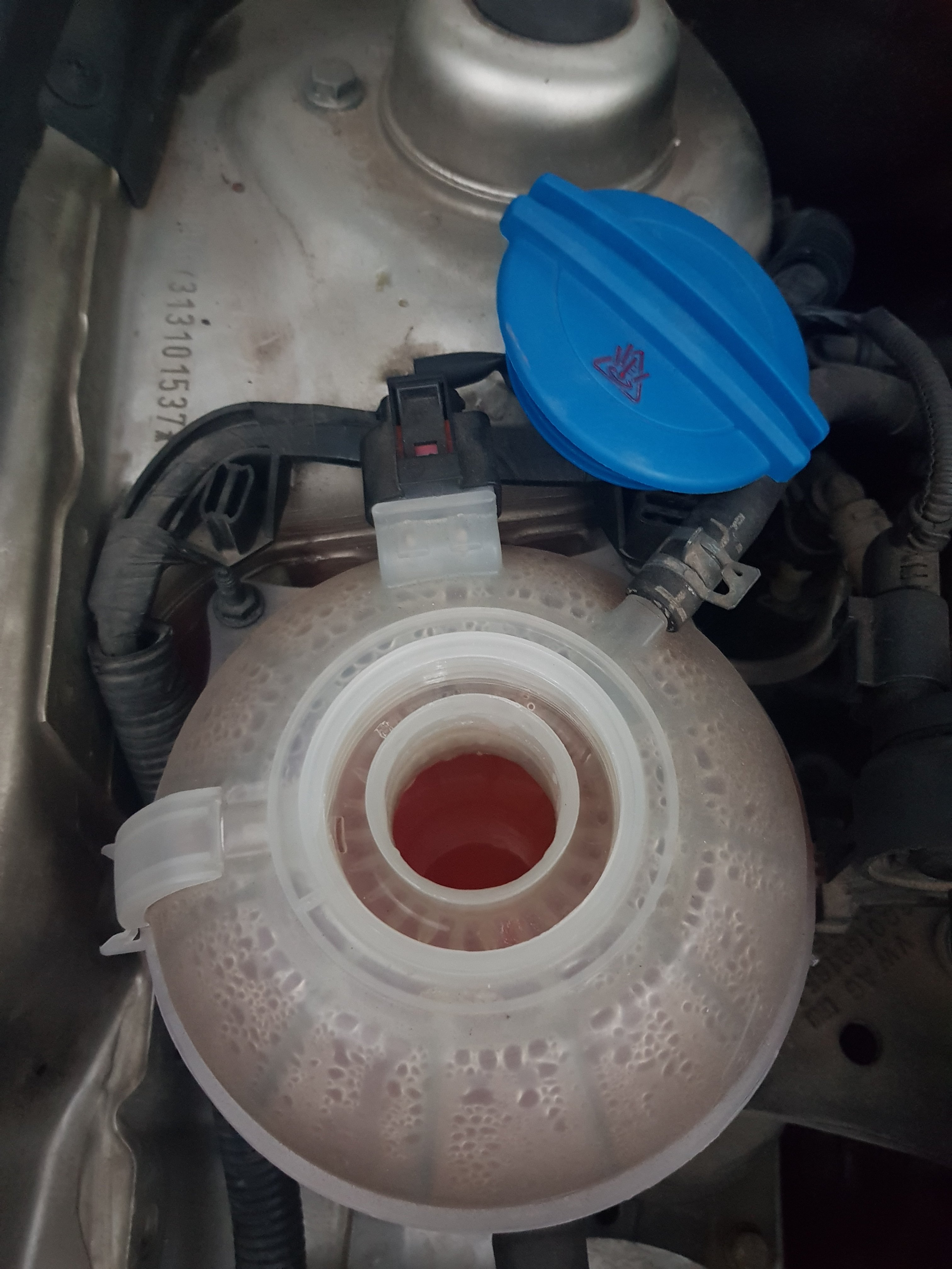

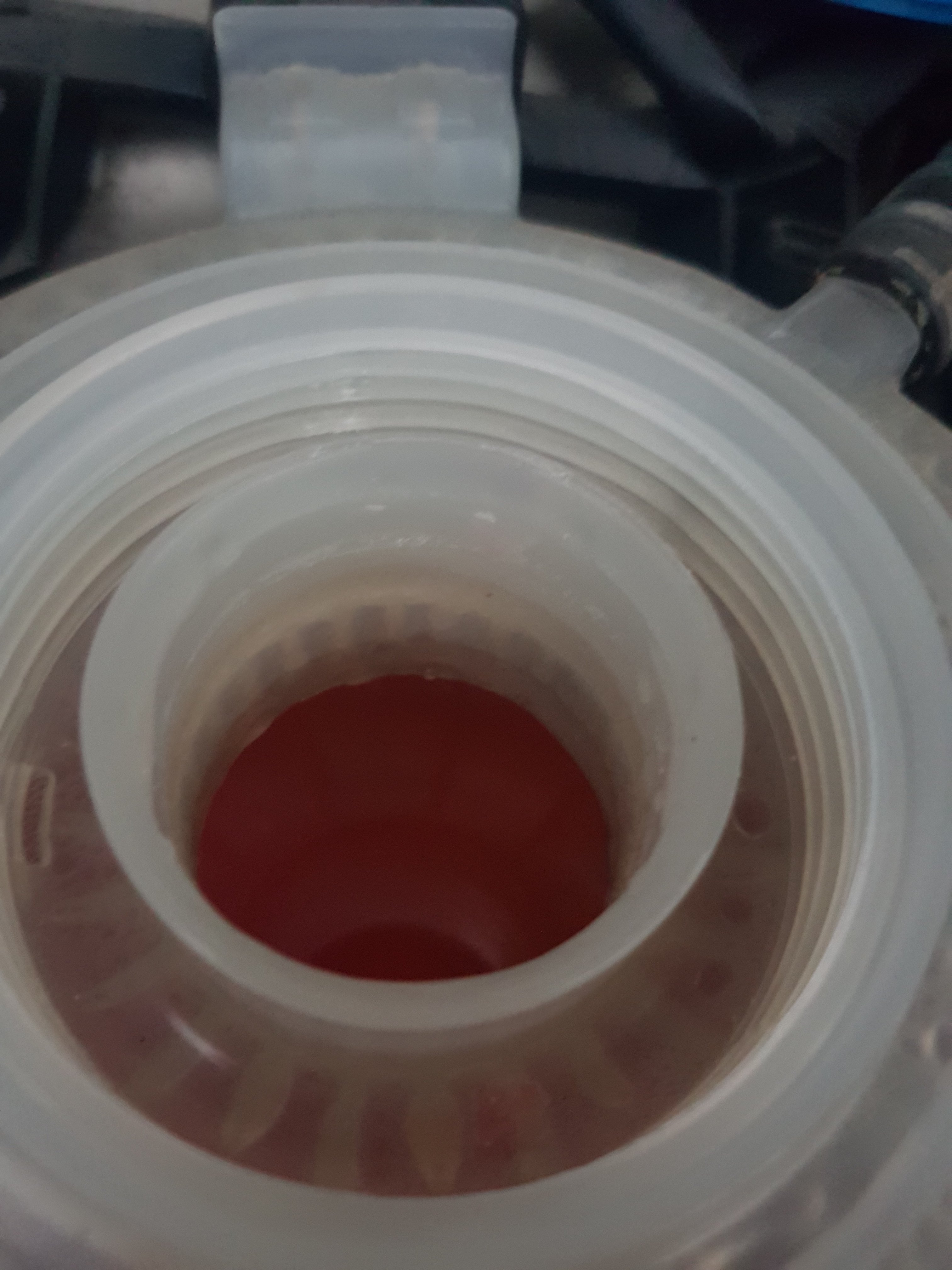

  1. Hi, Apologize for late replay. I opened the expansion tank and looked for 2 metallic prongs descending into the coolant but could not find them. Please find below attached pictures. Do we speak about the same expansion tank? I bought this expansion tank 2 years ago because my old one was very dirty and I could not see the level of coolant. I regret now that I replaced it. I have now nice looking expansion tank which is not working. I still could have dirty but working one. Thanks.
