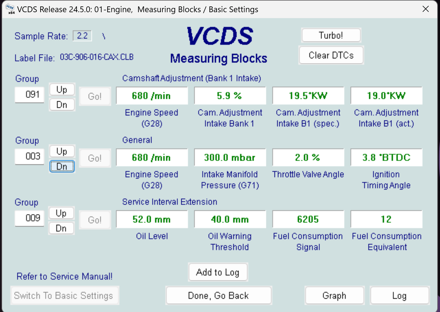

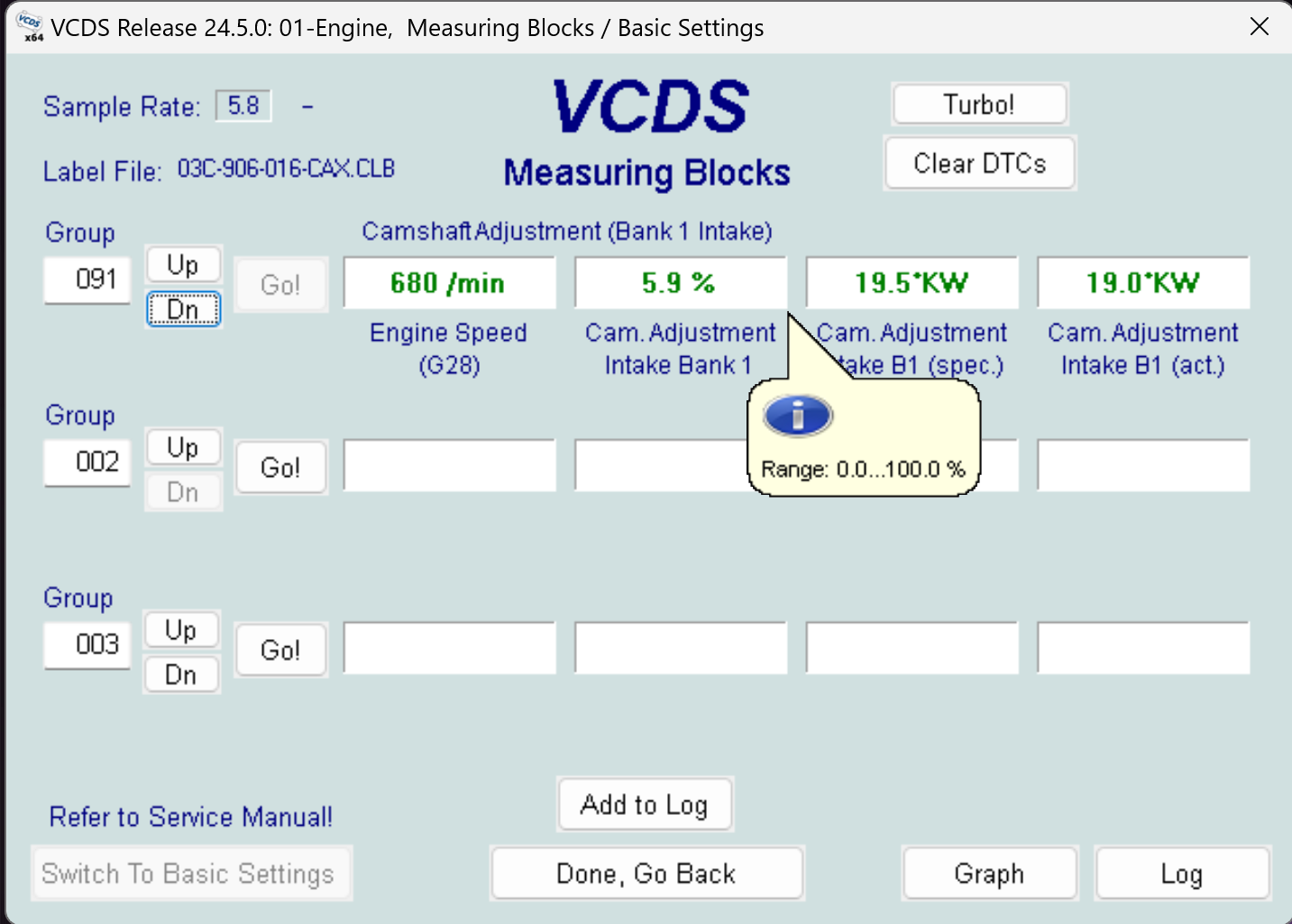

  4. Hi I've got a 12 plate Octavia 1.4 TSI CXCA engine and cant for the life of me work out if i need to get the chain replaced or not. Part of the problem is that because I'm not working (medical issues) I have no commute, therefore I do very little mileage, probably 2K per year because all I do is go to the shops once a week. I do have a legit VCDS cable and using the latest software have tried to get the details that would tell me the amount of slack in the cable. However when i go into measuring blocks I don't see the values everyone quotes. I've even gone through the "groups" but dont see anything. I'm unfamiliar with VCDS if honest and have only ever used it once when I thought I needed to code my hands free kit, turns out I didnt even need it /doh Can anyone tell me what I need to do to see the stretch in the chain? Engine is chain (CAXA) Address 01: Engine (CAX) Labels: 03C-906-016-CAX.clb Part No SW: 03C 906 016 AK HW: 03C 906 016 C Component: MED17.5.5 G 9059 Revision: LCH13--- Serial number: Coding: 0000072 Shop #: WSC 73430 790 00083 VCID: 68DF720B5BF941D6EB-803C VINID: 91D49268206A2530812090C80CAA0DE8E7 No fault code found. Readiness: 0000 0000
  5. Why don't you run the cable as suggested? It's so easy even I managed to do it
