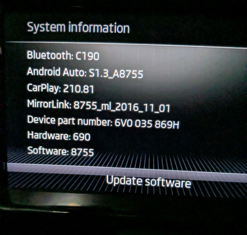

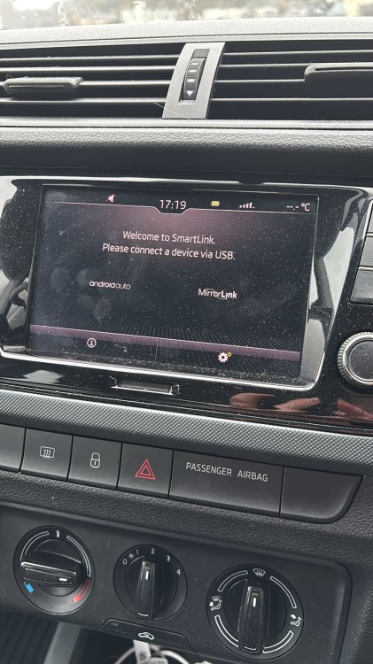

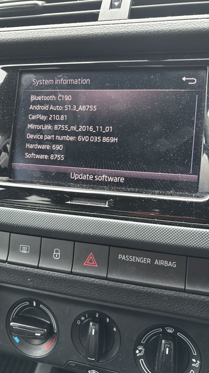

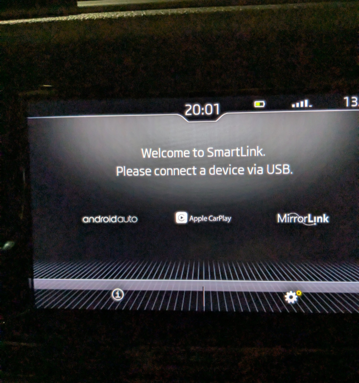

Thankfully resolved by simple Restore Factory Settings. Just an observation, but judging by the number of threads appearing on here relating to infotainment system issues, VAG need to have a critical look at whoever is responsible for software updates and third party integration.

A little help here... Have two Fabia III models in the family: 68 and 19 plates. Identical in all but colour - so you'd think. The 68 plate has for some reason dropped Apple Carplay completely, yet a check on the system info shows it remains identical to the 19 plate, which still has Carplay. Any ideas?
