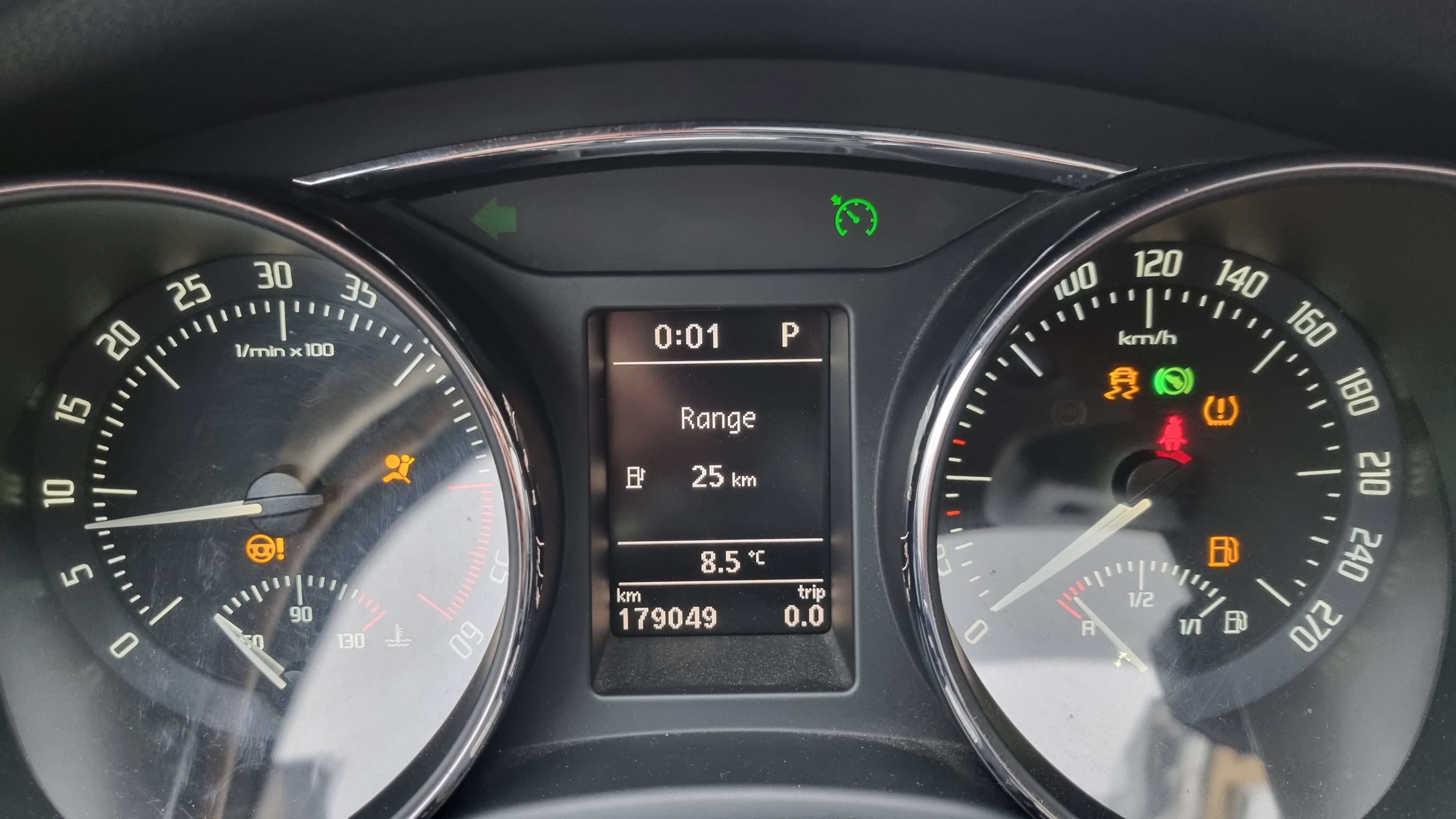

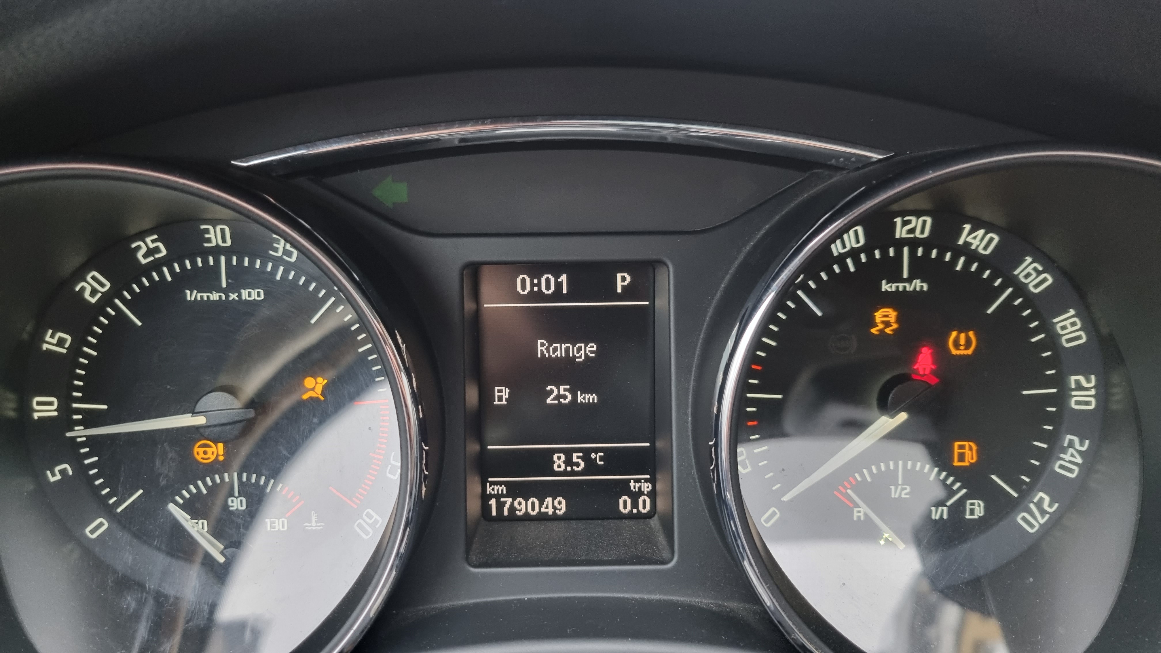

  2. Ok, here it is. Not sure why alarm horn is on the list, never had issues with it. I'll check it. other errors I had from a start (car is about 15 months with me) so as the issue I reported. Log--179040km-111250mi.txt Also cleared all errors so on dash nothing is lit anymore
  3. Sorry I write like this but I'm on mobile in my car so writing all I can see or remember. I will try it but dash seems fine. I replaced the white LED on the dash because some died and it looked bad. No change since than. Just backlight lights normally now. Can't find schematics (i had 5500 pages electrical manual but lost it). Will scan and try. Not sure if my version can do this but. looks like not dash related.
  4. The thing I noticed is that when I press the brake the cruise goes off. At that point I hear a relay near the shift knob (it's dsg so I reckon it's a shift lock relay because the car is stationary). Bad ground on brake switch or those relays? dash connectror seems fine, pretty sure no signal from cruise or turn light goes directly to dash.
  5. Sorry, the xmass tree is because I removed the steering and it's still removed but just turned on the car (airbag, steering sensor and all). No other lights are on or errors on vcds (forgot to mention that I have one). Just the darn left turn light and cruise.
  6. Hey guy, I have a weird thing going on, probably a bad ground but I need a hint. I have very dimm left turn signal and cruise control always lit uo on my dash. The cruise however dissapears when I press brake (also the green brake depress light). I removed the steering wheel, light switch, digged a little in the relays but no go. Any advice ( yes the water did come in down the left A pillar because it has damn panoramic sunroof. Al hoses are uncloged now.
